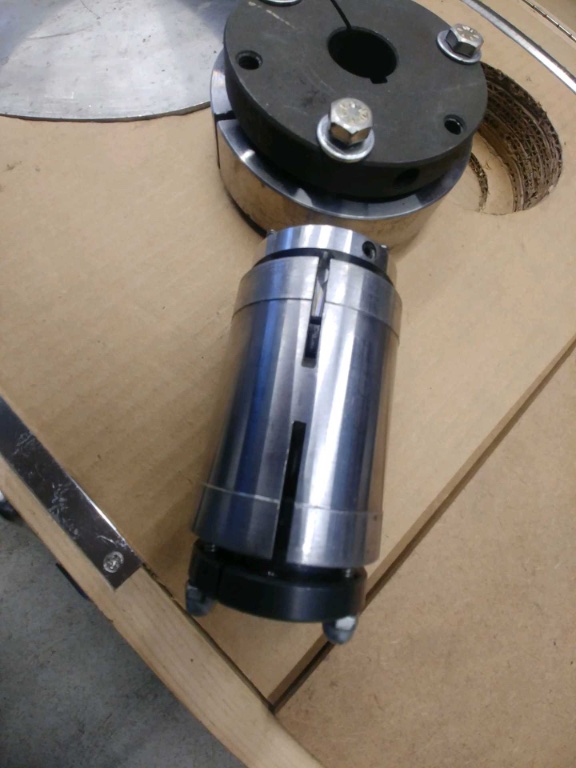

Re: Ruckstell Housing
My rear axle alignment tools
I was considering doing as Alan suggested, but after seeing the beautiful alignment jig that Les uses, I decided to just go ahead a spend the million to get a new one from Chaffins, ready to install. I will be selling the housing that I have. Someone could probably send it out to Chaffins and have a left side stub installed. I didn't want to wait that long.
