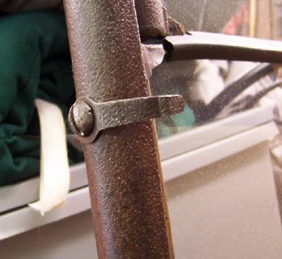

Be aware that the hooks on the windshield posts are different sizes, the upper ones are long and curved, the lower ones are shorter and straighter. The vendors carry the short one, but the long ones are harder to find.
Short hook: https://www.modeltford.com/item/7831B.aspx
Picture of the long hook:
- Attachments
- 867300.jpg (37.25 KiB) Viewed 3730 times

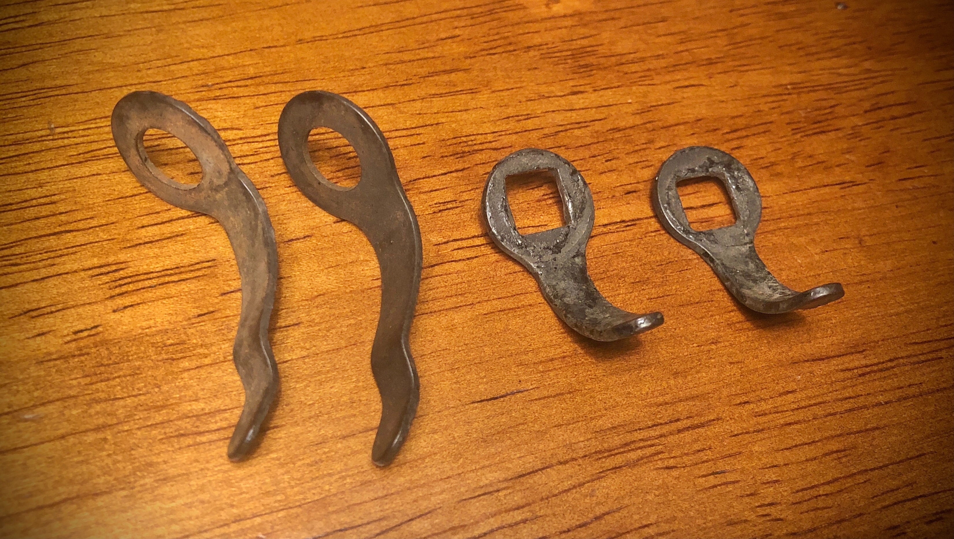

These are the front side curtain clips I have. One set has a circular mounting hole ... the others gave a square mounting hole. From what gather from the links Mark posted the square hole version with the shorter hook must go on the oil lamp bolt that also goes through the windshield mounting bracket. So the longer ones with the double curve and the circular mounting hole must share the same machine screw that secured the bottom windshield bracket.

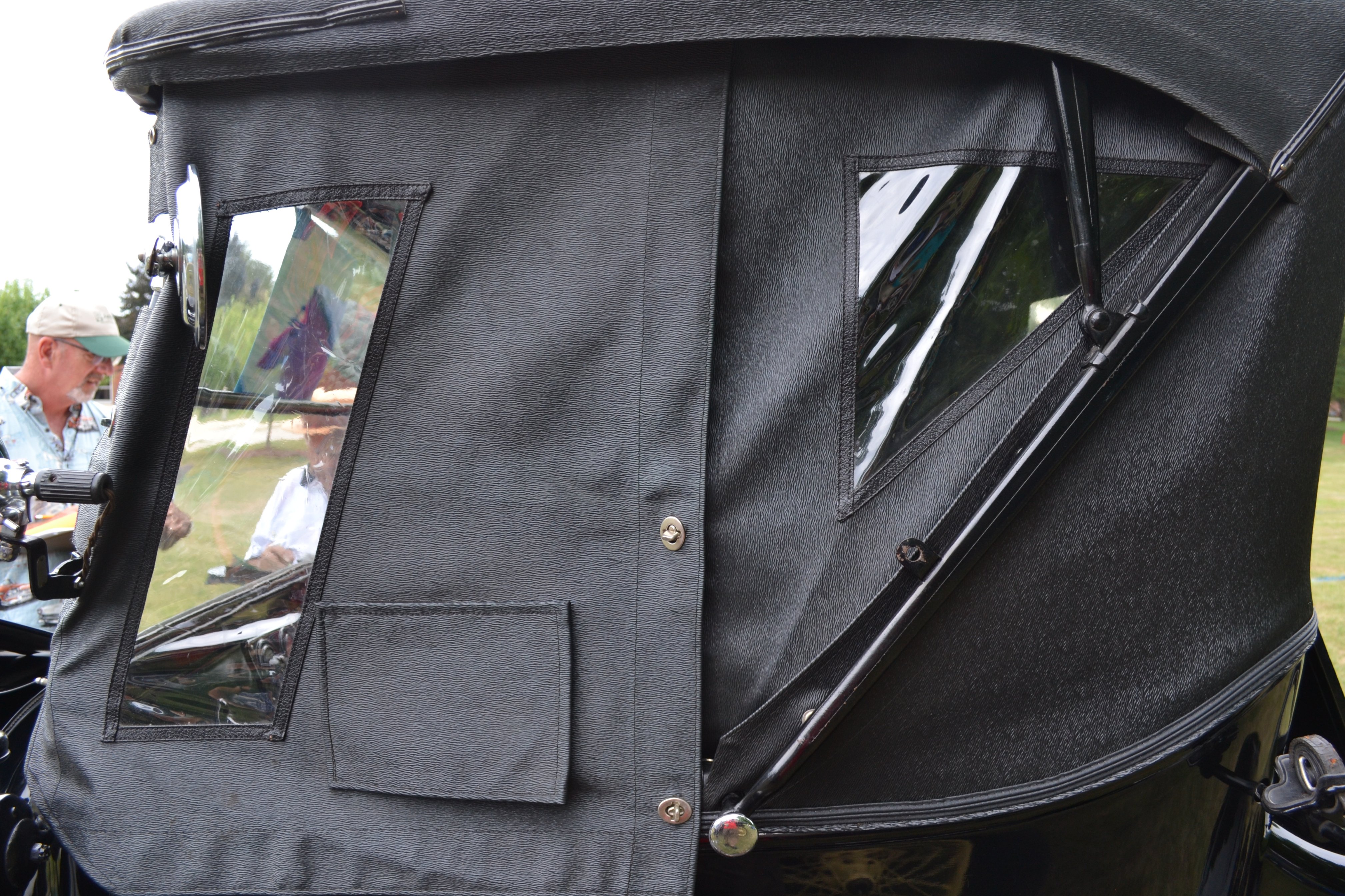

Here is another earlier thread that shows how I fastened my side curtains. I had them custom made by Classtique to fit around my spare tire carrier and side mirror. They also have much larger than stock clear panels for enhanced visibility.
http://www.mtfca.com/discus/messages/41 ... 1396461073
My curtains have wild deviations from factory stock and therefore should not be used as a reference for a museum or Stynoski award level restoration.
Larry Smith has invested a lot of personal time and effort determining what is factory correct, so your best bet is to do a Google search for "roadster side curtains original smith mtfca" and read through all of the old threads that pop up.
If this response is still not helpful or explicit enough, I beg your forgiveness.

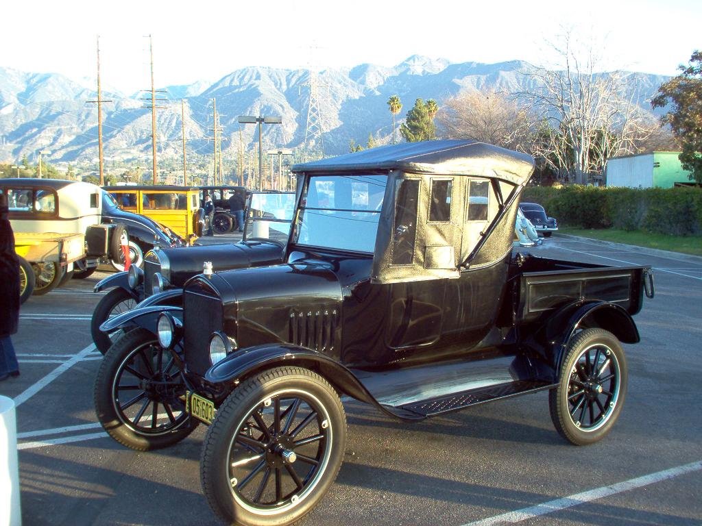

Yes, I have seen you comment about this before in earlier threads. Also seen the pictures of your roadster pickup with the side curtains installed though never seen any detail shots of that which would be very interesting.
Since my T has side lights would I still install the smaller flat hook on the front bolt that passes through the lamp bracket and the windshield bracket? Or was there a variant way to attach the front curtain in that spot?

Mark: Tim Morsher is offering free correct lower side curtain hooks for your car. The ones you have pictured are not correct.

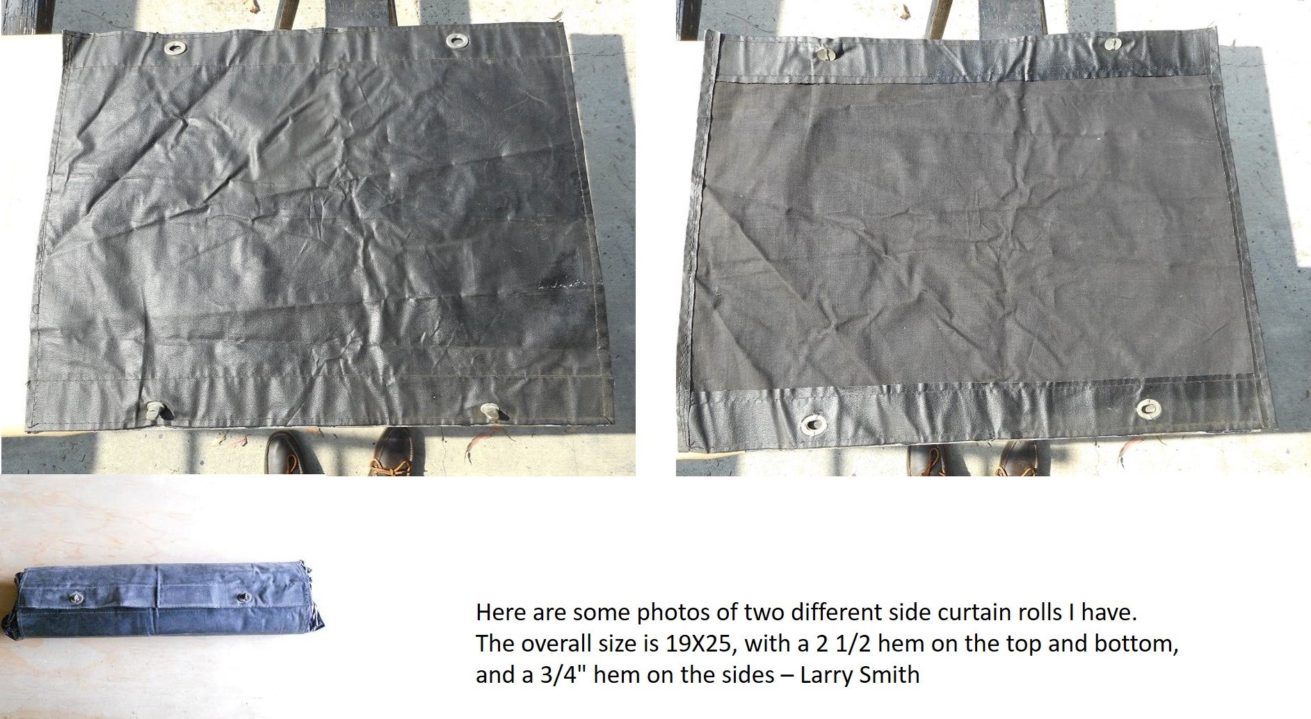

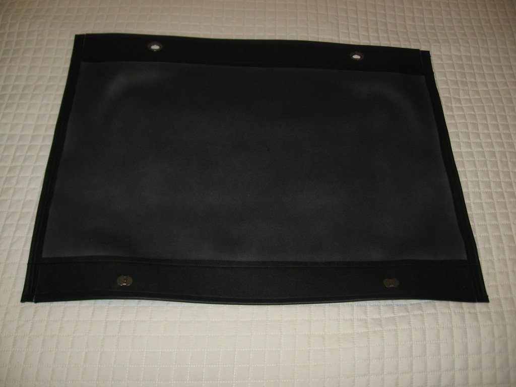

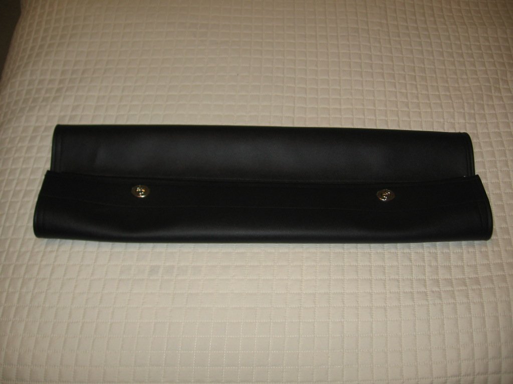

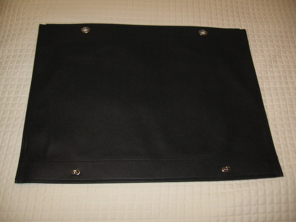

By the way, the bag that the vendors sell to store the side curtains when they aren't being used isn't correct either. Here is an older thread about the configuration of the current vendor roll versus an original Ford curtain roll:
http://www.mtfca.com/discus/messages/82 ... 1526061917
Larry Smith sent me the dimensions of his original roll and I made a copy for myself using some vinyl top material and my 1948 Singer sewing machine.
