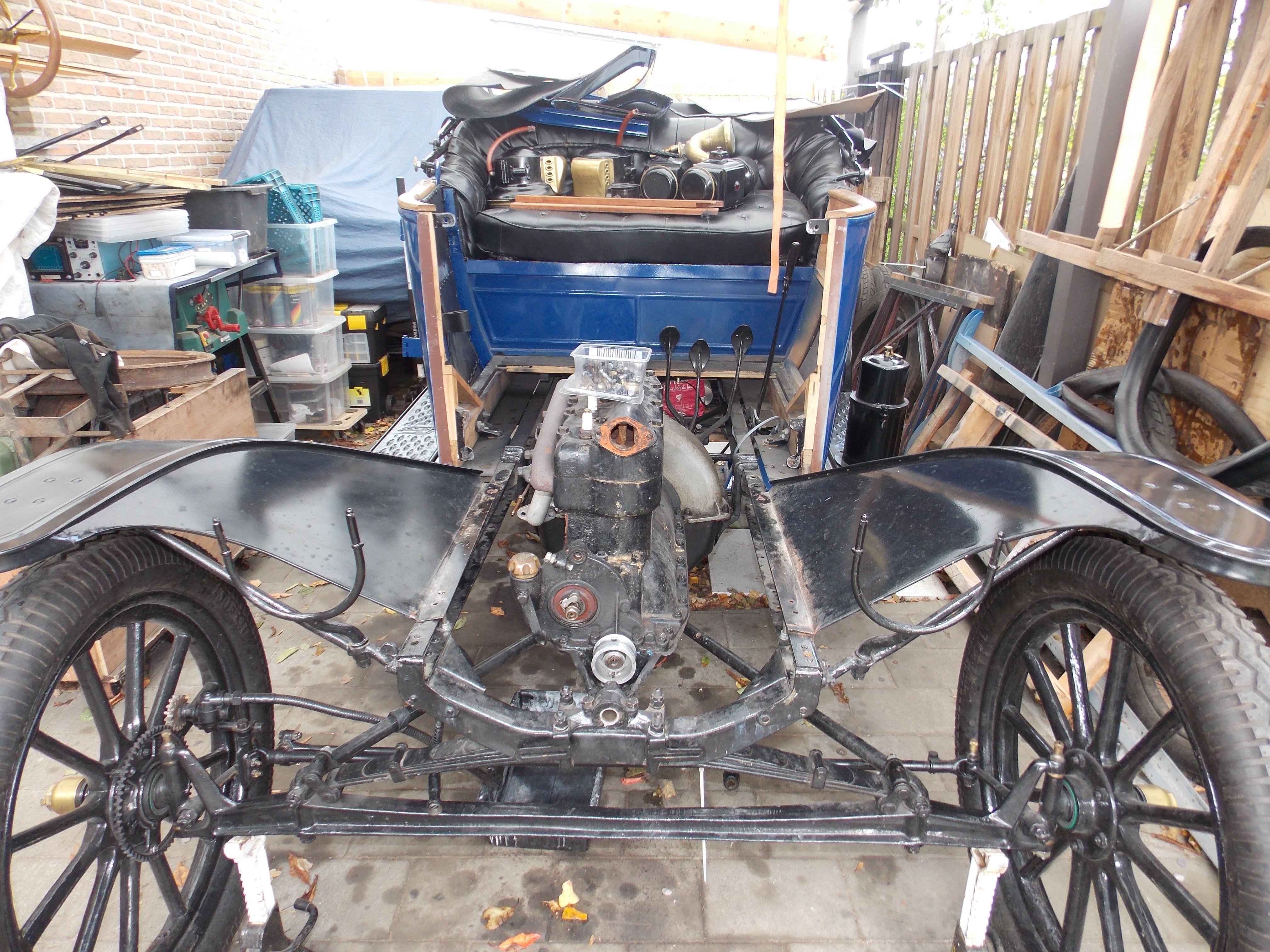

I just took the firewall out on the 1915 and did the same on the 1913.
Andre
Belgium

Andre...how coincidental! I did the same too on my 15 and 13. I did forget to mention in my previous post that while I didn't take the '15s firewall completely off, I just slid it up a few inches, but still had to perform a little body surgery to get the pan ears out. IT wasn't all that bad, nothing showed when I was done.
But man the '13 and my '12 for that matter, was a whole lot easier without that big wood firewall in the way! An easy, almost horizontal pull out/drop in!!

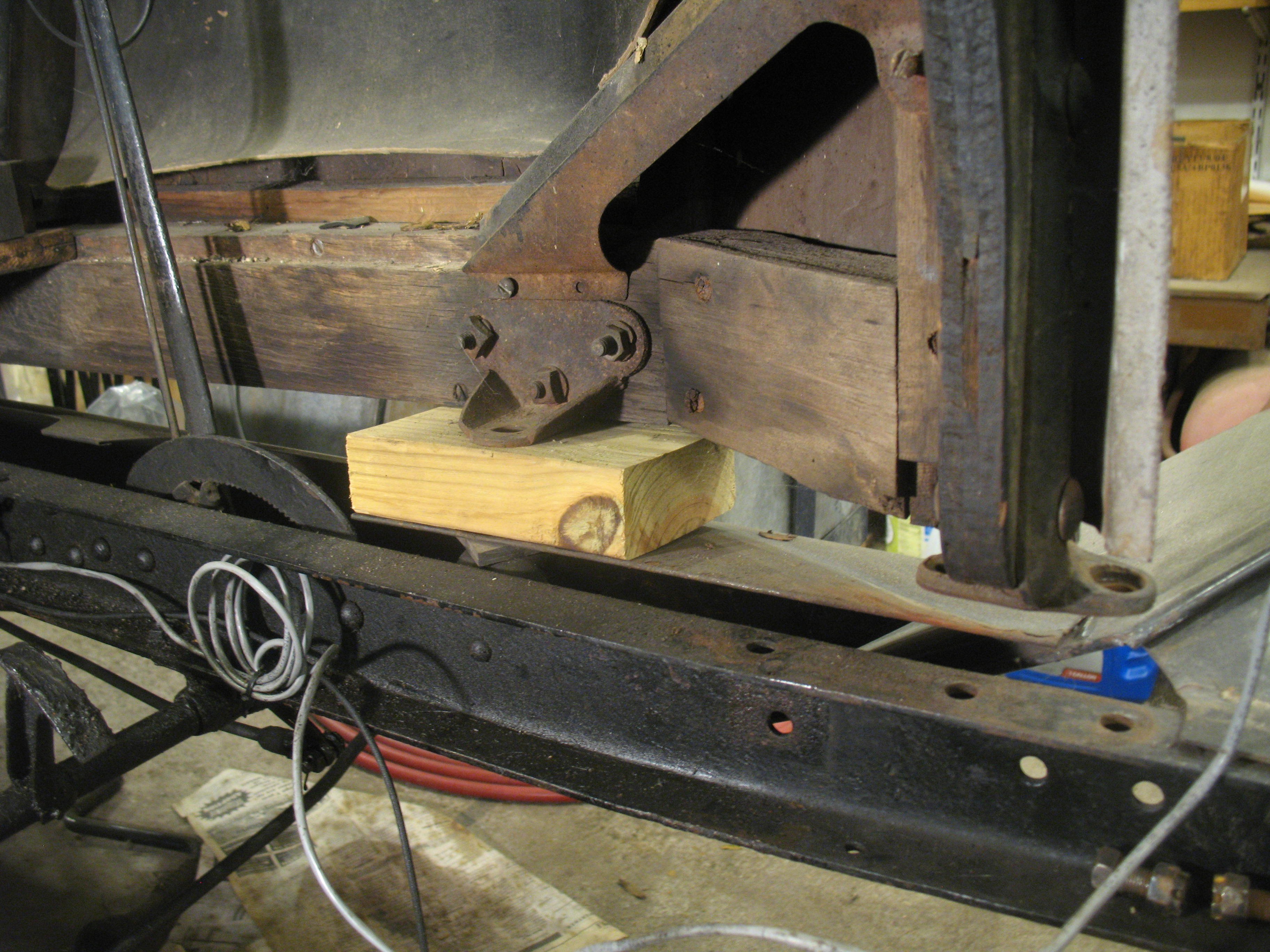

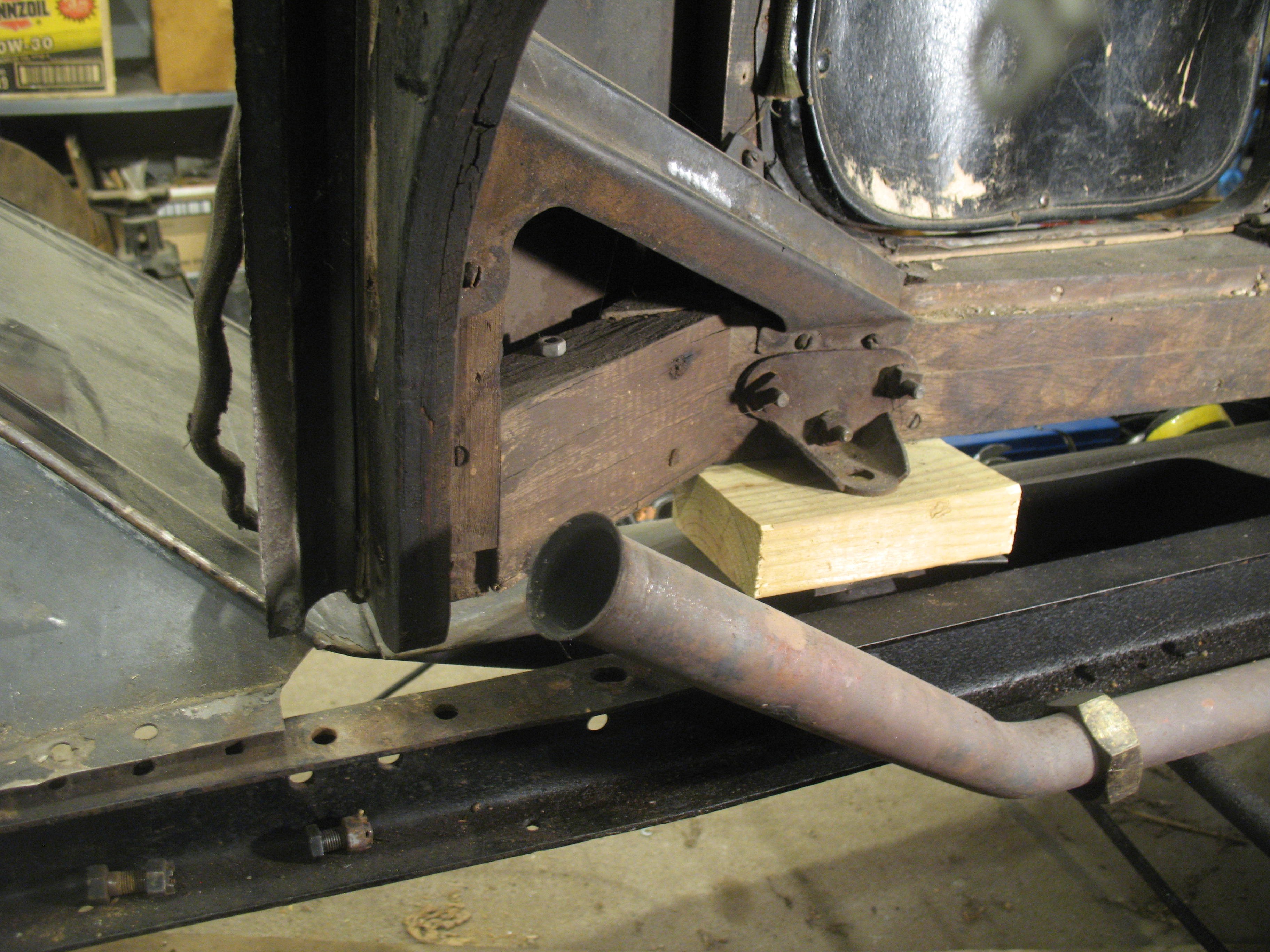

Neal is correct. You don't have to remove the firewall or attack it with a Sawzall. Just undo the brackets from the frame, remove the front four body bolts, loosen the rear two, and put the front of the body on 2 x 4 blocks. I've done this several times, and I've never broken anything. I don't see anything to break.
