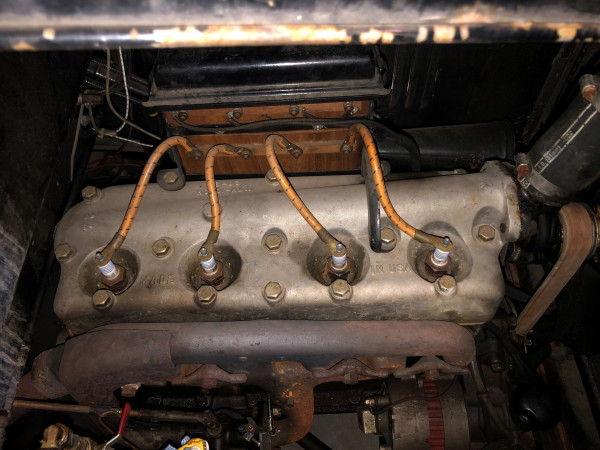

I recently purchased a 1926 T Coupe and the head appears to be aluminum. The only markings I have been able to see are “VTH-1000H” and “20-27”. Could anyone tell me anything about this head?
I’m working through the Coupe a little at a time. She starts and drives well. I plan to change the motor oil this weekend and to top off the antifreeze. Perhaps I should change the coolant also.
I haven’t been able to locate the 600 wt. locally. Does anyone have any suggestions where I should order it or perhaps a different name for the same thing?

Sorry, no help on the head, a picture might help.

Accessory aluminum head would be a "hi-compression", if you want to call it that - about 5.5/6 to 1 comp. ratio - does increase pulling power especially in a closed car.
- Posts: 4414
Re: Unknown Cylinder Head and Lubrication Questions
You have a high compression head of modern manufacture. I think the one you've got is referred to as a "Reeder" head, as made by Ralph Reeder. Not totally sure however. The other option is a "Z" head. It would have a "Z" cast in the top, just behind the water outlet flange. Either one is excellent!

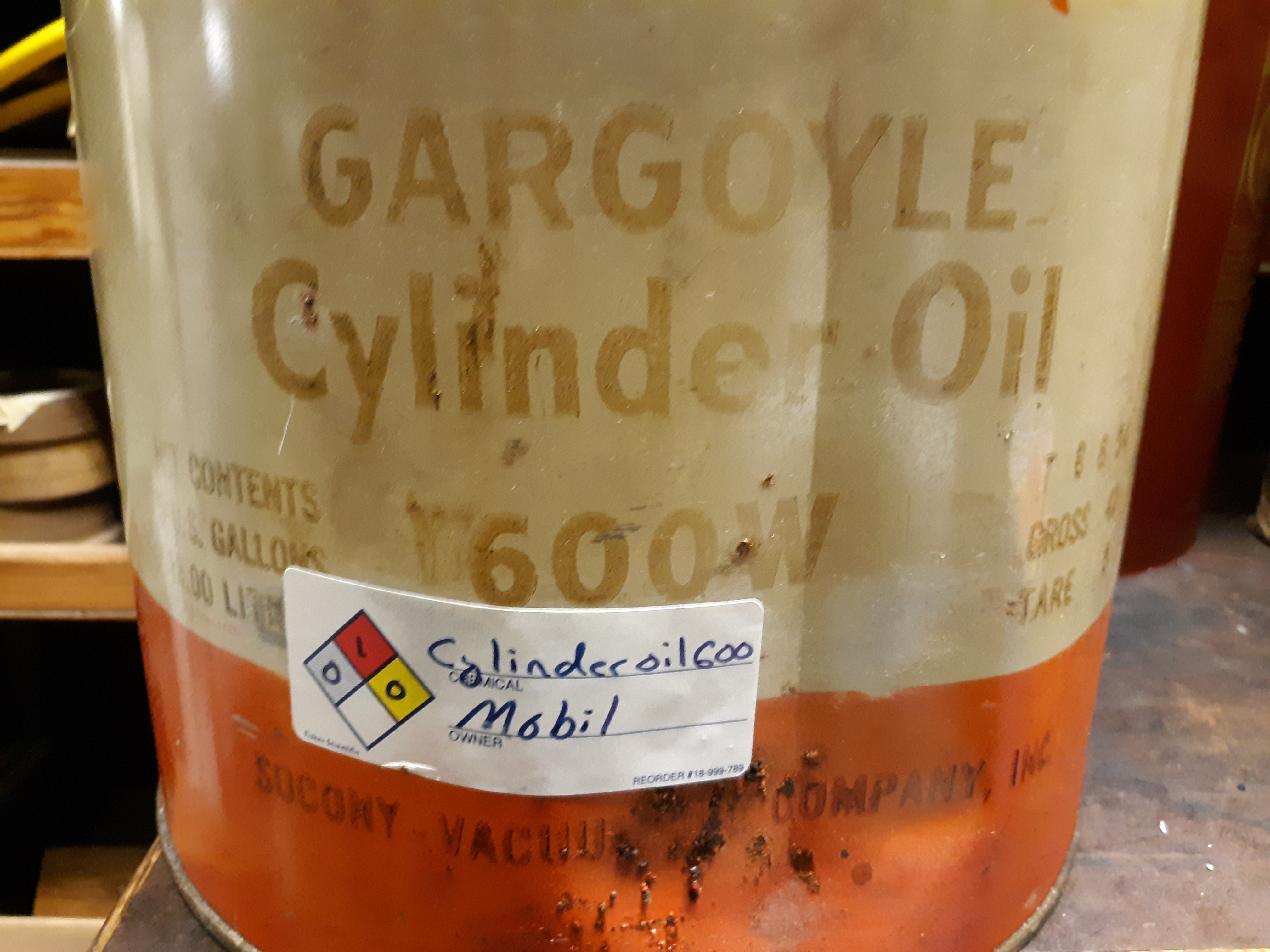

600wt is horrible stuff, but if you insist, it is Steam Chest Oil. Its what they had back then. It was injected into steam to lube inside the cylinders.
- Posts: 4414
I've had same actual 600W, (a.k.a. #2 Steam Cylinder Oil). It's very thick and pours very slowly. I have also had some of the "600W" sold by the T suppliers. I kinda doubt it's actually 600W. I think it's more like 140 gear lube. Just my take on it.

Not a Z head, and doesn't look like any Reeder head. My hunch is VTH are the initials of the maker.

I have seen them before, had heard Reeder got in trouble for casting with FORD name on them so he went to this style?

Correct. 600W is black. The stuff Lang's sells is hypoid.Jerry VanOoteghem wrote: ↑Sat Nov 21, 2020 2:12 pm

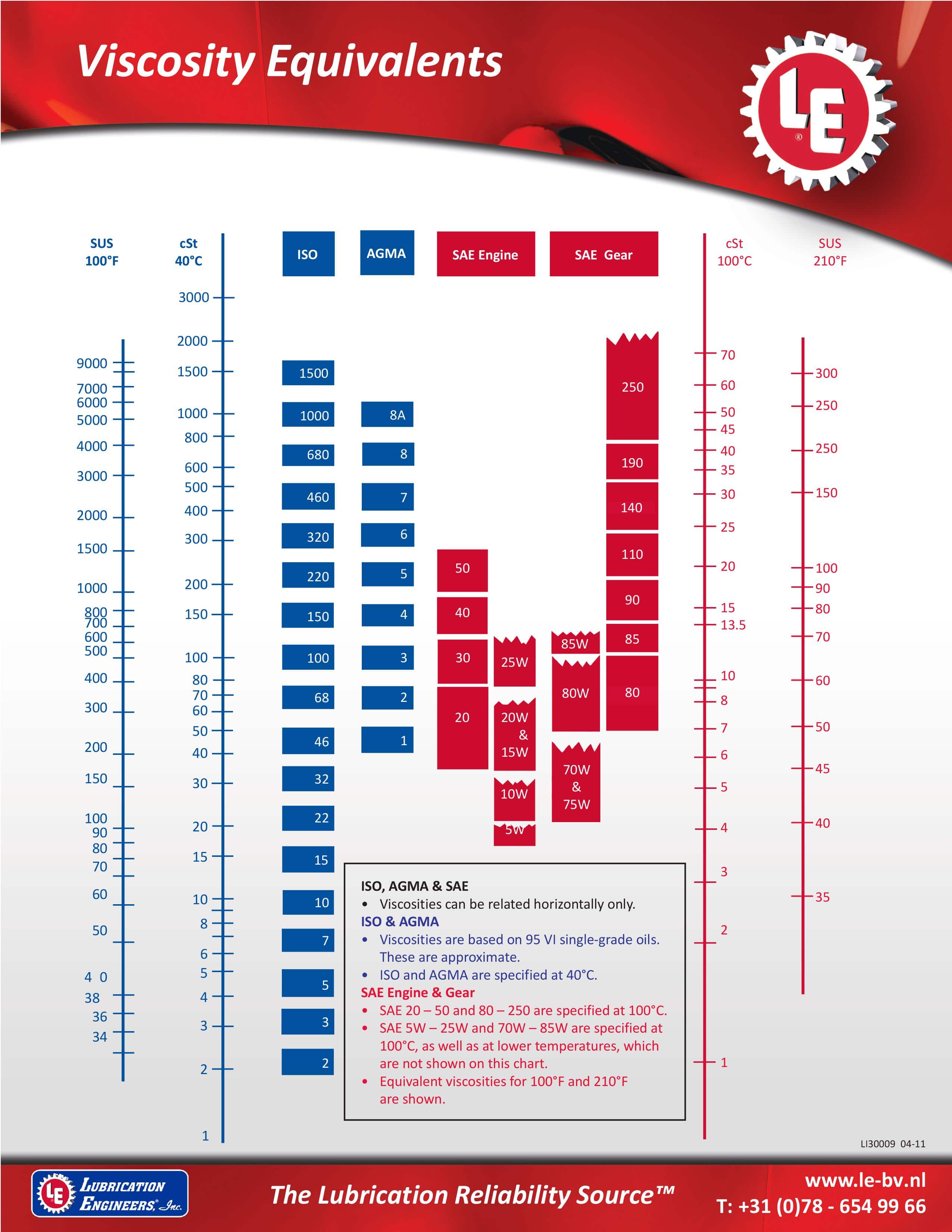

I found a paper in the interweb that gives a nice comparison between the different ways the viscosity of oils are given, remember there are different ways of rating the oil for different uses, as in gearcases, engines etc.
The 600w is a industrial gearcase oil rating, which compares to a 140w to 160w gearbox oil, as can be seen in the list.
Hope this helps clear up some of the confusion about the ratings

That is a great chart... thanks for posting it! (I'd heard 600W was viscosity-wise 275, where it looks more like 150...) I know firsthand you can order (through jobbers) whatever lube you want (as long as they make it and is in 55 gallon drum batches) - we used to do that on the bridges, I'm just not sure how long it would take to go through a 55 gallon drum of oil one pumpkin at a time.

https://petroleumservicecompany.com/mob ... llon-pail/
Comparing that SAE chart to what Henry used is like looking up nutritional facts for Coca Cola, and seeing corn syrup instead of cocaine.
The original 600wt was black tar like stuff, that you had to warm up to pour, and contained raw canola oil as well. Think of old machinery like mining equipment with open gear boxes covered in black grease. That is what they had.
Using 90 wt -140 wt oil, like GL-3 or 4 that is compatable with brass is fine. No need to buy at a specialty store.

Just some extra clarification on the chart i posted, the only thing that it compares is viscosity, other characteristics of the oil is not taken in consideration i.e. the 'stickyness' of the oil or the capacity to absorb moisture or protect against corrosion.
Another important feature of the oil in a T or TT rearend is the compatability with the bronze parts in there !
The use of cylinder oil for instance may have drawbacks : although it may be of the right viscosity, cylinder oil is intended as a total loss oil, it does not have to survive long use, so might have a short service life in your pumpkin.
The chart only gives you an idea how to compare between older and/or modern ways to classify oil viscosity.
A modern gearcase oil of around 145w may do well in your rearend if the 600w is not available but be sure to check for its compatability wth bronze..

He filled us in on the history of the 600wt oil, it's use, its old and new composition, and really it's intended use, as people wanted to know.
Bottom line, he said he would never recommend it's use in The T rear end, as there was now far better lubricants to use.
Years later, I hosted two friends from the Netherlands, big Corvette guys, and I found they were petrochemical engineers with Royal Dutch Shell.
They explained to me why straight 30 or 40 wt oil is superior to multi grade oil. That would be another great thread.

Old thread,
But was the head ever identified?
- Posts: 1966
- Last Name: Tannehill
- Location: Hot Coffee, MS
- Board Member Since: 2002

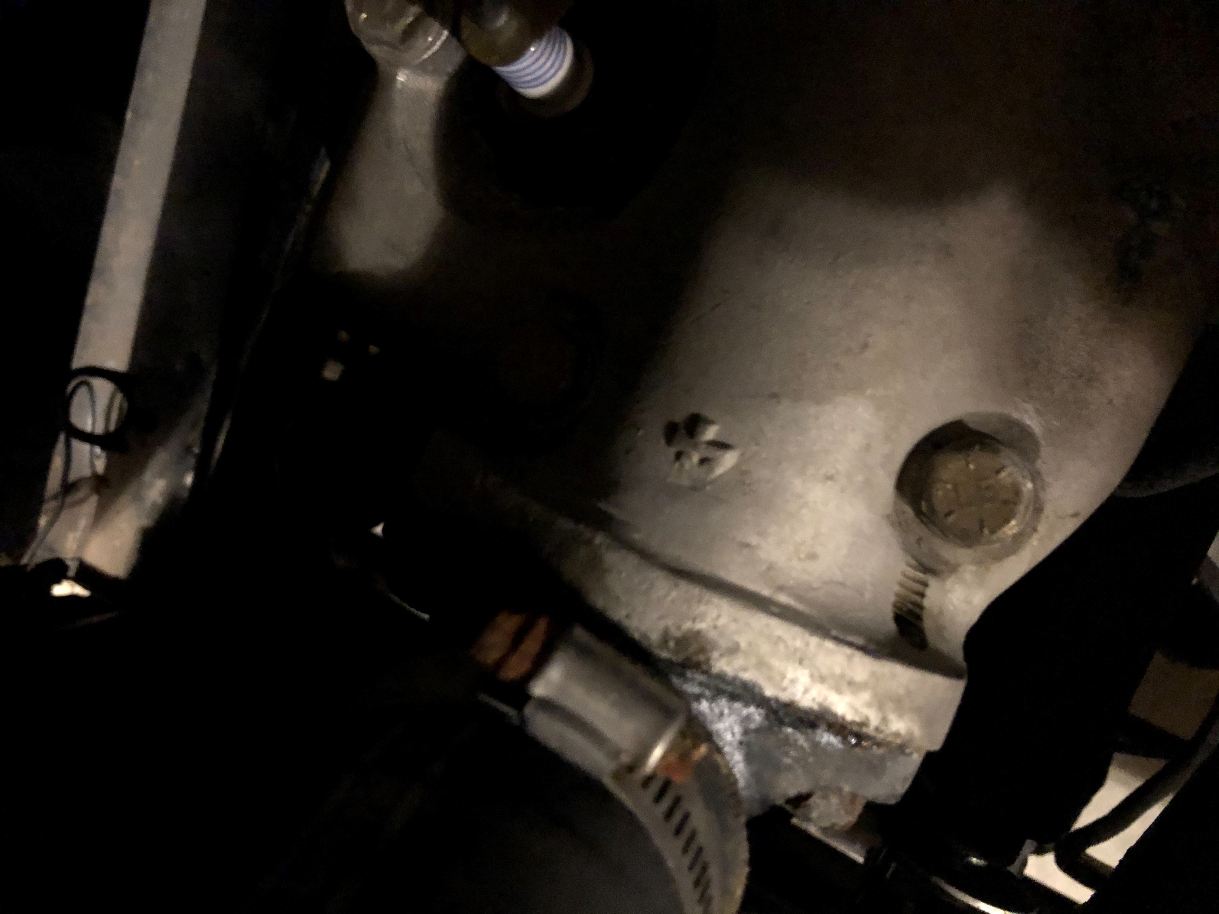

Early Reeder Head, look inside the water outlet, head turned over Reeder will be cast in the head

Just FYI, I've been running 600 steam cylinder oil for about 20 years in the rear end and auxilliary transmissions. I buy it in the 5 gallon tub from Western States Oil co. They don't sell it in smaller containers. going way back, I always used 140 and I had a Muncie transmission that consumed a lot a lot of oil so I called Western States Oil in San Leandro, CA. to see if I could get bulk 140, and the guy asked "what is it for?" When I finished telling him, he said 90 and 140 are not good for bronze bushings, it eats into them. You need 600 steam cylinder oil and it doesn't hurt bronze, we sell it in 5 gallon tubs. My previous association with 600 was what I ordered from one of our T parts suppliers and yes it poured like molasses and seeing that I refused to use it as I thought "that stuff is way too thick, it'll never lubricate well enough and get in all the nooks and crannies, especially at the speeds and distances that we travel today." I mentioned that to the Western States guy and he assured me the the 600 steam cylinder oil that they sell is not like molasses. He was right. That was 20+ years ago and it has served me well. and I no longer see traces of bronze in my Tranny or rear end "grease"/oil.
Ed aka #4

Reeder is the only one to make a high compression low head that I have found.
The only difference is the height and number on the lower rear left side.
