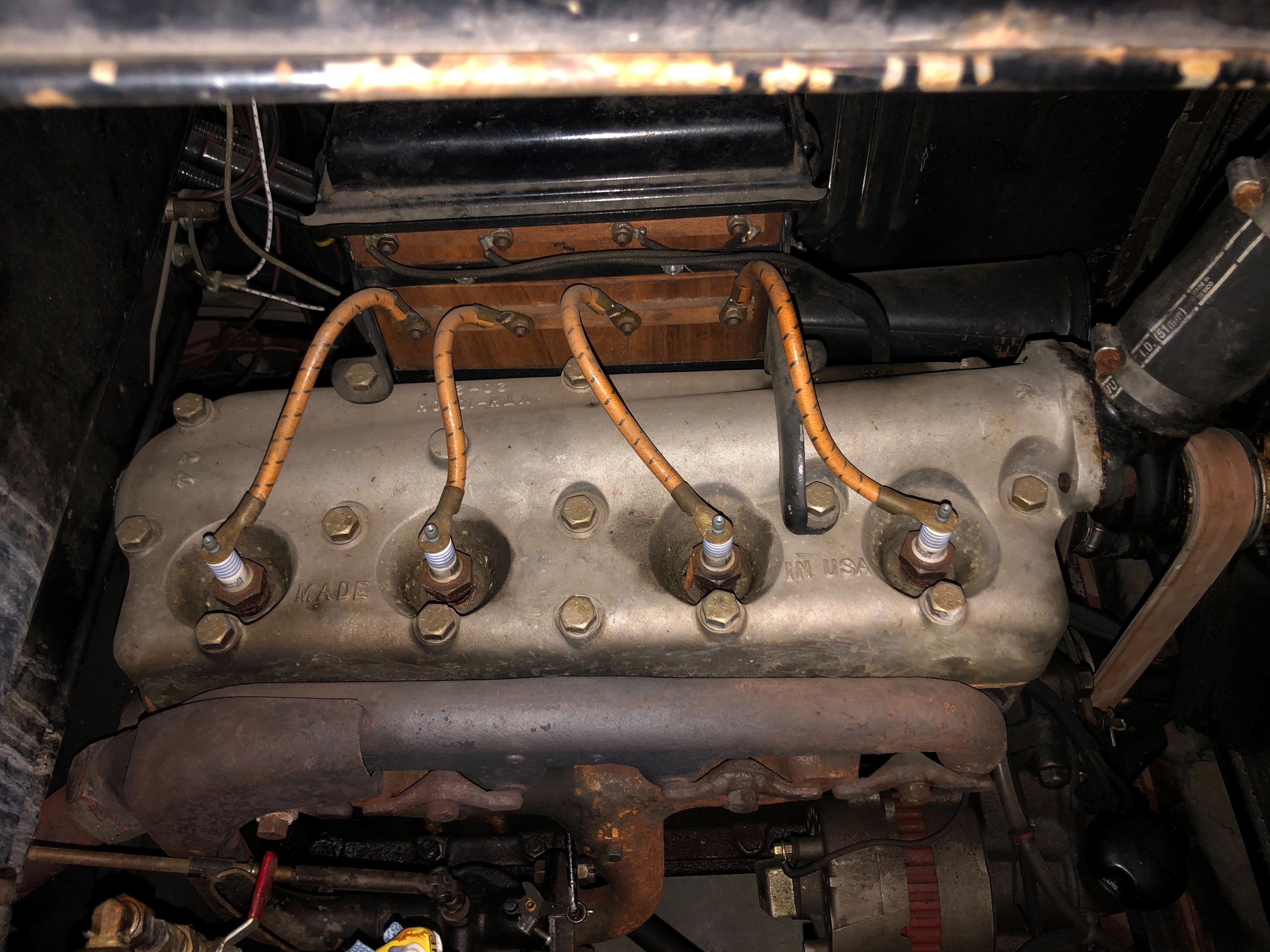

Walber, As you suggested I have added two photos and there are more marking on the head that of which I was not aware.
If my photos changes anything, please do let me know. I appreciate everyone's help.

Not a Z head, and doesn't look like any Reeder head. My hunch is VTH are the initials of the maker.

I have seen them before, had heard Reeder got in trouble for casting with FORD name on them so he went to this style?

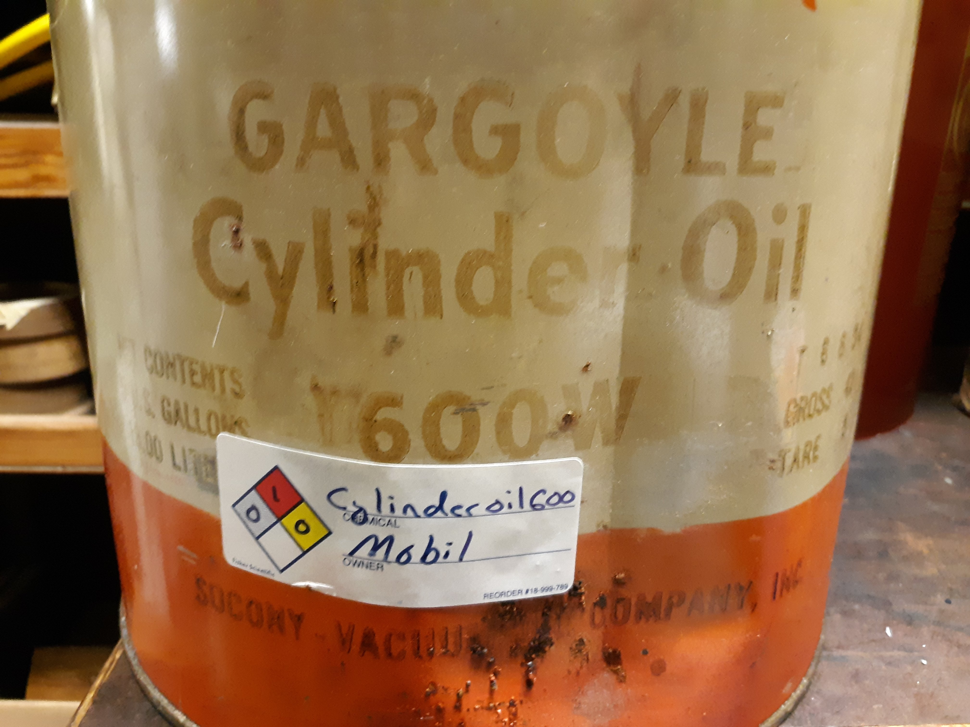

here is the real 600w. philip

Yup. Closer to roof mastic than oil. :lol:

Another important feature of the oil in a T or TT rearend is the compatability with the bronze parts in there !
The use of cylinder oil for instance may have drawbacks : although it may be of the right viscosity, cylinder oil is intended as a total loss oil, it does not have to survive long use, so might have a short service life in your pumpkin.
The chart only gives you an idea how to compare between older and/or modern ways to classify oil viscosity.
A modern gearcase oil of around 145w may do well in your rearend if the 600w is not available but be sure to check for its compatability wth bronze..
But to be sure, the wrong oil is always preferable to no oil :D

Maybe 40 years ago I was at Glen Chaffin's shop discussing this very thing. A customer walked in, overheard us, and introduced himself as a petrochemical engineer at Standard Oil.
He filled us in on the history of the 600wt oil, it's use, its old and new composition, and really it's intended use, as people wanted to know.
Bottom line, he said he would never recommend it's use in The T rear end, as there was now far better lubricants to use.
Years later, I hosted two friends from the Netherlands, big Corvette guys, and I found they were petrochemical engineers with Royal Dutch Shell.
They explained to me why straight 30 or 40 wt oil is superior to multi grade oil. That would be another great thread.

Early Reeder Head, look inside the water outlet, head turned over Reeder will be cast in the head

Just FYI, I've been running 600 steam cylinder oil for about 20 years in the rear end and auxilliary transmissions. I buy it in the 5 gallon tub from Western States Oil co. They don't sell it in smaller containers. going way back, I always used 140 and I had a Muncie transmission that consumed a lot a lot of oil so I called Western States Oil in San Leandro, CA. to see if I could get bulk 140, and the guy asked "what is it for?" When I finished telling him, he said 90 and 140 are not good for bronze bushings, it eats into them. You need 600 steam cylinder oil and it doesn't hurt bronze, we sell it in 5 gallon tubs. My previous association with 600 was what I ordered from one of our T parts suppliers and yes it poured like molasses and seeing that I refused to use it as I thought "that stuff is way too thick, it'll never lubricate well enough and get in all the nooks and crannies, especially at the speeds and distances that we travel today." I mentioned that to the Western States guy and he assured me the the 600 steam cylinder oil that they sell is not like molasses. He was right. That was 20+ years ago and it has served me well. and I no longer see traces of bronze in my Tranny or rear end "grease"/oil.

Reeder is the only one to make a high compression low head that I have found.
The only difference is the height and number on the lower rear left side.
