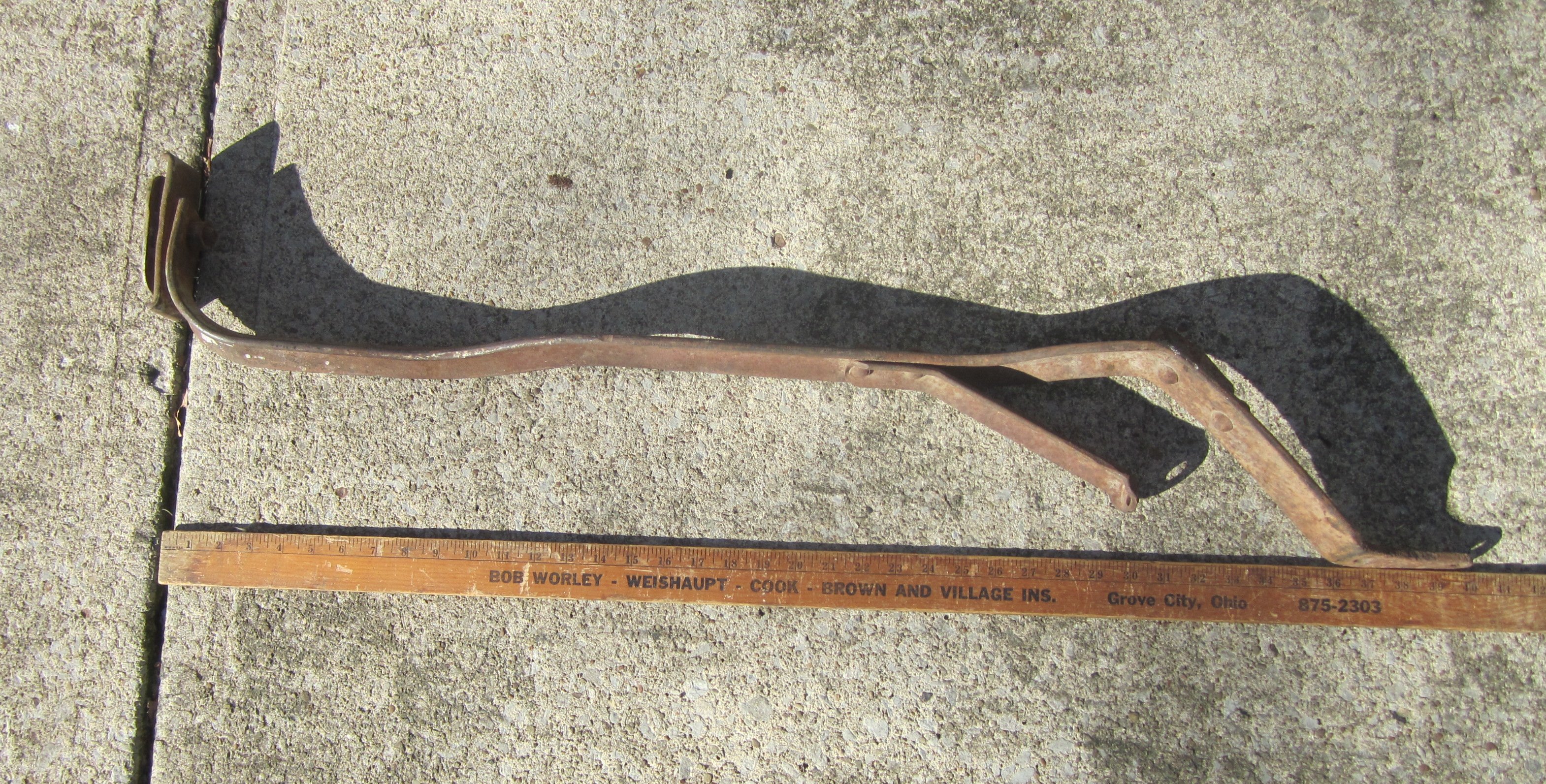

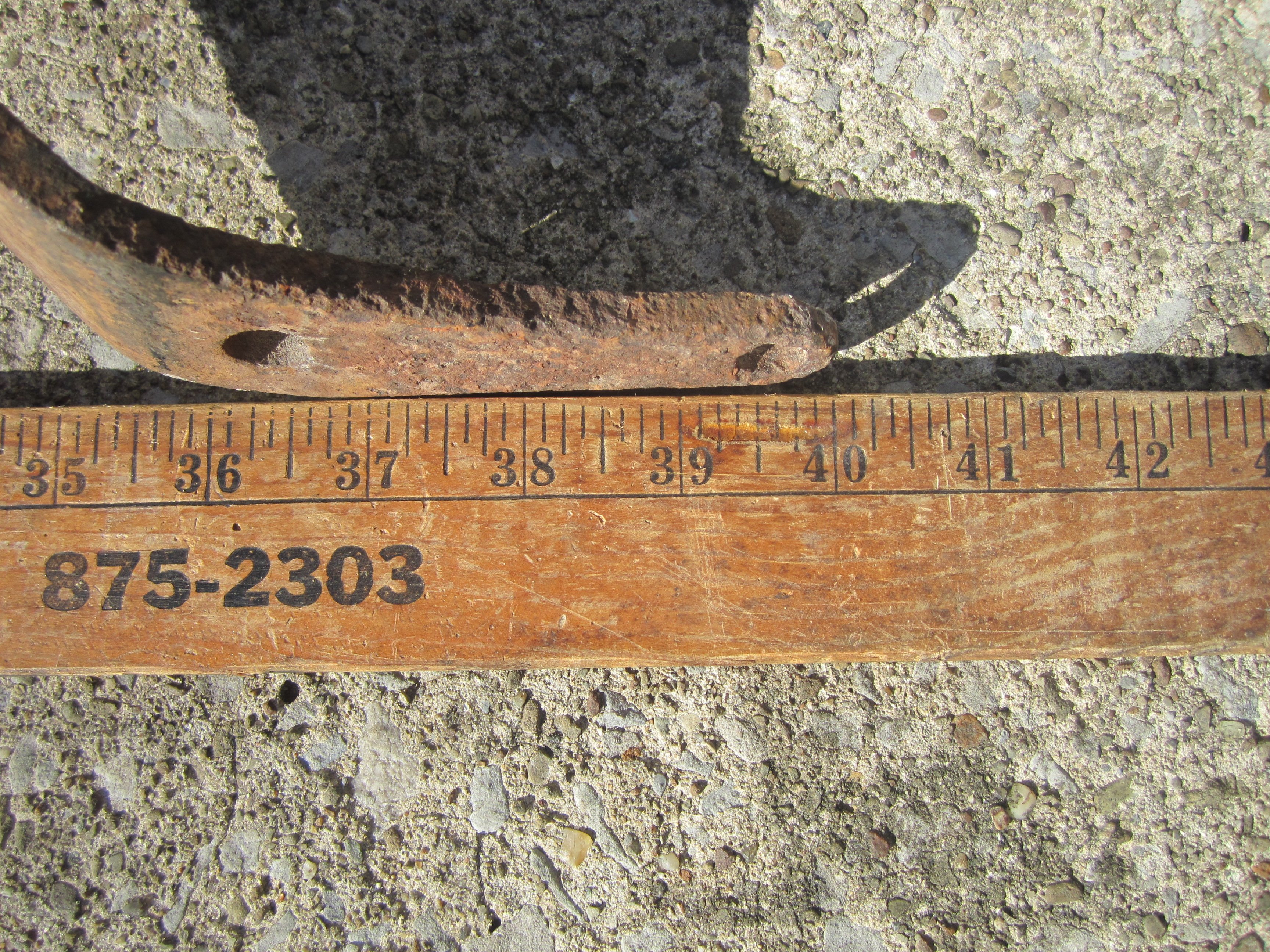

What is the correct overall length of the rear bumper bracket for the 26/27 Fordor? Pictures show what I currently have. Thanks.

Sorry, you have the coupe/roadster bracket. The sedan/touring bracket is shorter. The dimension shown to the first hole should be 32" for the sedan, 36 3/8" for the coupe. Coupe/roadster is longer to clear the spare tire that is angled in vs. the sedan spare tire that is angled out. Dimensions came from the original Ford drawings factory part number T3134-R at the Benson Ford Research Center.

Thanks, I suspected as much, I can still use the "longer" bracket on the Fordor with out any issues other than the bumper will stick out further. It is my understanding that the new "replacement" brackets are the longer version to be used universally. Of course if someone needs the longer brackets and have the shorter ones instead I'd be interested in a swap.

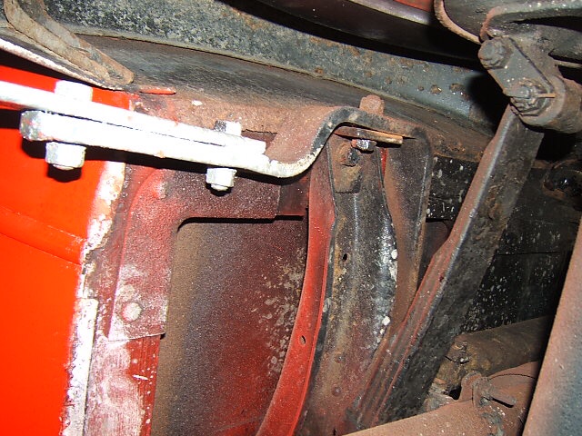

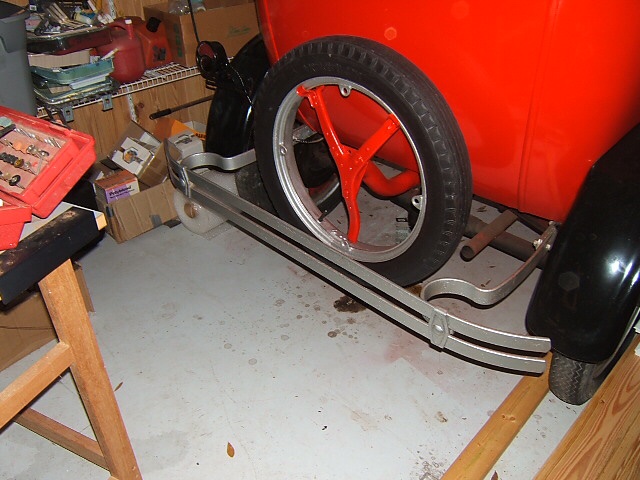

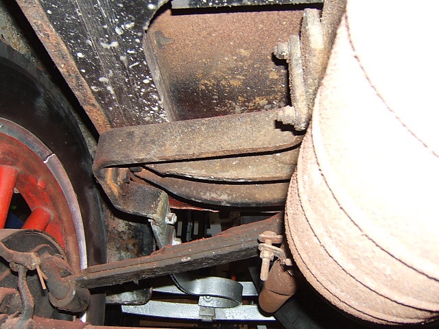

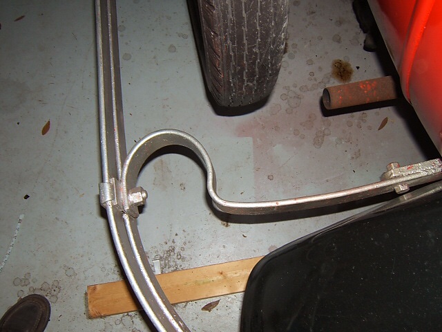

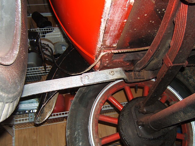

Here are five (5) photos of the bumper brackets on my ‘26 Fordor, some taken from underneath. Jim Patrick
Dropacent
Posts: 3384
Last Name: Morsher
Location: Norwalk Ohio
Re: Rear Bumper Bracket OL for 26/27 Fordor?
Post by Dropacent » Sun Nov 29, 2020 7:27 pm
Those are not Ford issued bumpers. They are some aftermarket brand.
