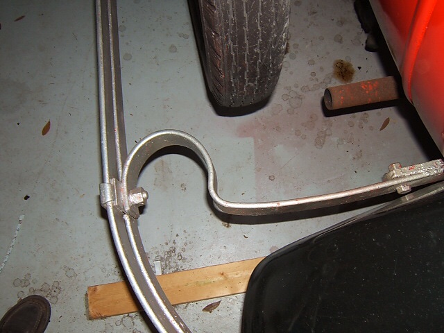

Here are five (5) photos of the bumper brackets on my ‘26 Fordor, some taken from underneath. Jim Patrick

Re: Rear Bumper Bracket OL for 26/27 Fordor?
Those are not Ford issued bumpers. They are some aftermarket brand.
