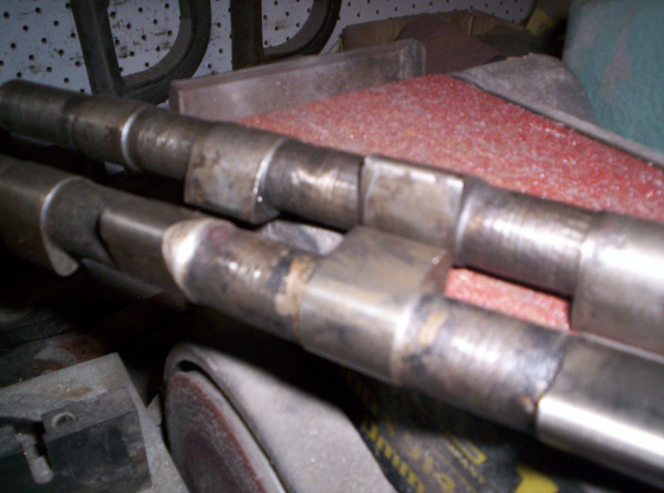

I’ve done a couple of them. No problem with the lifters.
I’ve done BIG aggressive cam grinds. Had to file notches in the front and center cam bearing bores (2 in the front and 1 in the centre)
Removed the rear cam bearing.
I actually have one in process right now.

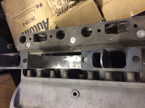

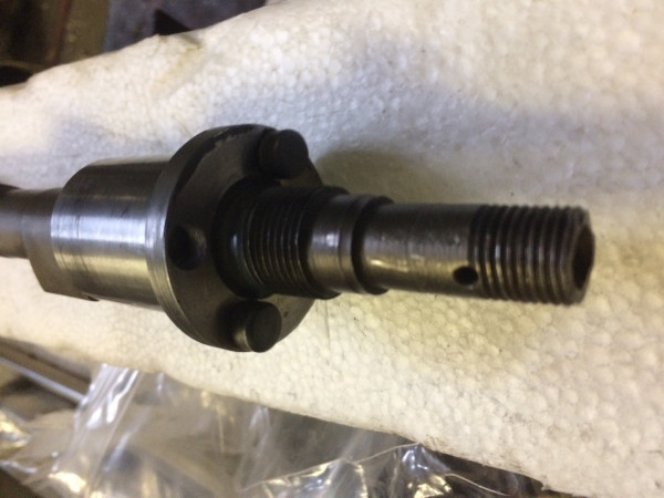

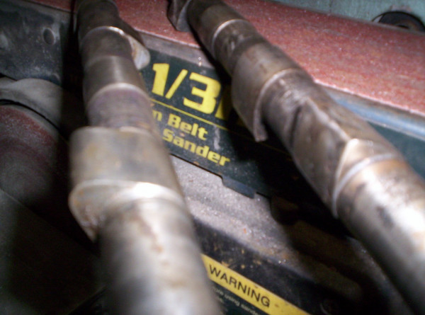

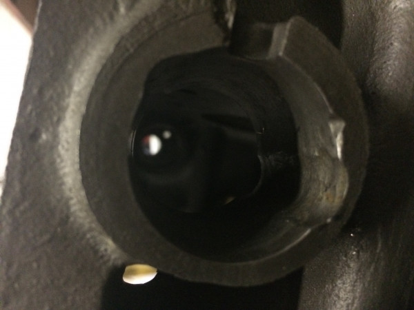

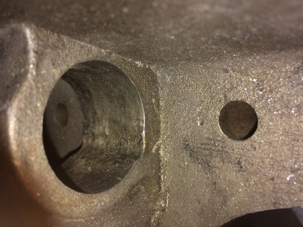

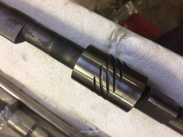

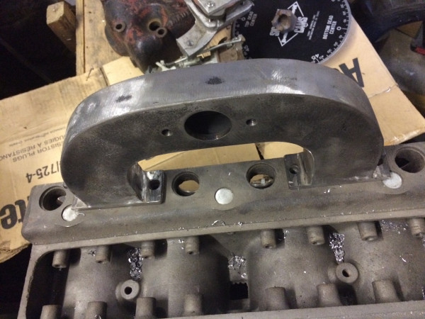

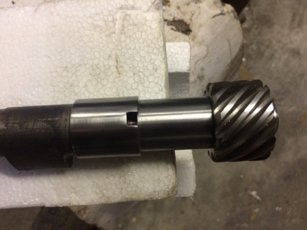

I hope these pictures help
Cam gear;
Several options. As pictured the front of a T cam has been added to the A cam. The first time I did this I refitted the T gear to the front of the A cam
