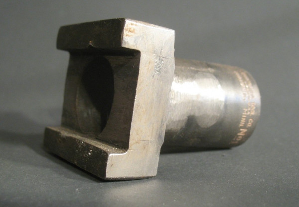

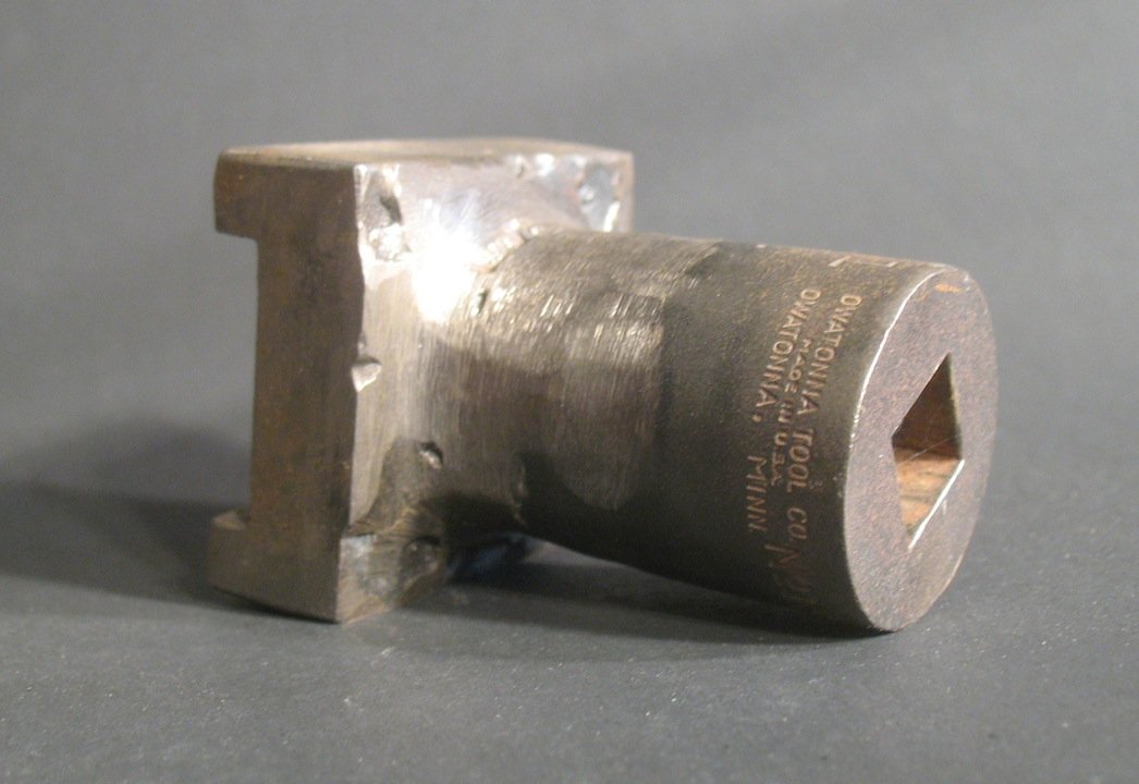

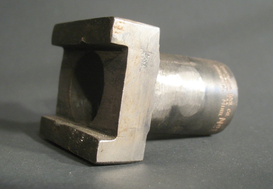

Here is a tool I made from a Model T wheel wrench.
It fits the front bearing and the camshaft nut.

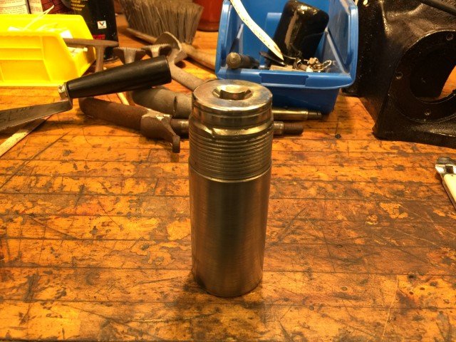

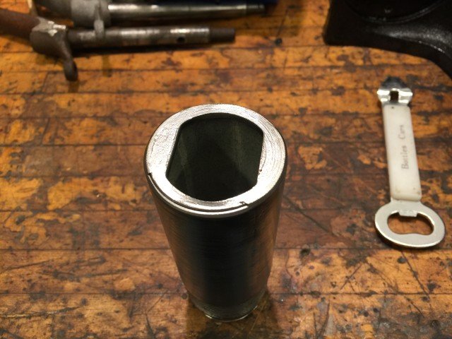

This is what I made for the timing gear nut.

BE_ZERO_BE wrote: ↑Tue Dec 08, 2020 12:05 pmHere is a tool I made from a Model T wheel wrench.
I believe the other tool shown is a beer bottle wrench, is it not?
Nice job on the cam nut socket!!

- Posts: 7411
Re: Same size?
...they are not deep enough to use on the spindle bearing.
I think it would be pretty easy to make a socket for that, but #1349 is good enough.
