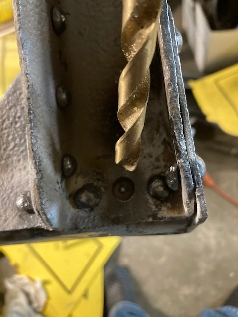

Drilling steel?
Using a commonly available titanium bit I am able to make very little progress drilling the pictured hole for the front fender hanger. Is there a better way?

Check the end of the bit and make sure it is sharpened correctly. I have seen several of those bits that were sharpened "backwards", the angle was ground the wrong direction. Those don't work too well.

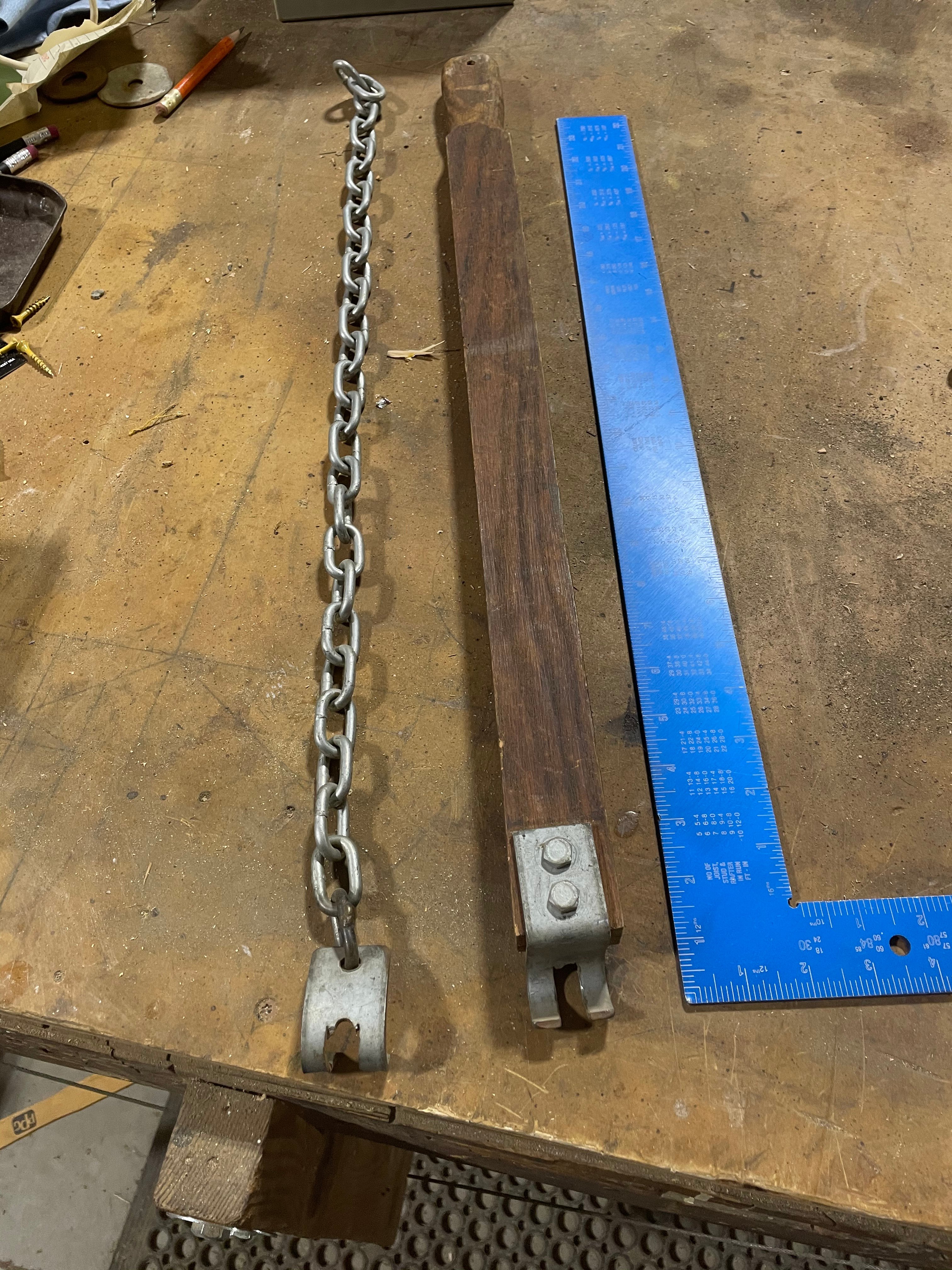

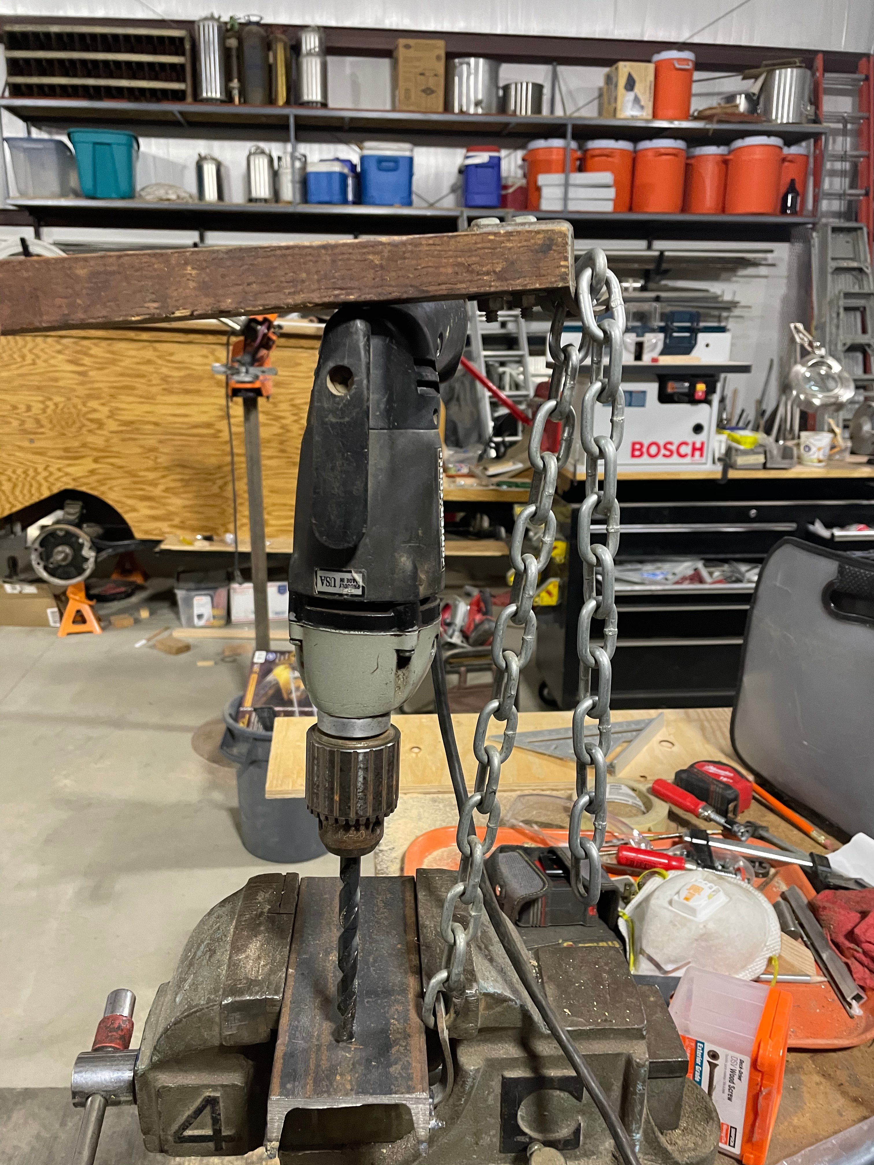

If you part will not fit in a drill press, use one of these.
This will give you sufficient downward pressure to quickly drill the hole.

I'd like to get some Norseman bits. I have a small set of Summit bits made in Montana and they're great drill bits.
Les, I didn't know someone actually made those! I've done similar when using a hand drill and a 2x4.
