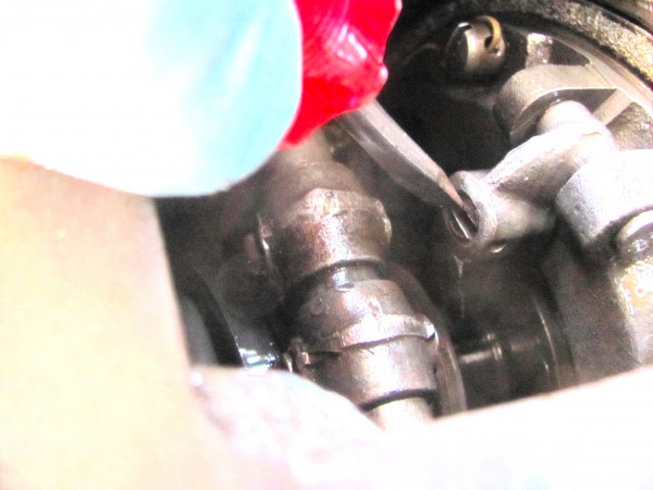

I was going to adjust the three clutch screws in the transmission. I jacked up the left rear wheel and placed the tranny in neutral. With the transmission in neutral the rear wheel will not turn. The parking brake is definitely not set. It doesn't make any difference what position the lever is in the wheel won't turn. Should it?

With the parking brake lever pulled back or in upright position, are the 3 clutch fingers loose? Can you freely move them in and out? If they don't, ether the adjusting screws are turned in too far or you need to adjust the linkage and bolt that rides on the cam for free neutral.
Turning the adjusting screws in increases pressure when the clutch is released, turning out decreases pressure when clutch is released. If the engine has not been rebuilt and rods not taken up lately, that should rule the engine itself out.
See if backing the bands off even more helps. Looking at the bands, can you see the ends of the linings?
