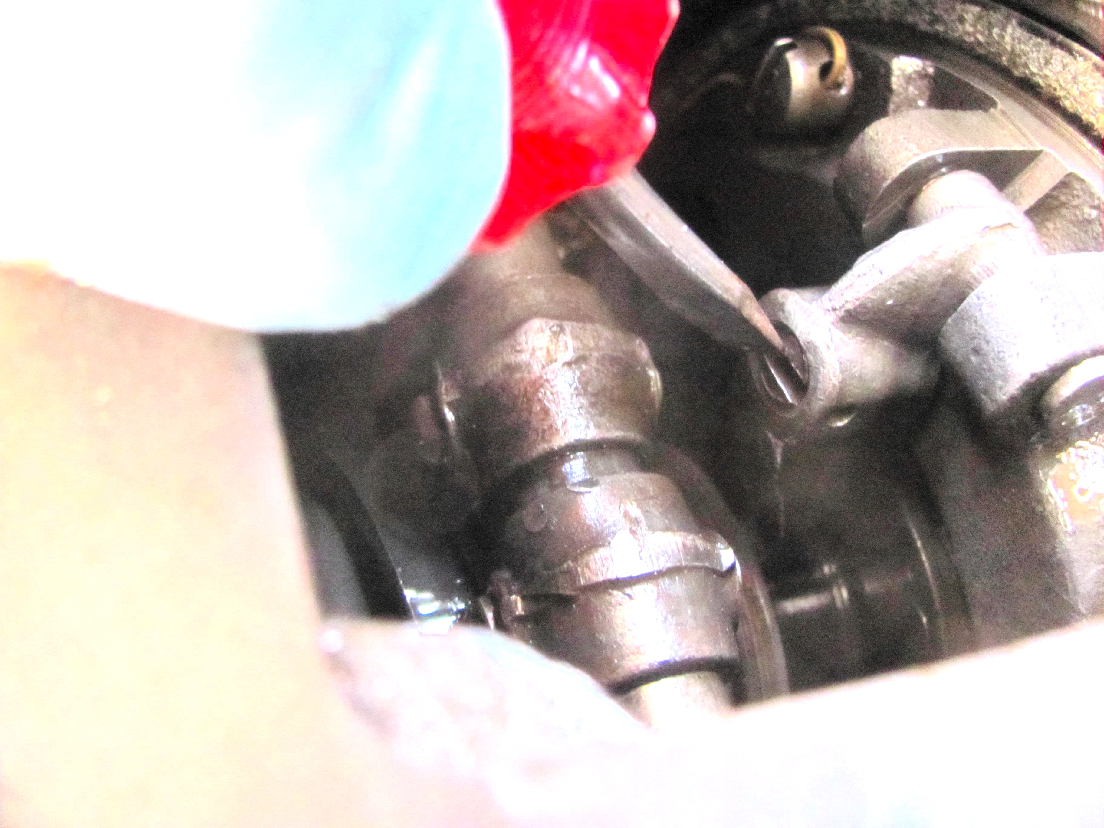

I was going to adjust the three clutch screws in the transmission. I jacked up the left rear wheel and placed the tranny in neutral. With the transmission in neutral the rear wheel will not turn. The parking brake is definitely not set. It doesn't make any difference what position the lever is in the wheel won't turn. Should it?

I do understand that Dan, The issue is that there is a tremendous amount of drag on the engine when cranking in neutral. In fact I cannot hand crank it, and I have hand-cranked many other Ts. With the lever in neutral I can turn the raised wheel with some serious effort. With the plugs out and the wheel jacked up in neutral the engine will hand crank just fine. What I'm really looking for is this: do you think I'm on the right track adjusting the clutch screws. I don't want to pull those cotter pins unless I have to. I have nightmares about dropping one.
