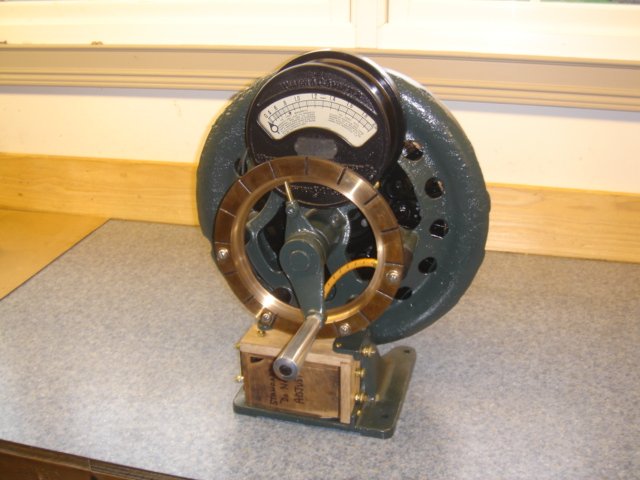

HCCT is a Hand Crank Coil Tester. The old ones were made with a model T flywheel, magnets, and coil ring. Many model t clubs have them or some members have them, one of the advantages of belonging to a local club. A HCCT is very big, heavy, and expensive, not the sort of thing the average T owner has. There are modern electronic versions that do not have the size, weight or cost of an original. Either one is the only way to properly adjust coils. If you have bought rebuilt coils they should already be set up and adjusted and should be good for years without touching.
Ron Patterson
Re: Did all ts have generators? And other questions about coil testing.
An HCCT is a hand cranked coil tester designed by Ford to test and adjust ignition coils and distributed to dealerships starting in 1919.

As stated above it is a a Hand Cranked Coil Tester. I have one for sale. Here is the post:
viewtopic.php?f=5&t=17858

I wouldn't spend the $$, see footnote:
Will this tester test for double sparking?
No it will not check for double spark or check the capacitor.
Answered By: 23 SEL
25 out of 27 found this answer useful.
Answered By: 23 SEL

What do you mean by that? It is less expensive than the HCCT. What all does the HCCT do anyway?

Andy's price may seem high, but it isn't. Decent hand cranked coil testers often cost more than he's asking. The other coil testers, Strobo Spark and ECCT, cost a few hundred less. And less costly than buying a tester is sending your coils to one of the guys who restore and adjust them (Ron Patterson, Brent Mize, Andy Loso, Luke Chennel, and others).
I agree with the good advice above on safe hand starting. The difference between starting on BAT and starting on MAG is that on BAT the batteries buzz the coils even as you pull slowly. On MAG you have to pull fast enough to generate the voltage yourself. Of course that does NOT mean spin. Just pull up quickly. Here's my page on hand starting, with links to videos: http://dauntlessgeezer.com/DG101.html

Properly adjusted Model T coils are essential for optimal engine performance. Properly adjusted coils means the coils are adjusted for equal and consistent firing time from the moment the Timer (aka commutator) activates the coil to fire spark when the piston at the proper position. Coil firing timing error degrades engine power and smoothness.What all does the HCCT do anyway?
Accurate measurement of brief intervals such as coil firing time (~0.002 seconds) was not practical back in the day but the accurate measurement of electrical current was. The Hand Cranked Coil Tester (HCCT) is constructed with Model T magneto coil and hand cranked to produce the electrical output that powers the coils. The HCCT and All legacy coil testers used accurate Ammeters to measure the resulting average coil current flowing in the coil primary winding as an indirect approximating of coil firing time. The objective is to adjust the coil points on all 4 coils so they produce the same average coil current reading when powered by cranking the HCCT briskly (60 - 120 RPM), and thus, the same firing time. One cavoite is that the coil must only spark once for each HCCT pulse of electricity. There are 16 HCCT pulses of electricity for each revolution of the hand crank so each revolution of the crank must produce 16 sparks. The spark gap rotates with the HCCT crank which makes it easy to see 16 evenly spaced sparks as the crank is rotated when the coil points are adjusted properly. A double spark at one or more of the 16 positions means there is a spark timing issue that must be corrected by adjusting the cushion spring tension on the upper point element. Double sparking is bad because the spark energy is divided between an early (advanced) weak spark occurring too soon and a late (retarded) weak spark occurring too late for good ignition to occur. Considering the HCCT operates at abnormally slow speed (60-120 RPM) that produces abnormally low output voltage and rise time in which the coils will never operate, HCCT adjusted coils work remarkably well provided all 4 coils are matched both electrically and mechanically.
Simple buzz box col testers only measure coil current without a rotary spark gap cannot detect double sparking so are limited in their ability to confirm proper coil point adjustment. They are capable of testing the coil has good primary and secondary windings.
I developed a modern coil tester that accurately measures the coil dwell time to fire spark known as the Electrically Cranked Coil Tester (ECCT). You can learn more about it from the website here: www.modeltecct.com
Coil points are consumable items which require periodic maintenance and adjustment for optimal engine performance. Many learn and enjoy the art of coil point adjustment as integral part of the Model T experience. Others prefer to simply send them out. Definitely considering joining your local Model T club to benefit from the knowledge and resources they can provide to you as a member.
