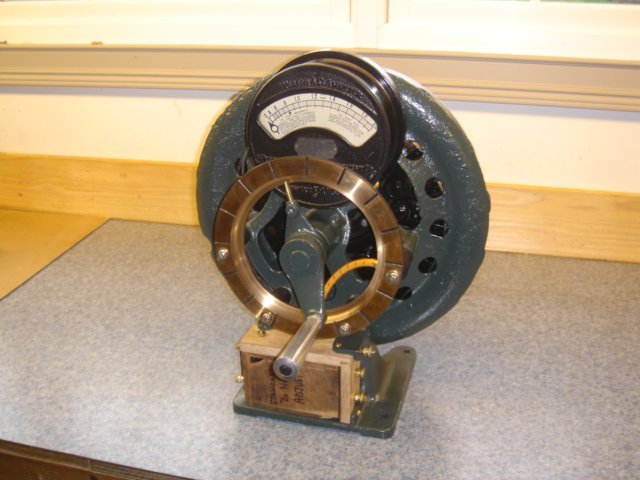

Jonah -
When I was your age I was deep into my first Model T (we never forget our first...). I knew every single bolt, nut and screw in that car. I dialed around on the Holley NH carburetor, teaching myself how to adjust it. I fumbled with the nuts on the coils until it started like a breeze (on battery). I grew more confident. Soon, I felt I had coil-adjusting superpowers and, years later, when a friend of mine told me he had found an original hand-cranked-coil tester for $100, I laughed in his face for wasting his money. "You don't need one of those!" I guffawed. "I can adjust coils!"
That day I was driving a 1925 TT C-cab I'd had a couple of years and it was parked right outside the shop door. After fussing with the coils in the TT, I had succeeded in getting it to run great on battery, but only to sputter and die on magneto. The magneto was obviously defective. Stupid Ford magneto.
My friend told me to pull my coils and bring them into the shop and we would take them for a ride on the new hand-cranked-coil machine. I rolled my eyes and agreed to waste my time to humor my old friend. Since I had never before wasted my time with a coil tester, I didn't know exactly what he was doing to each coil, but I watched him tap on this and pry on that, attentively watching a series of fat blue sparks that started appearing as he worked on each one. By and by all four were done.
He handed the stack back to me with a curious smirk on his face but said nothing. I fed them back into the box and started the truck. It sounded fine; no worse, but definitely not noticeably better. "Try mag" said my friend. "No, the mag is dead" I answered. "Try it" said he.
I flipped the key over, knowing it would miss, lose speed and die. I was shocked when it not only kept running, it gained speed and smoothed out! I was in stunned disbelief. How could this be? It was very responsive to the throttle and ran so solidly, without missing a lick. I turned off the ignition and when the engine stopped, I turned the key back to magneto. I pulled the crank and nothing. My friend stepped forward and pulled the spark lever down 3/4 of an inch or so. "Try now." I gave the crank a skeptical flip and it started!" What the...? I turned it off and started it again on magneto. It was easy. Effortless, even. Well, hell! This was amazing!
During the 20 or so mile drive home, the old truck never ran better. It had never run so smoothly and powerfully. It was as if the engine had been overhauled and a distributor put on. It ran like a six. I was delighted. This made me love the old TT at least twice as much!
I started it on mag for the rest of the day and it rewarded me with firing right up and running better than I had ever known it to run. I could not get the smile off my face.
The next morning (I used the truck every day) I did NOT turn the key to battery, as I had always done, but tried mag for the cold start. It started as easily as it previously had on battery. As long as I drove that truck I never turned the key to battery again, I always started and ran on mag.
Epilogue:
I pulled all the coils out of all the cars and hustled them up to my friend's place to give them all the "treatment". My normally jovial friend gave me a bemused smile and said "No". "What?! What do you mean 'no'? I need these things adjusted so they all work like the TT!" "Buy your own coil machine!" he laughed.
So I did! I found a junky one on eBay and charged the magnets, glass beaded all the parts, painted them and had an electronics friend check the big amp gauge for accuracy. Now I run all my coils through it at the beginning of every season and more often if the car has been used a lot. But honestly after the initial setting, they normally don't need much throughout the year; they just work. They always work.
So, Jonah, the answer is yes, if there is no battery, you just start them on mag.

Get your coils set up properly on a HCCT. Your coils are most probably set at too high a current draw and your mag is not generating enough voltage at hand cranking speed at say 60/100 rpm but fires the coils OK at idle and better at speed.....N.

HCCT is a Hand Crank Coil Tester. The old ones were made with a model T flywheel, magnets, and coil ring. Many model t clubs have them or some members have them, one of the advantages of belonging to a local club. A HCCT is very big, heavy, and expensive, not the sort of thing the average T owner has. There are modern electronic versions that do not have the size, weight or cost of an original. Either one is the only way to properly adjust coils. If you have bought rebuilt coils they should already be set up and adjusted and should be good for years without touching.

An HCCT is a hand cranked coil tester designed by Ford to test and adjust ignition coils and distributed to dealerships starting in 1919.

As stated  above it is a a Hand Cranked Coil Tester.  I have one for sale. Here is the post:

Andy's price may seem high, but it isn't. Decent hand cranked coil testers often cost more than he's asking. The other coil testers, Strobo Spark and ECCT, cost a few hundred less. And less costly than buying a tester is sending your coils to one of the guys who restore and adjust them (Ron Patterson, Brent Mize, Andy Loso, Luke Chennel, and others).
I agree with the good advice above on safe hand starting. The difference between starting on BAT and starting on MAG is that on BAT the batteries buzz the coils even as you pull slowly. On MAG you have to pull fast enough to generate the voltage yourself. Of course that does NOT mean spin. Just pull up quickly. Here's my page on hand starting, with links to videos: http://dauntlessgeezer.com/DG101.html
