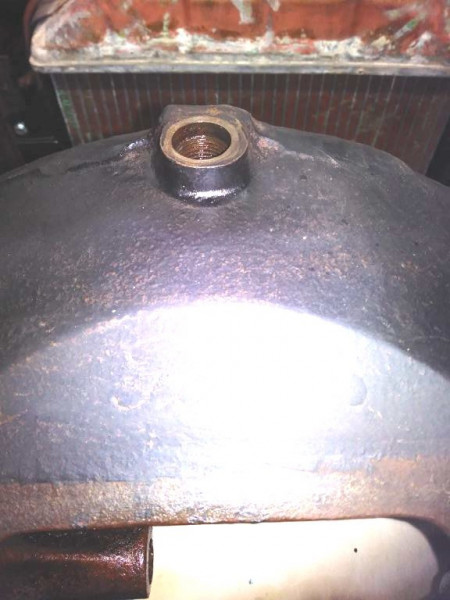

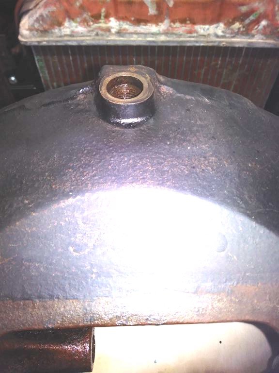

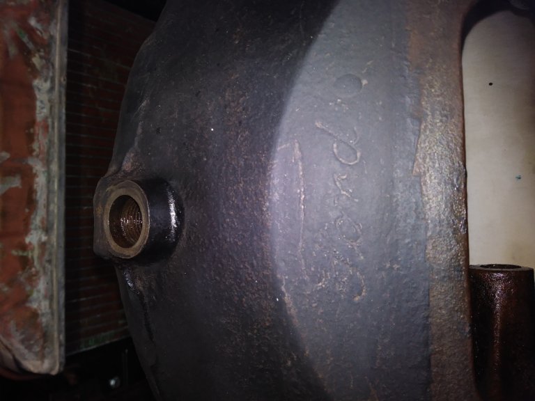

So, I believe my 23 has been upgraded with a newer tranny. It has the large brake drum, and the hogshead has the screw in mag post. However, it still has the small pedals. Looking at the hogshead, it appears that the mag post area has been welded. Would it have been common to replace the boss of the mag plug, or is the welded boss just the way the were? Thanks..Tommy

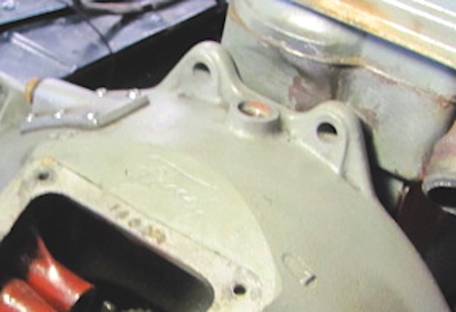

Appears someone 'modified' that 26-27 hogshead, changed the pedals to earlier, and then ground off the 'lugs' on the top of the hogshead that would allow the 26-27 to mount to the rear of a 26-27 block. Did this to keep the look of a pre-26 hogshead.

Thanks Adam..First, thanks for rotating my picture. That makes sense to me now. I was reading about the differences and the "ears", on the 26/27, which I wasn't sure what they were talking about, now I know. I do have the wide band and the small pedals, so all your info lines up with what I have. Thanks again. Tommy
