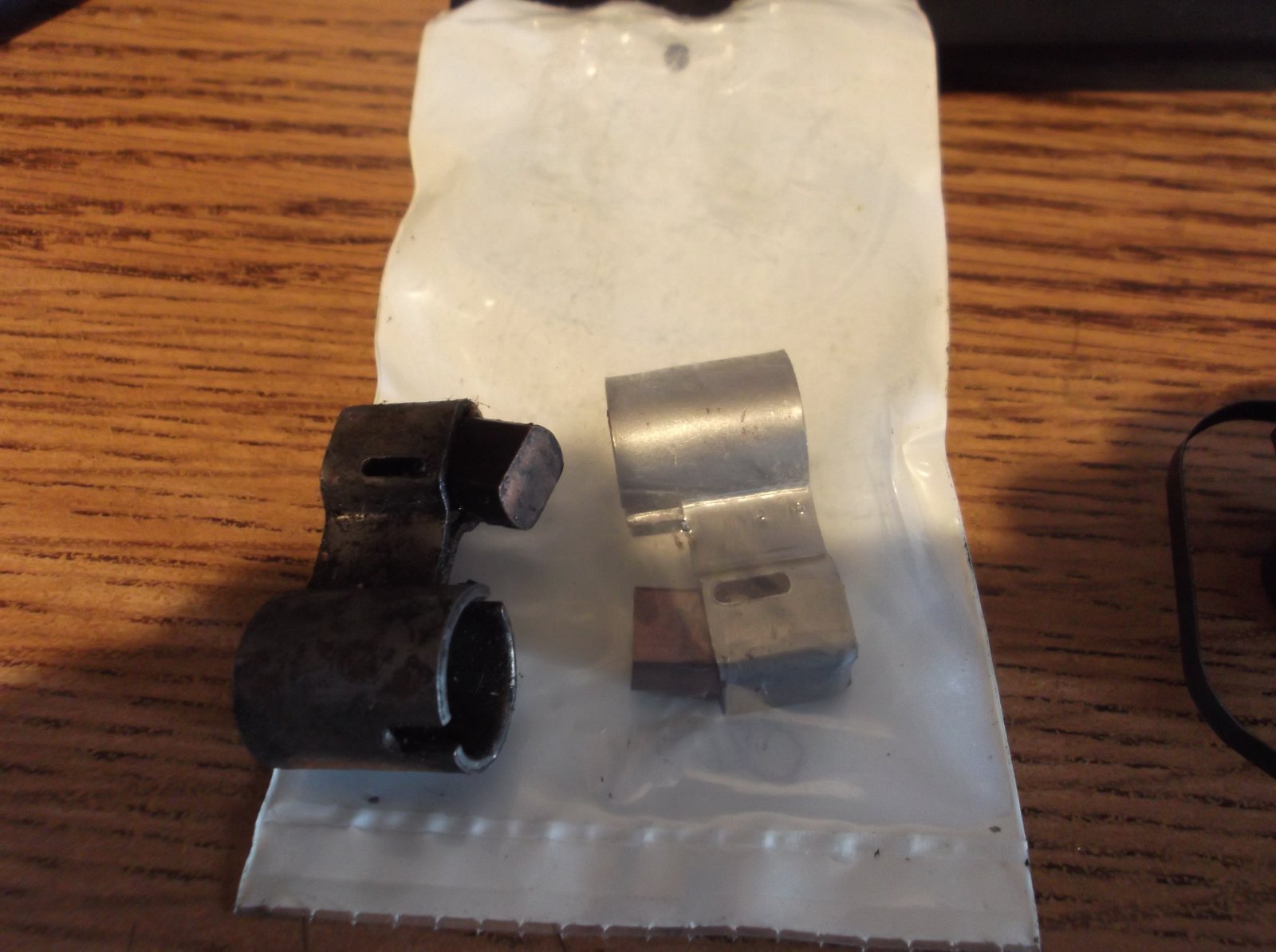

I posted this as a separate thread but here is the timer I removed. No wonder things seemed wonky. The carbon brush was mostly dust after four months. I did feel like my timer advance and retard adjustments were very fudgy.
So I put in a NOS New Day and everything is working properly. Was wondering why I didn’t see any real benefit with the OF. It simply couldn’t do its job with crappy timing.

Maybe your old timer would have benefited from some lubrication?
- Posts: 5437
Re: Favorite Timer with OF Carburetor
You do not lube brush type timers. They are run dry. Lubing them would be like putting grease on the generator commutator.
- Posts: 761
- Joined: Sun Jan 06, 2019 12:07 pm
- First Name: Thomas
- Last Name: Hicks
- * REQUIRED* Type and Year of Model Ts owned: '24 TT, '26 TT, '24 Speedster, '26 Speedster
- Location: Chesterfield, VA
So this is normal wear for a brush type timer? How many miles would it take to wear one this much?
Topic author - Posts: 1014
- Last Name: Osterman
- Location: Rochester, NY
I’ve had this timer for two years now. It took about ten months the first time to wear down this far. I sent the timer back for inspection and a new brush. A second interior track was installed. I put it back into the car in October and took it off yesterday. So .. I guess they last a few months.

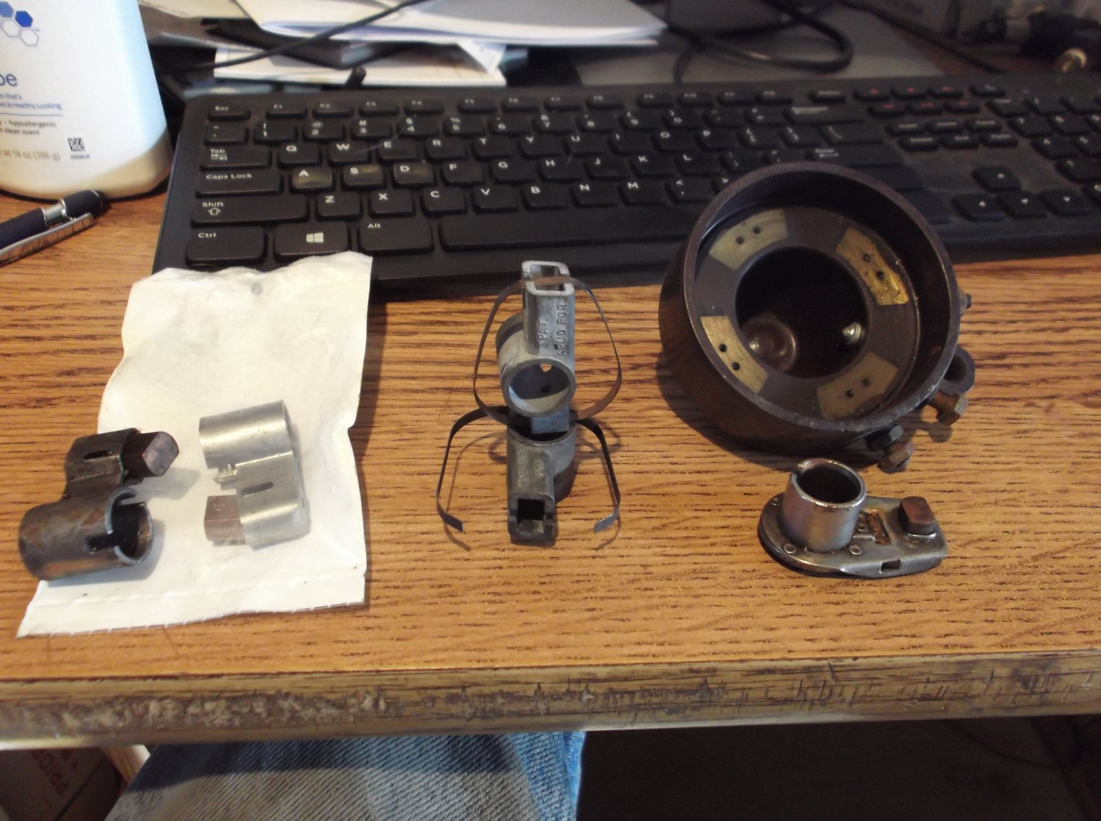

You say the timers pictured are carbon brush style timers?? Looks like roller styles to me. If so, they needs oil.

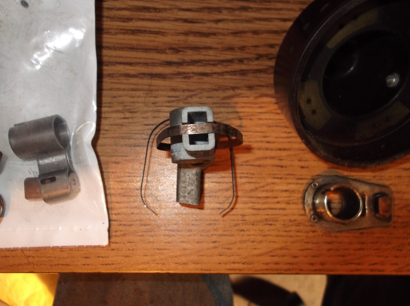

Yes, it’s a modern TW Timer. Here it is with the carbon brush and housing. You do not lubricate this type.
- Posts: 5437
Ford tried a brush type like this for a while. I wonder if it is just the type of carbon used for the brush? The New Day uses a copper brush, so wonder if using something like that or a brush with more surface area would work better? In the past I was given 3 era aftermarket brush holders, the brush wipes across the contacts. Idon't know what material was used as the brushes were missing, I used generator brush, which was ok till the spring broke, do not recall how long it lasted.
The brushes for the New Day and Blublaze are copper.
