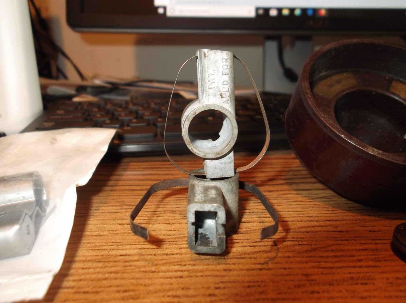

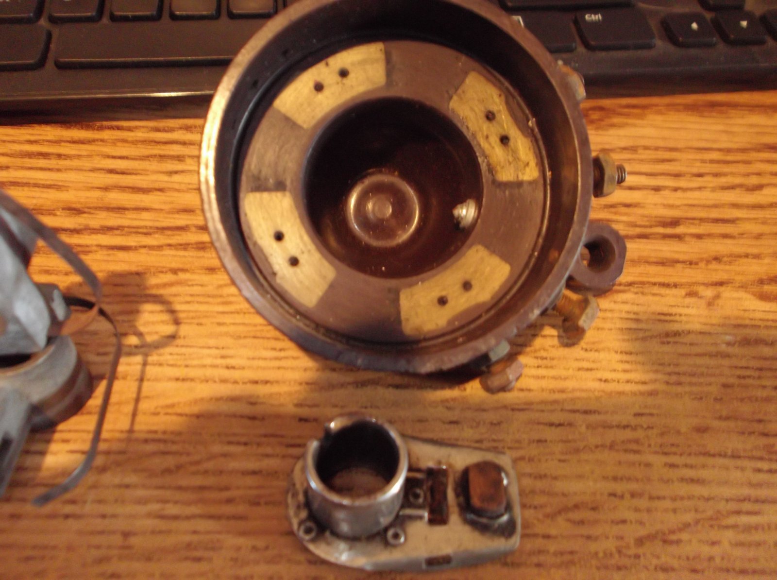

I posted this as a separate thread but here is the timer I removed. No wonder things seemed wonky. The carbon brush was mostly dust after four months. I did feel like my timer advance and retard adjustments were very fudgy.
So I put in a NOS New Day and everything is working properly. Was wondering why I didn’t see any real benefit with the OF. It simply couldn’t do its job with crappy timing.

Maybe your old timer would have benefited from some lubrication?
- Posts: 5438
Re: Favorite Timer with OF Carburetor
You do not lube brush type timers. They are run dry. Lubing them would be like putting grease on the generator commutator.

So this is normal wear for a brush type timer? How many miles would it take to wear one this much?
Mark Osterman
Topic author - Posts: 1014
- Last Name: Osterman
- Location: Rochester, NY
I’ve had this timer for two years now. It took about ten months the first time to wear down this far. I sent the timer back for inspection and a new brush. A second interior track was installed. I put it back into the car in October and took it off yesterday. So .. I guess they last a few months.

You say the timers pictured are carbon brush style timers?? Looks like roller styles to me. If so, they needs oil.

Yes, it’s a modern TW Timer. Here it is with the carbon brush and housing. You do not lubricate this type.
- Posts: 5438
Ford tried a brush type like this for a while. I wonder if it is just the type of carbon used for the brush? The New Day uses a copper brush, so wonder if using something like that or a brush with more surface area would work better? In the past I was given 3 era aftermarket brush holders, the brush wipes across the contacts. Idon't know what material was used as the brushes were missing, I used generator brush, which was ok till the spring broke, do not recall how long it lasted. The brushes for the New Day and Blublaze are copper.

Mark, You must have something not quite right alignment wise with the TW timer. I have one in my 27 RPU that I tour in that has several thousand miles on the original brush. I clean it every year and only a small amount dust. Just put over 600 miles in the last two weeks and still going strong.
