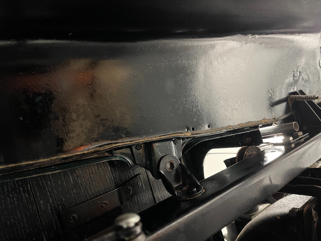

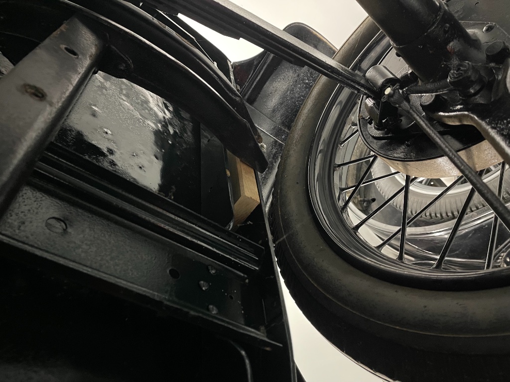

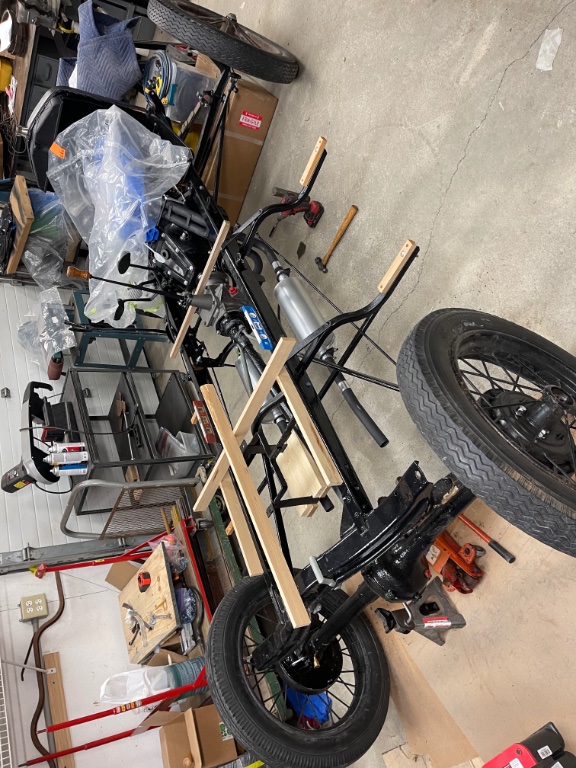

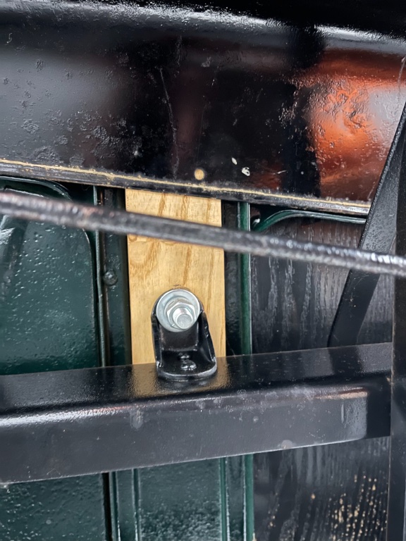

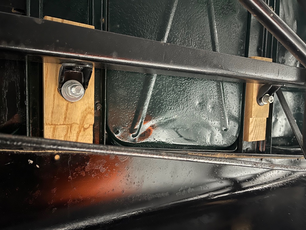

Re: '26 Roadster Pick Up Body Blocks
Post by dmdeaton » Mon Jan 25, 2021 3:09 pm
Thanks guys, good timing and I didn’t need to search. I am almost ready to set my body also
dmdeaton
Posts: 732
First Name: Danny
Last Name: Deaton
Post by dmdeaton » Mon Jan 25, 2021 3:11 pm
dmdeaton
Posts: 732
First Name: Danny
Last Name: Deaton
Post by dmdeaton » Mon Jan 25, 2021 3:13 pm
dmdeaton
Posts: 732
First Name: Danny
Last Name: Deaton
Post by dmdeaton » Mon Jan 25, 2021 3:14 pm
dmdeaton
Posts: 732
First Name: Danny
Last Name: Deaton
Post by dmdeaton » Mon Jan 25, 2021 3:15 pm
