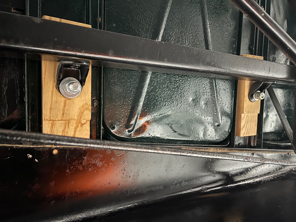

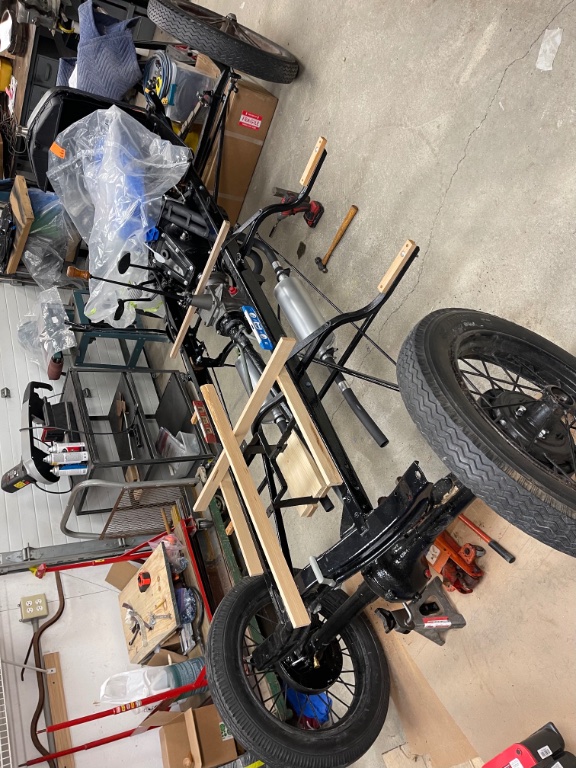

Looking for some direction on installation of wooden blocks for our 26 T pick up. The truck was purchased in mid-restoration and there were no blocks installed. We are almost ready to re-install body and wanted to ask if there is a diagram or instructions for correct placement.. thx Dante

This older post will help you, read it all the way down, and also go to the link at the bottom of the post. The first photos are only partially correct placement, you can read more on the link. Have Fun!

Thanks so much for the pics, this is going to be a great help..
Have a great day....dante

Thanks guys, good timing and I didn’t need to search. I am almost ready to set my body also

Re: '26 Roadster Pick Up Body Blocks
Post by dmdeaton » Mon Jan 25, 2021 3:11 pm
Post by dmdeaton » Mon Jan 25, 2021 3:13 pm
Post by dmdeaton » Mon Jan 25, 2021 3:14 pm
Post by dmdeaton » Mon Jan 25, 2021 3:15 pm
