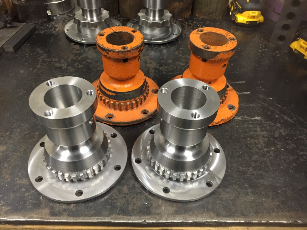

I am working on a Farm Tractor Co. of Fond Du Lac Wi. conversion and I am building the rear roller sprockets ( I have one 4 roller original for a pattern). I have the rough taper machined in and would like to know if anyone makes a finish taper reamer for the bore? Thank You for any help. Dan Greger

Thank You All for your information, I never thought of using a ball in the tapered bore for getting the correct size, I will do just that. I turned a taper on a piece of round stock up and machined a 1/4 in. keyway in it to use as a mandrel to broach the key slot in the new sprockets. ----Dan Greger
