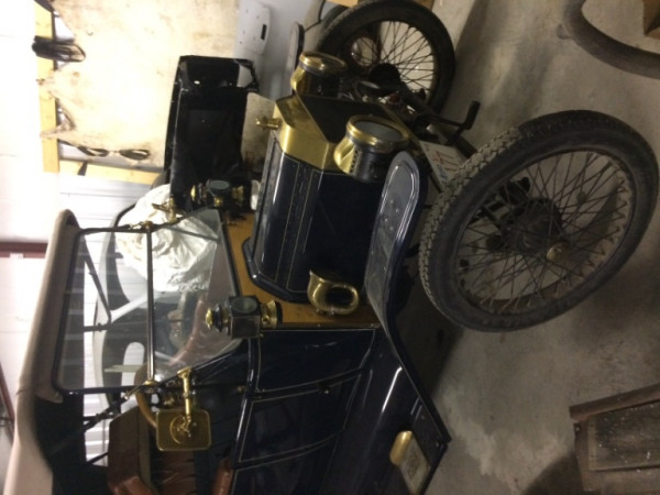

I have acquired a 40-year-old unfinished 1913 Touring project that someone put a lot of effort into. Especially the hydraulic brake setup required a lot of engineering and machining. It has been suggested that the car might have come from the West coast, possibly California, where this type of modification was popular before disk brakes became trendy. The engine has a Model A crank, possibly for mountain racing, as it also has 21-inch wire wheels with balloon tires.
My intention is to make the car more like a 1913 and reliability is my number one priority. I would like to keep the 4-wheel hydraulic brakes, but want to go back to the 30-inch wood spoke wheels. I need to come up with a wood spoke hub fitted to an eight-inch drum. Currently I have the 21-inch wire wheel hubs with drums. The hydraulic system is definitely Nash Metropolitan, as was popular in the day. The rear was all fitted to a small drum T backing plate with 8-inch Metropolitan brake shoes. And the front spindles were fitted with Metropolitan backing plates.The work looks well designed. The front end has already been modified with a double wishbone to handle the stress of the front brakes. The steering is still original Model T (no box).

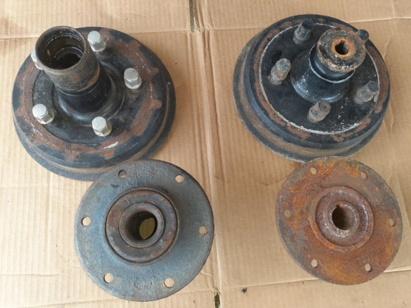

I know I will have to mate clincher style wheel hubs with 8-inch drums. I have read on the old Forum that there are several types of 8-inch drums that could be used, such as RX7, Chevy Citation, and VW Jetta.
I would be open to swapping my good wire wheels and hubs with the Metropolitan drums for good wood spoke wheels, hubs, and drums. But I know that's probably a long shot. Or let me know if anyone has any related parts that I can buy. I'll also be in the market for a master cylinder and some type of proportioning valve.

So I did a quick search and Rock Auto does NOT list the brake drums. Some other brake parts yes. In regards to the master cylinder, Speedway Automotive has extensive listings and related components.
There are probably other sources of suitable drums but probably just as easy to use the drums you have.
I recommend you use a “safety hub(with a ball bearing)”

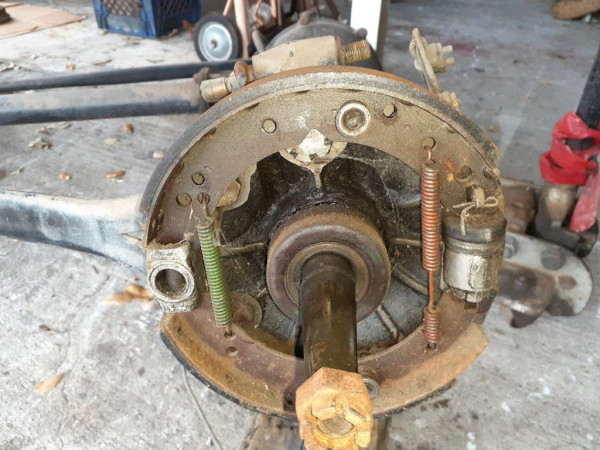

I have used Metro brakes with both wood wheels and 26/27 wire wheels and I am a fan of them. The little Mets have a good following so there are several parts vendors. I've used https://www.shopmetropolitanparts.com/default.aspx with good success.
If your drums are in otherwise good condition, you should be able to simply get them redrilled for the 6 lug bolt pattern of wood wheel hubs. Pretty much easy peasy. If you want new drums, they will require a bit of machining to remove a lip on the inside of the drum that helps locate it on the hub in a stock Metro as well as drilling for the 6 bolt hub. Brake shoes, wheel cylinders and other bits are all available and pretty reasonable (even for a T guy). I use a 3/4" bore master cylinder that I got from Speedway Motors as it has a remote reservoir which was easier for me.
Brakes are a good thing and while these are obviously not stock to many vintage car folks, most of the general population wouldn't know that. Good to hear that you have the double wishbone, that would be absolutely necessary with front brakes.

Mine are strictly bolt together. Some use of simple spacers to manage depth of drum vs. backing plates but quite straight forward. Looks like you would be starting the process for using wood wheel hubs from scratch regardless of bolting vs. welding.
