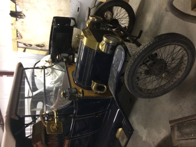

I have acquired a 40-year-old unfinished 1913 Touring project that someone put a lot of effort into. Especially the hydraulic brake setup required a lot of engineering and machining. It has been suggested that the car might have come from the West coast, possibly California, where this type of modification was popular before disk brakes became trendy. The engine has a Model A crank, possibly for mountain racing, as it also has 21-inch wire wheels with balloon tires.
My intention is to make the car more like a 1913 and reliability is my number one priority. I would like to keep the 4-wheel hydraulic brakes, but want to go back to the 30-inch wood spoke wheels. I need to come up with a wood spoke hub fitted to an eight-inch drum. Currently I have the 21-inch wire wheel hubs with drums. The hydraulic system is definitely Nash Metropolitan, as was popular in the day. The rear was all fitted to a small drum T backing plate with 8-inch Metropolitan brake shoes. And the front spindles were fitted with Metropolitan backing plates.The work looks well designed. The front end has already been modified with a double wishbone to handle the stress of the front brakes. The steering is still original Model T (no box).
I have searched the old forum and found a lot of good information from several of you guys. Especially Ralph Ricks, who, unfortunately, is no longer with us. I also recognized the names of some of you who are currently on the forum.
Ideally, I would love to hear from someone who has hands-on-experience and is knowledgeable with this older hydraulic brake upgrade.
I know I will have to mate clincher style wheel hubs with 8-inch drums. I have read on the old Forum that there are several types of 8-inch drums that could be used, such as RX7, Chevy Citation, and VW Jetta.
I would be open to swapping my good wire wheels and hubs with the Metropolitan drums for good wood spoke wheels, hubs, and drums. But I know that's probably a long shot. Or let me know if anyone has any related parts that I can buy. I'll also be in the market for a master cylinder and some type of proportioning valve.
