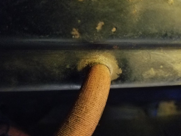

We talk about these every so often so I measured and took a picture
of mine in the shop today.The running boards and splash shields are original 1913.
The carbide generator holes have the diamond pattern "shortened" in front
of them so the punch hits a flat spot. Slight indentation on the top and a
slight smooth rim on the underside. It is 21/64" in diameter.
The gas hose hole is 1/2" in diameter and has a smooth 1/8" high rim
around the edge to protect the gas hose.
CARBIDE GENERATOR HOLE-21/64" DIAMETER  PUNCHED
ACETYLENE GAS HOSE HOLE- 1/2" DIAMETER WITH 1/8" RIM

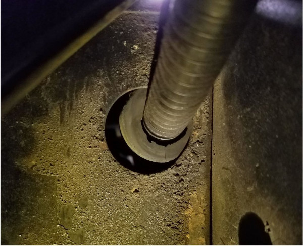

Post by Drkbp » Mon Feb 01, 2021 4:44 pm
Since I was under there, I measured the speedometer hole punched in the right
splash shield but couldn't get it to load just previous for some reason.
It is 1-1/4" in diameter, smooth and flush with the shield.
I moved the grommet and Stewart cable out of the way to measure.
Frame of car is just to the right.
Does anyone have a picture of a 1912 running board that has the two 21/64" holes
punched for the carbide generator like the 1913's?
1-1/4" SPEEDOMETER CABLE HOLE - RIGHT SPLASH SHIELD
