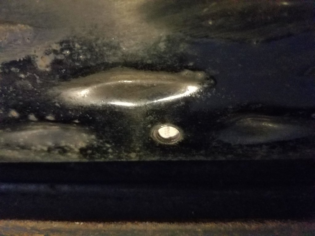

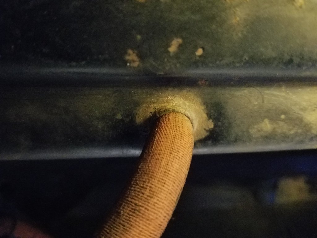

We talk about these every so often so I measured and took a picture
of mine in the shop today.The running boards and splash shields are original 1913.
The carbide generator holes have the diamond pattern "shortened" in front
of them so the punch hits a flat spot. Slight indentation on the top and a
slight smooth rim on the underside. It is 21/64" in diameter.
The gas hose hole is 1/2" in diameter and has a smooth 1/8" high rim
around the edge to protect the gas hose.

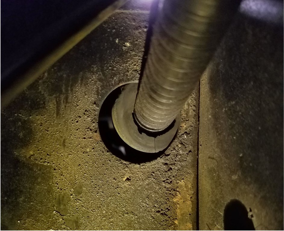

Since I was under there, I measured the speedometer hole punched in the right
splash shield but couldn't get it to load just previous for some reason.
It is 1-1/4" in diameter, smooth and flush with the shield.
I moved the grommet and Stewart cable out of the way to measure.
Frame of car is just to the right.
Does anyone have a picture of a 1912 running board that has the two 21/64" holes
punched for the carbide generator like the 1913's?

- Posts: 3886
- First Name: Larry
- Last Name: Smith
Re: Question about carbide generators
You should be able to buy an exact copy of the speedometer casing grommet from Langs. When I was running the business, that is the way it was. I turned over the business to my partner a couple of years ago.
