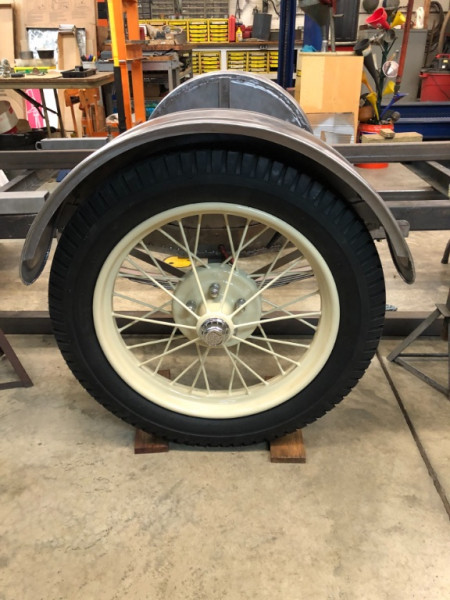

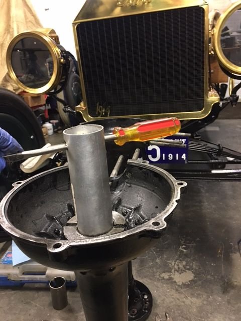

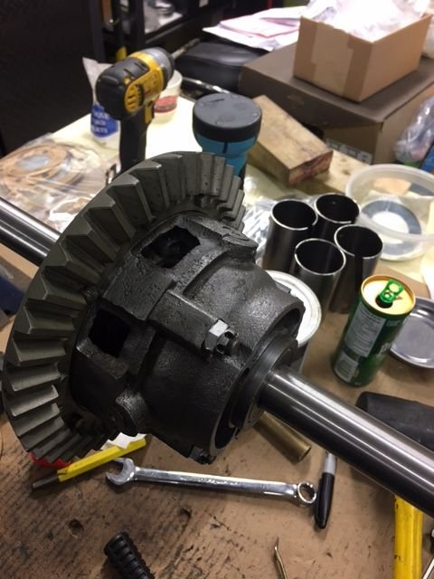

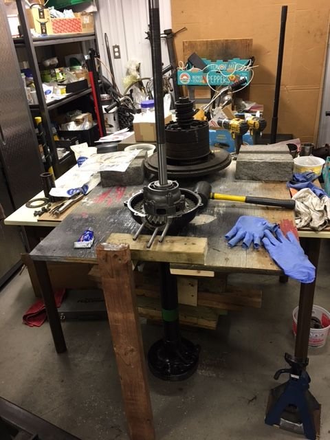

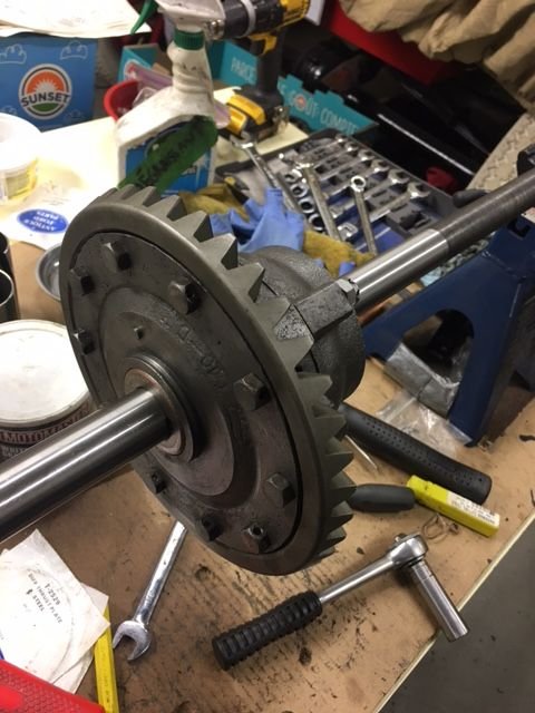

Starting to rebuild my rear axle as well...

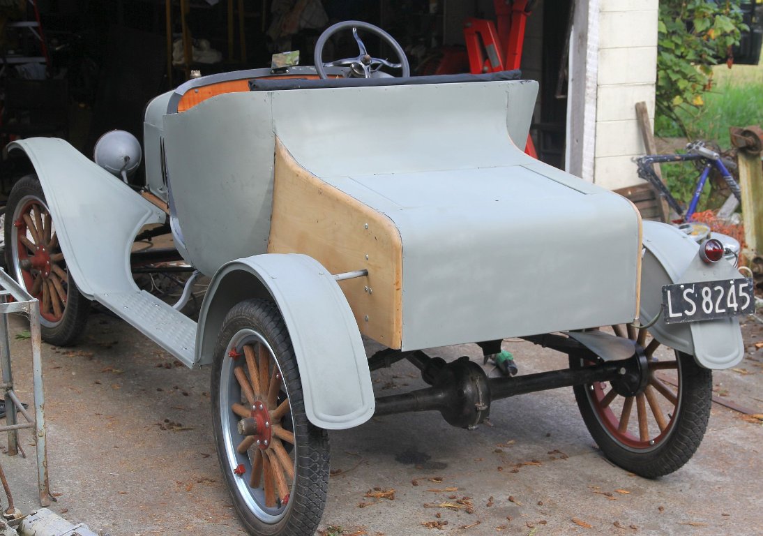

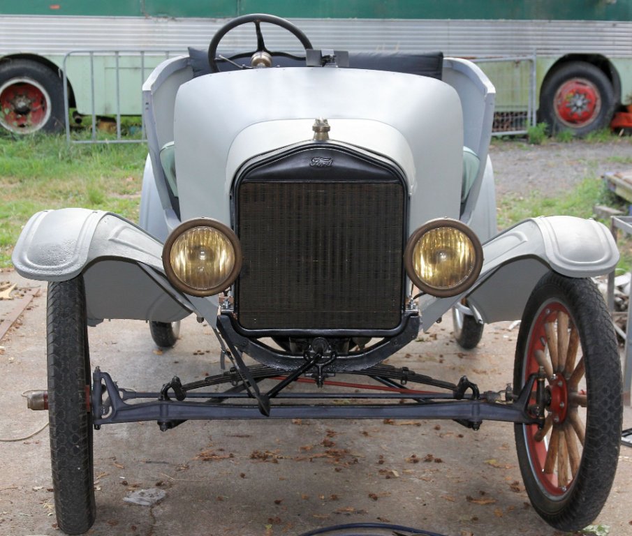

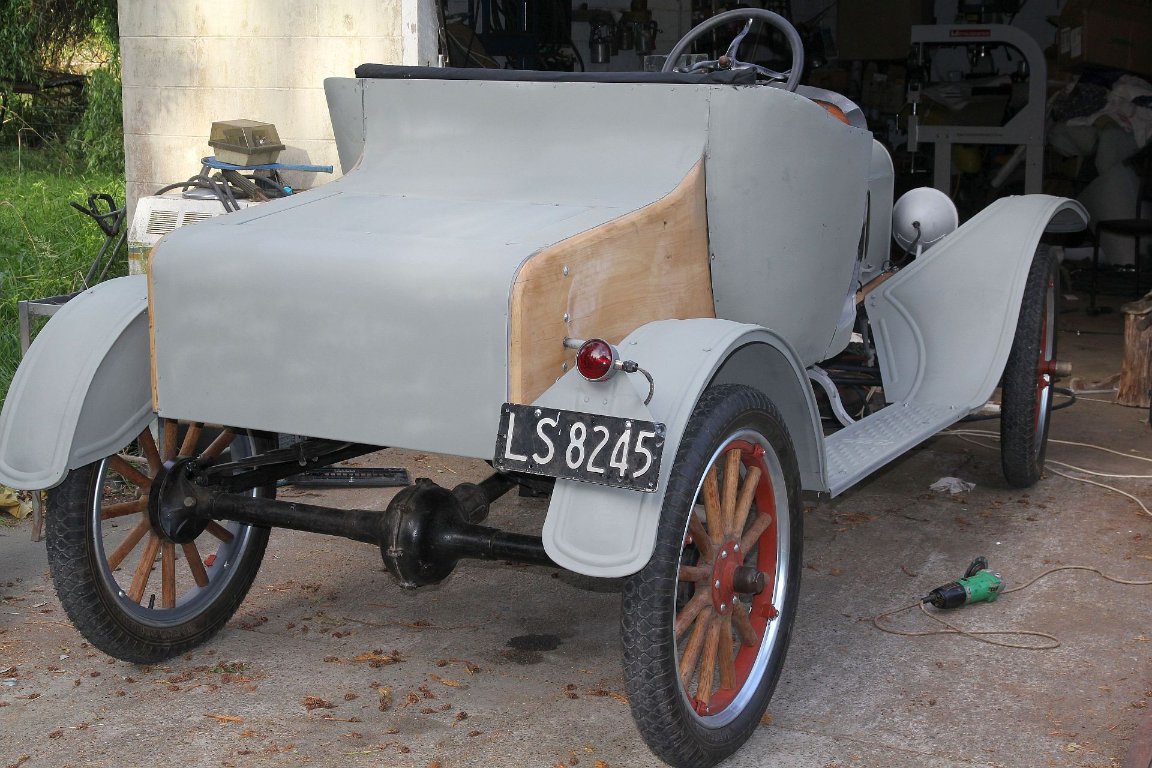

Panels all installed and a quick coat of primer. Trim and a 'bolt and nut patrol' to do then off for a compliance check for registration. So far I have the paper work sorted as well (which went very smoothly - but then our system sounds simpler than in the US).
Doors, windscreen, top and proper upholstery and proper paint in the 'next stages' of the plan.
She runs well too:

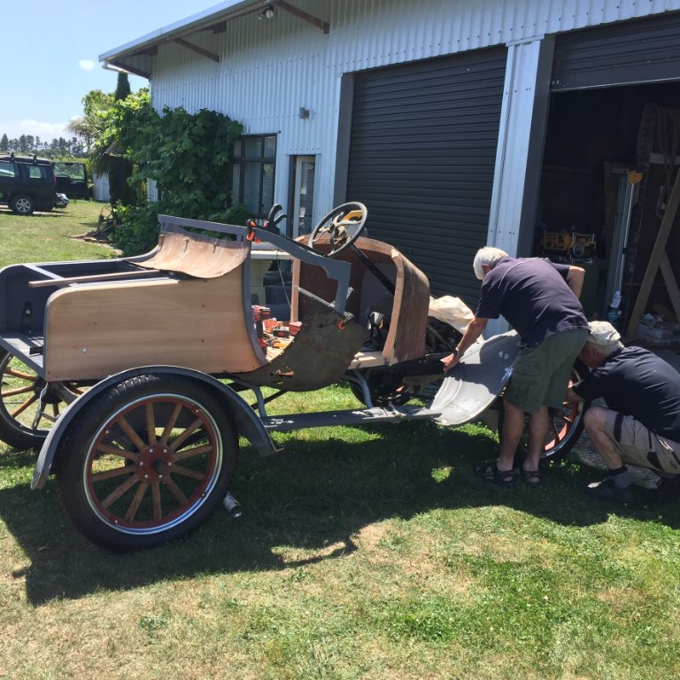

This was the car 11 days ago!!

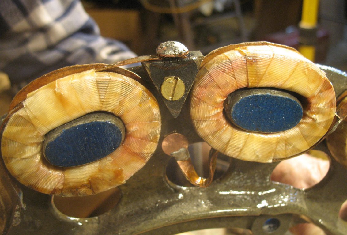

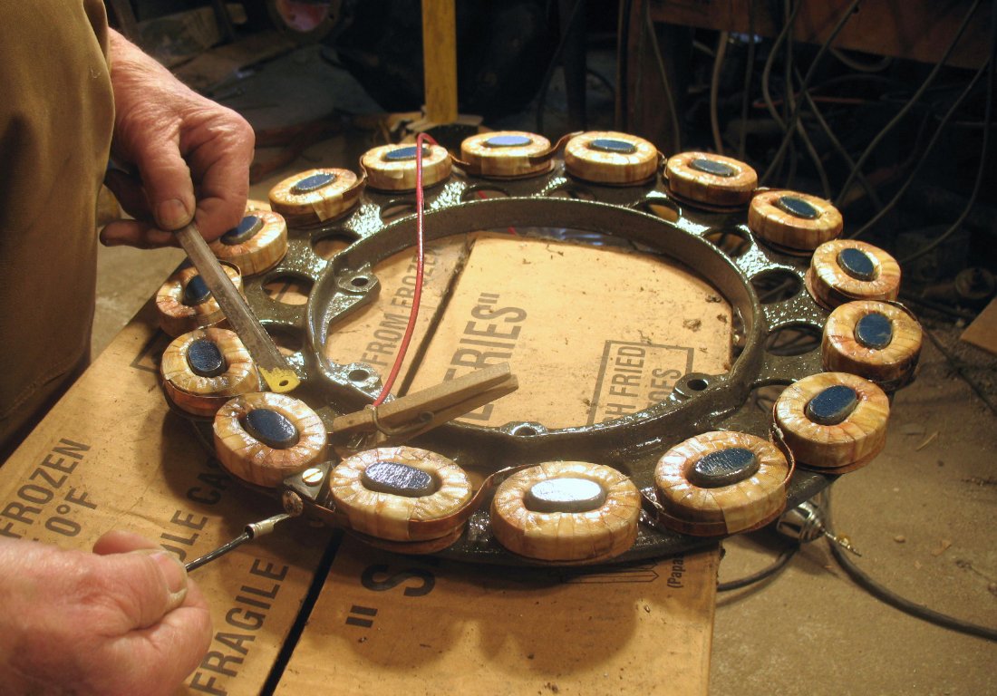

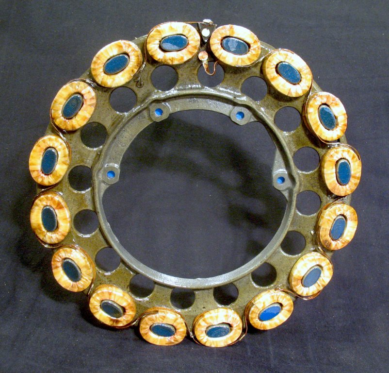

Today I finished my mag coil ring. It took months because I worked on it in spurts between other chores.
It's the first one of these I've ever done.
When I zapped it with twelve volts — WHAP! It grabbed that hacksaw blade like nobody's business, so I am a happy camper. It's not as pretty as some I've seen, but as long as it works I don't care if it's ugly as a mud fence.
The details are not all factory correct, but they're what was available, and it works.

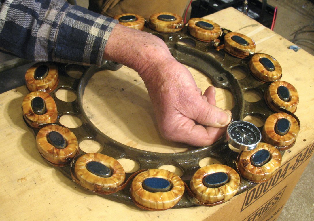

Looking great Steve.
See you did a magnet test. Did you do a polarity test too?
The polarity test (N-S;N-S; ... 16 times) will tell you for 95% if your loop will work or not.
the 5% left has to do with the connections in the car and the way the magnets are charged. (weak -strong?)
Good luck

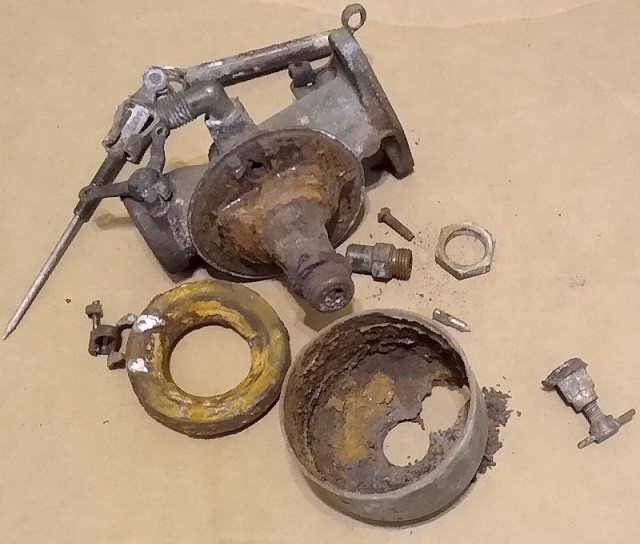

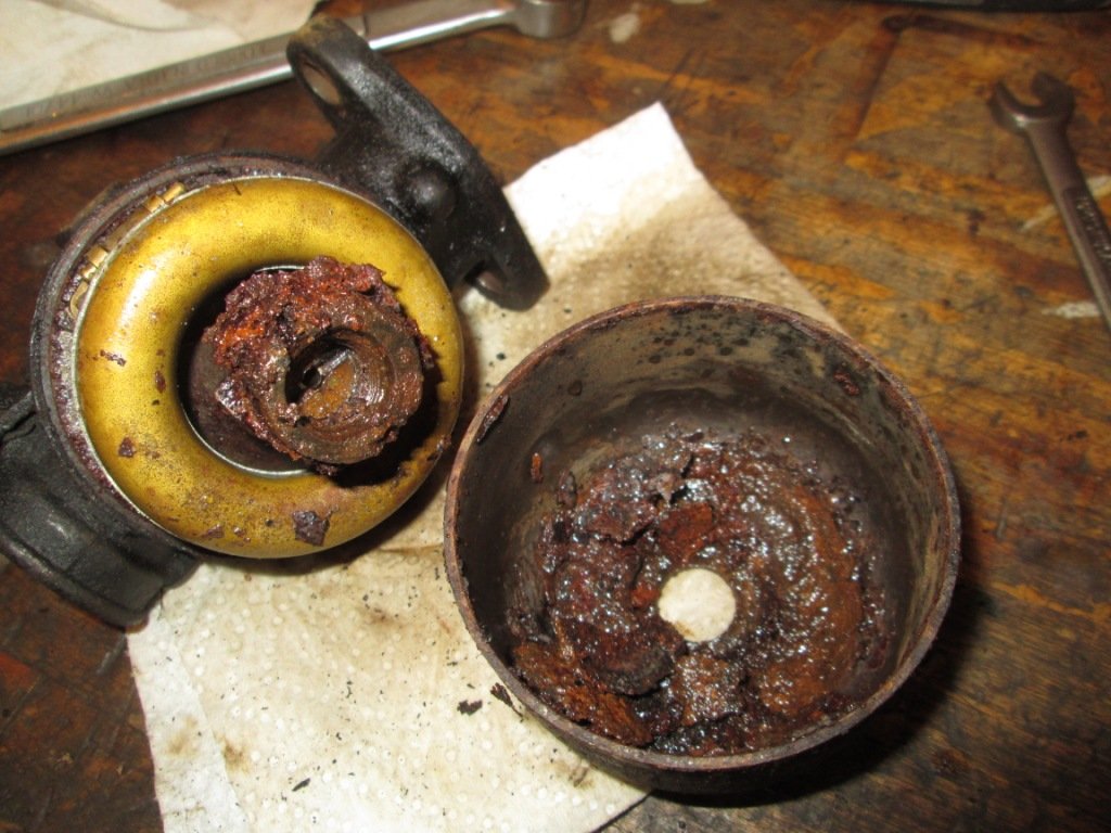

Working on a family owned TT - fellow was having some fuel issues - I think I found the problem !

How is that possible that he has FUEL PROBLEMS ??!!??!!

I've gone through dozens of carbs in 40 + years & that's got to be one of the worst !!!

I'll restart the fight over using Sta-Bil or not...I bet if this person used it in the fuel for layup it wouldnt be this way. Mine never are. And the '94 quit having annual spring issues once I started laying it up with Sta-Bil.

This TT had been sitting in a shed untouched for 26 years - Gramps passed that long ago - believe it or not, I had it running in a couple hours WITH that carburetor - I even drove it in the fellow's parking lot !
Side note - all my "clear" gas gets Sta-Bil !
Yes, I did. N, S, N, S, N, S, etc.
This picture is also a warning against stupid hand cranking.
:D

Nice job on the coil ring, Steve ! Knarly looking wrist though !

...believe it or not, I had it running in a couple hours WITH that carburetor...
When I got my '23 touring I found a similar situation. The car ran, but the carb leaked, so I opened it up and found a sight much like that. The leak was because of holes rusted through the bowl. The guys who "restored" the car did a fair job on the body, but ignored the mechanics.

Love the way your mag ring turned out Steve. Definitely lots of work. Looks well done.
Posts: 7411
Re: What have you done with your T in February?
Post by Steve Jelf » Wed Feb 03, 2021 12:16 pm
Looks well done.
I'm just glad it tested OK. :)

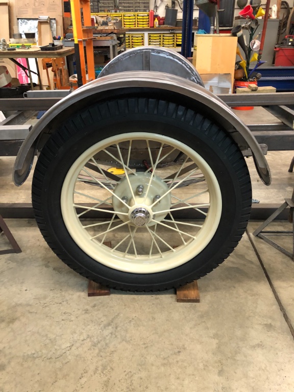

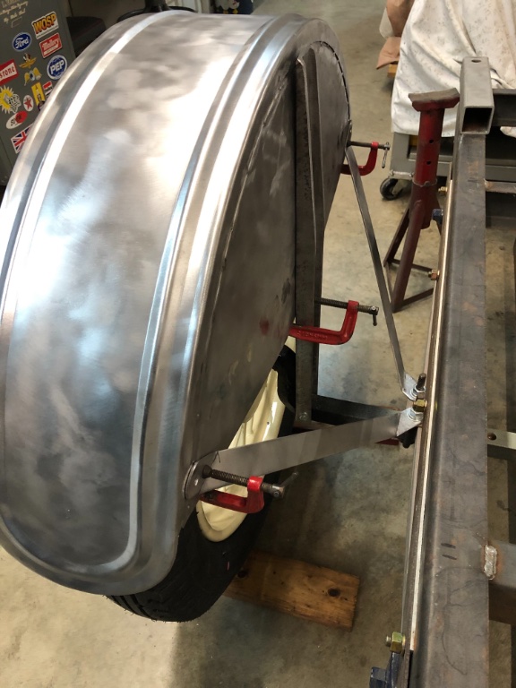

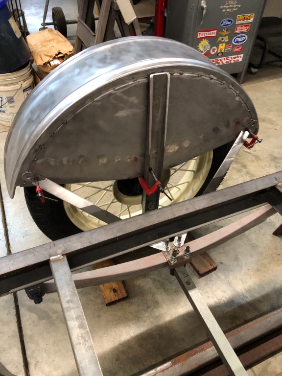

Well so far.., making progress here and there on the era/period correct boat trailer. Donnie and I got the axle mounted hugger fenders in pre mount.

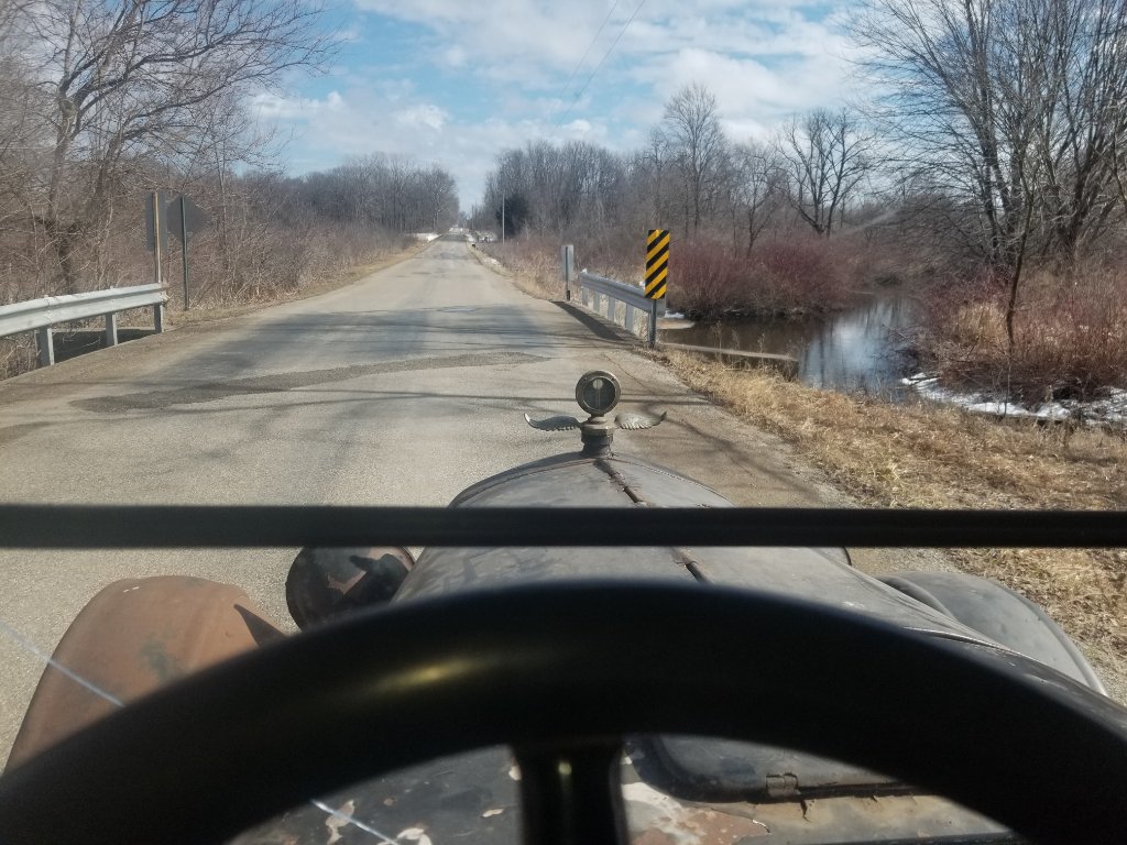

Well I have been having withdraw symptoms lately. Mud and rain was the weather this winter since I installed the RM brakes. Needing to do final adjustments it needed to be driven. Well I didnt do any adjustments, just checking for heat in rear drums and sevice brake and E brake. At 10 degrees there was no heat in RM bands so I took a little drive. I can adjust RM's when I have more traction and a little warmer conditions.
I think I may see some side curtians and manifold heater in my future.

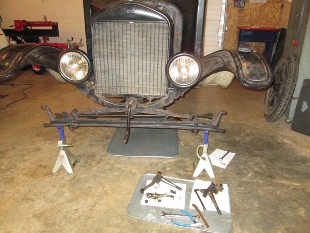

Not mine but the same TT that carburetor overhauled - this old truck was "rode hard & put away wet" ! Haven't got the rear wheels off yet - next task.

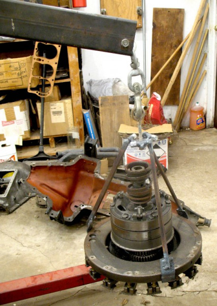

Post by Steve Jelf » Tue Feb 09, 2021 12:51 am

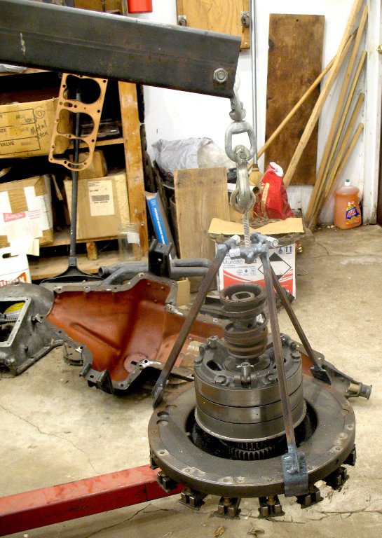

Gee, I actually accomplished something today. As the fleeting years bring increasing feebleness, I resort more and more to machinery in place of muscle.
The new piece of equipment I finished today is a magneto/flywheel/transmission lifter. It should ease the chore of getting the right magneto gap.

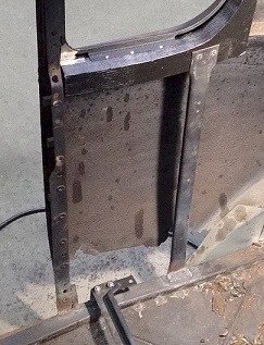

Post by varmint » Tue Feb 09, 2021 6:31 am
We finished cutting, priming and painting replacement wood for rear windshield and right stationary window on the '26 coupe.
Tacked 1-1/8" x 3/16" x 19-3/4" felt to rear window wood uprights.
Installed six corner window brackets (two made from stainless steel).
Mounted said wood for three rear windows with stainless, slot drive, flat head, #12 x 1" countersunk, wood screws after pre-drilling holes.
Mounted B-pillar to side window wood with stainless, slot drive, round head, #12 x 1-1/2" wood screws after pre-drilling holes.
Tacked wood to brackets and flanges with about fifty stainless #17 x 7/8" brads/nails.
Welded 8-) two brackets (made from scrap two years ago) at sub-frame and screwed top of each bracket to lower wood on side windows.

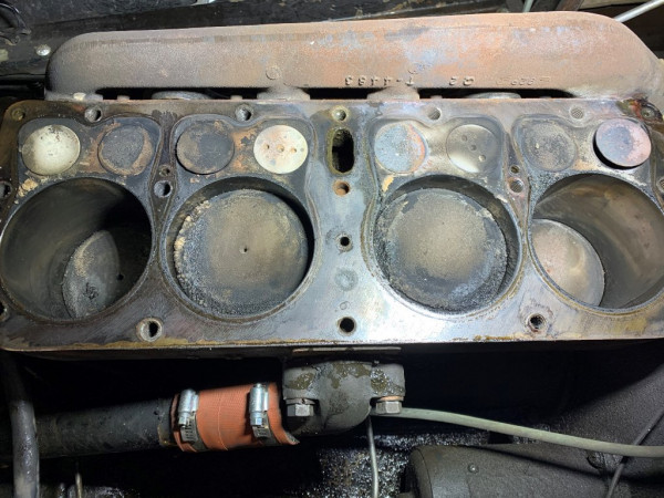

Post by Scott C. » Fri Feb 12, 2021 1:53 am

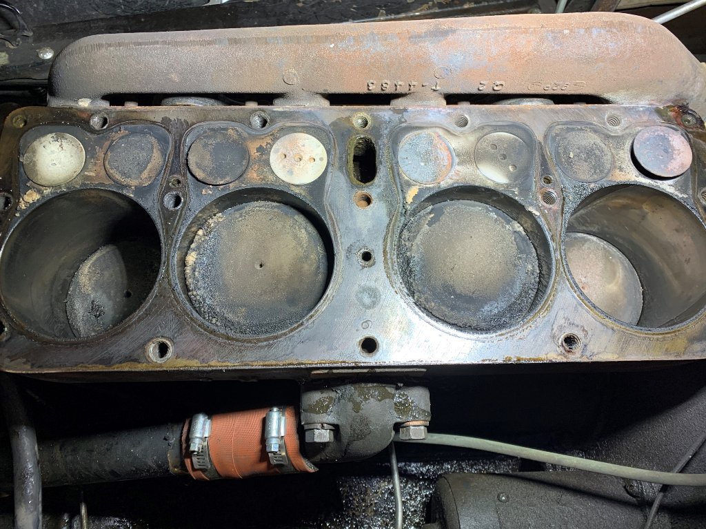

I pulled the cylinder head off the 26 Coupe to investigate why #3 cylinder was weak and found a burnt exhaust valve. After further inspection of other components I determined that it is time for a complete rebuild!!

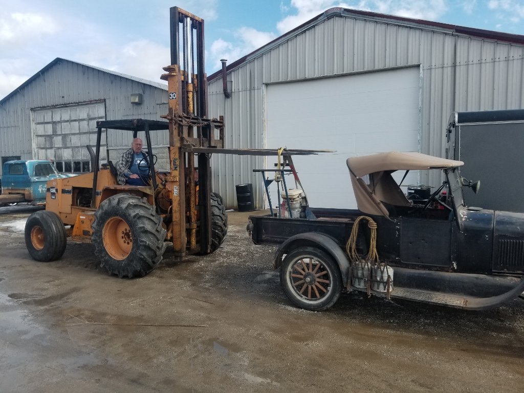

I think it hit 60 degrees today. I took the RPU and put it to work. Returning a concrete saw to a buddy. Nice drive without 4 layers of cloths.

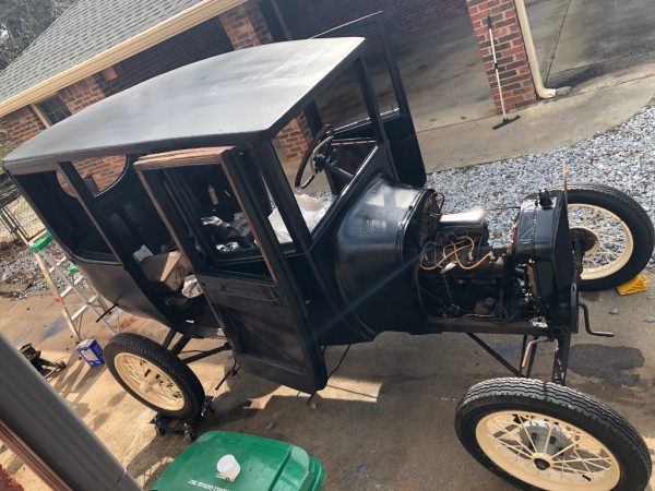

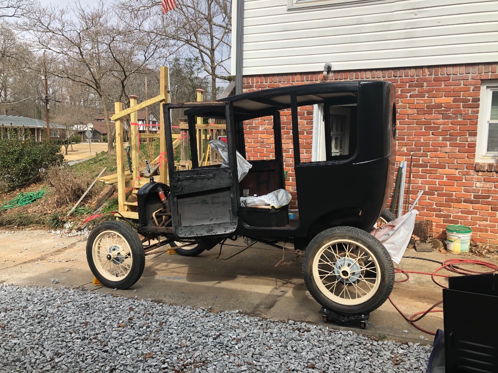

Post by Justbrett » Sun Feb 28, 2021 7:33 pm

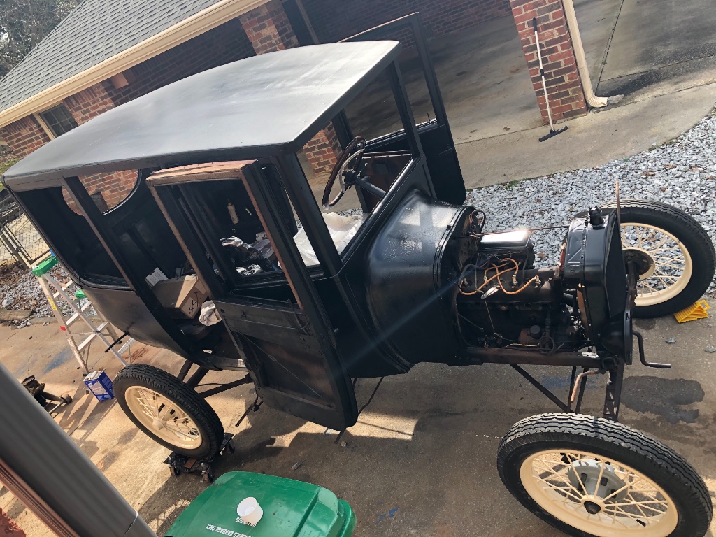

[image][/image]

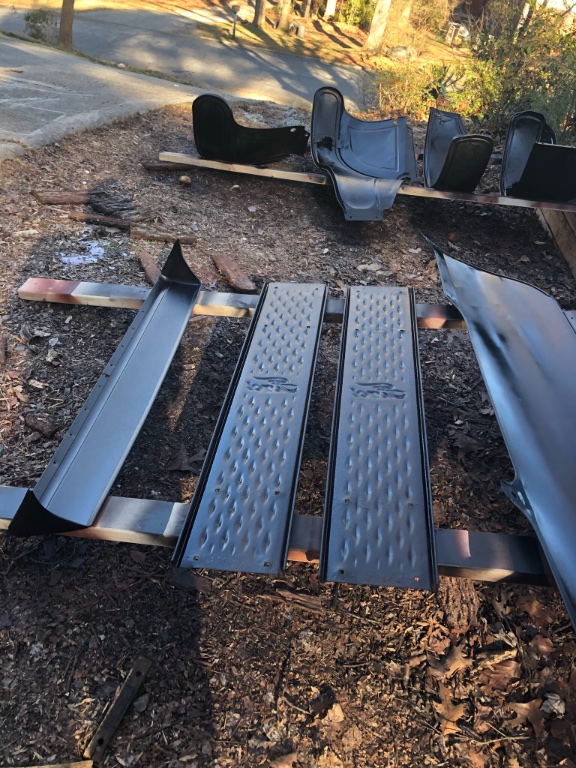

I cleaned, primed and painted 21 centerdoor...
Next is underbody inhibitor lube and reattach fenders and boards.

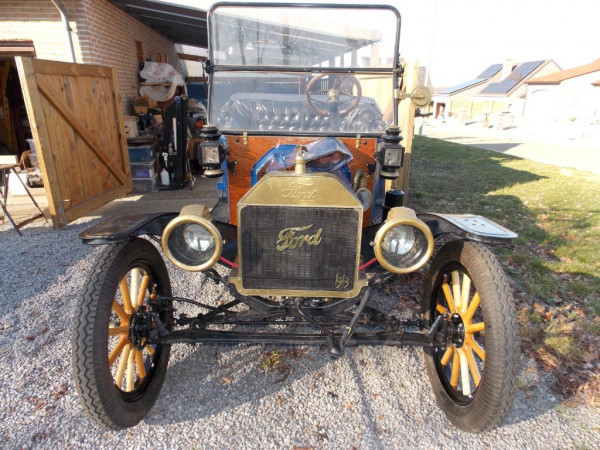

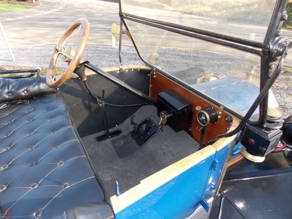

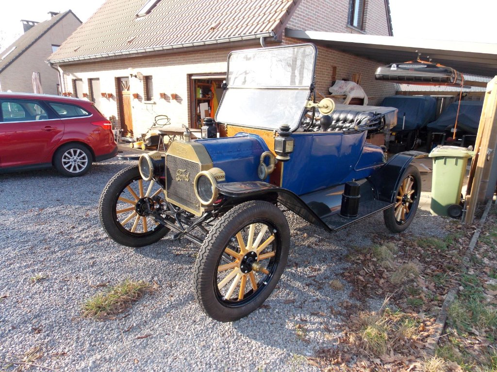

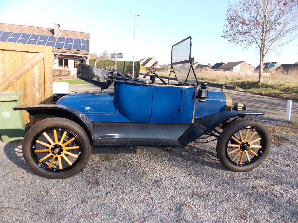

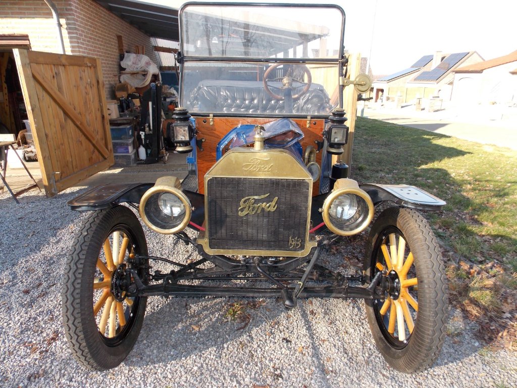

Finished the 1913 runabout.
Andre
Belgium

Congrats André! looking great.
