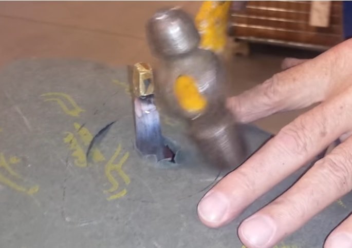

Post by TRDxB2 » Sat Feb 13, 2021 2:09 pm
I would use it - watch this video to see how to make it with a ball peen hammer - gently. No cutting needed https://www.youtube.com/watch?v=9Lsn6B6RsNQ

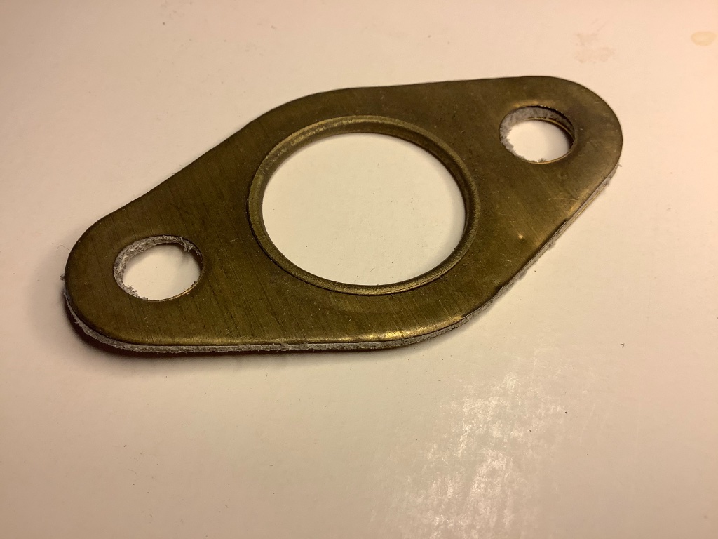

Post by Original Smith » Sun Feb 14, 2021 12:26 pm
Use the type of gasket Tim posted. They can be used over and over. I like the copper covered type.

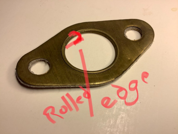

Post by Dropacent » Sun Feb 14, 2021 12:52 pm
If you look close, the metal edge is rolled, to make a nice seal. Remember , gasoline constantly flows through this joint. Do you really think just any material( cardboard) is a good seal? IMHO real gasket material would be a fine substitute, but not just a piece of unknown cardboard.

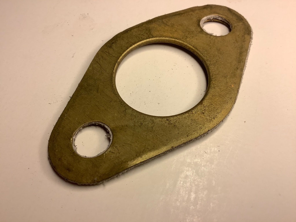

Post by Dropacent » Sun Feb 14, 2021 12:56 pm
Just a small point. I believe they are actually brass, which with ford is a cheaper material. I can measure the brass thickness if anyone actually cares. It’s very thin. The core is asbestos.
