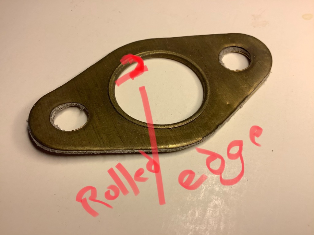

I’ve always wondered why these were used originally. FoMoCo was the pinnacle of K.I.S.S. There must have been a good reason back then, otherwise they would have punched out paper gaskets. I’ve given these out as gifts for years, but just enough for me remain here.

If you look close, the metal edge is rolled, to make a nice seal. Remember , gasoline constantly flows through this joint. Do you really think just any material( cardboard) is a good seal? IMHO real gasket material would be a fine substitute, but not just a piece of unknown cardboard.

Just a small point. I believe they are actually brass, which with ford is a cheaper material. I can measure the brass thickness if anyone actually cares. It’s very thin. The core is asbestos.
