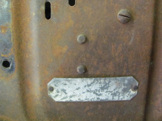

Cannot find any pics and can’t go anywhere to look. Which side of the firewall is it attached? It is so low I cannot imagine it goes behind the head on the engine side?
Posts: 4089
Re: 26/27 patent plate
Post by DanTreace » Sun Feb 14, 2021 9:35 am
Center low on the cowl panel, inside compartment, you will find two small holes punched there for the rivets to secure the patent plate.

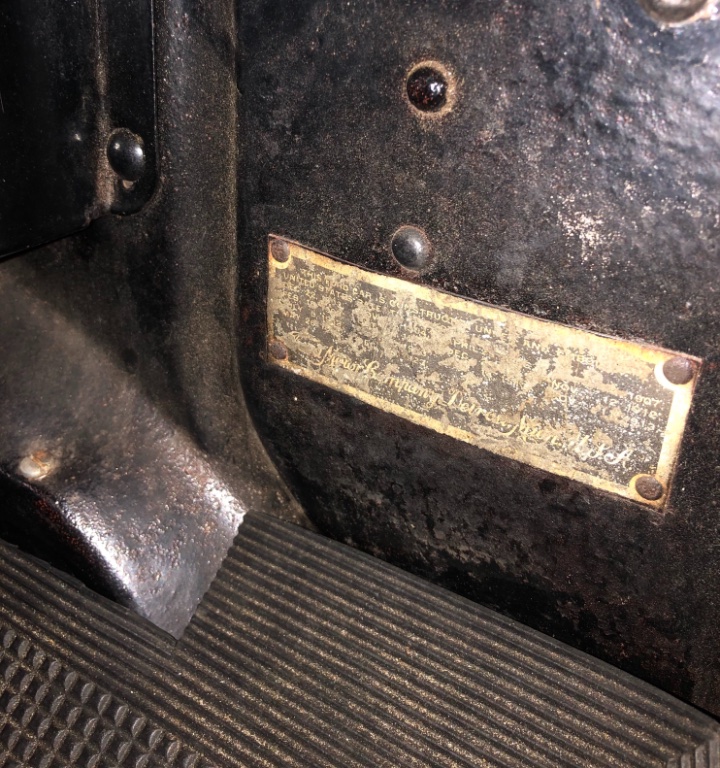

Post by Original Smith » Sun Feb 14, 2021 11:05 am
Not commonly known, the same patent plate is used in 1925 on the inside right side of firewall. It is held on by two cowl lacing rivets.

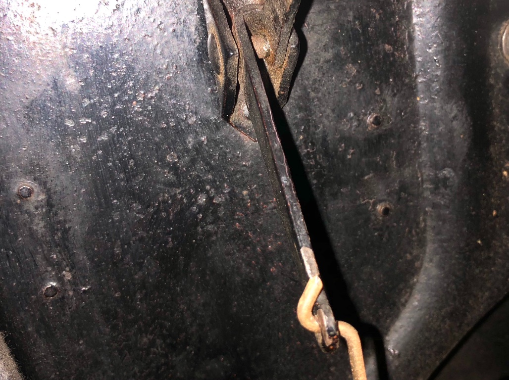

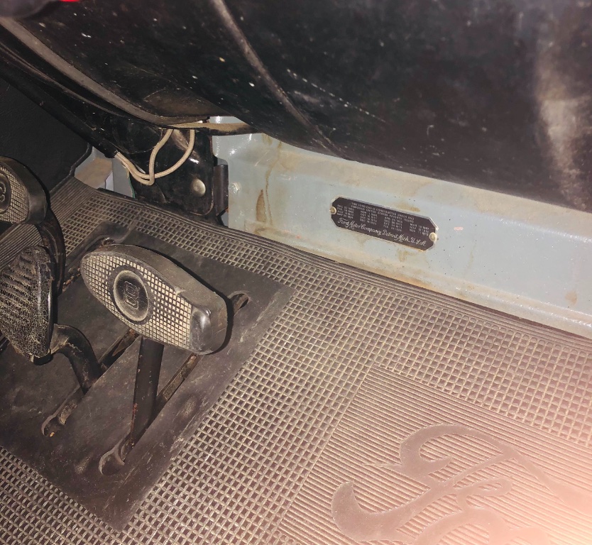

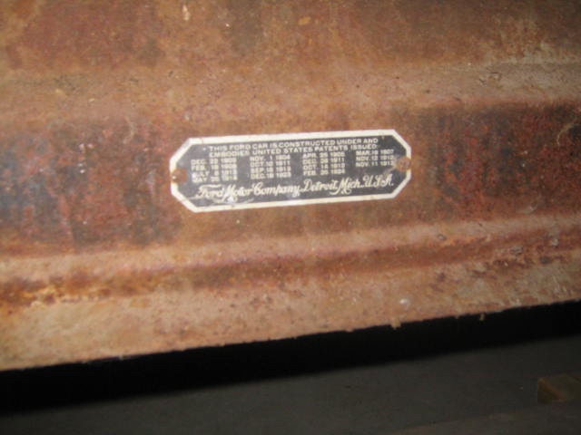

Post by DanTreace » Mon Feb 15, 2021 9:47 am
Larry
All the later original patent plates are held with 'drive screws' or else a type of std. rivet.
Have not seen 'tangs' of a split cowl type lacing rivet against the engine side of the firewall. Here are some originals, 1924, 1925 and 1926, all use the same rivet with a blunt flatten or slightly rounded rivet end, never split rivet tangs folded into the metal firewall.
