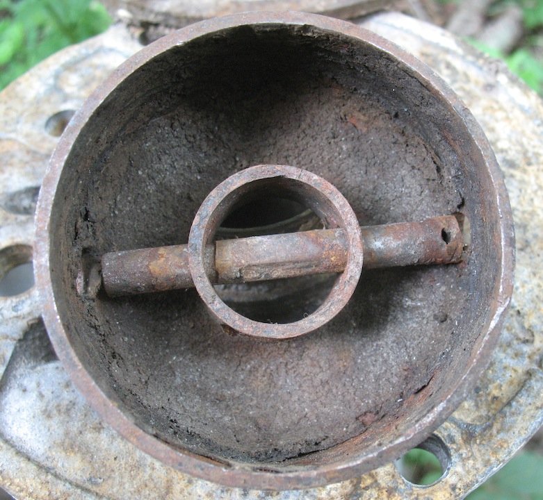

Post by Steve Jelf » Sun Feb 14, 2021 12:45 pm
Here's a picture of what Larry said. The parts are in poor condition, but they serve for illustration. The small hole in the pulley (left) is for punching out the pin when it needs to be removed. It is, or should be, too small for the pin to fit through it. The large hole (right) is for installing and removing the pin. A cotter pin in the end of the crank pulley pin keeps it from backing out of the large hole. You're right, the pin is not tapered.

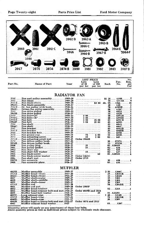

Yes, there are different sizes.

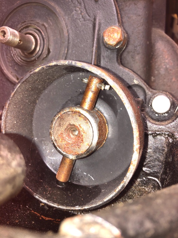

Ford Service instructs and shows photo of cotter hole in the crank pulley pin, at the big hole end. Place the crank pulley pin into the large pulley hole, with the cotter hole of that pin up, facing the large pulley hole.
That cotter keeps the crank pulley pin from protruding out, wearing the fan belt, or worst, slipping out.
Although the pin is driven in and should be tight fit in both the crankshaft and pulley holes, the big crank pulley pin can get loose, wiggle, and move. Lots of stress on that pin with hand cranking.
