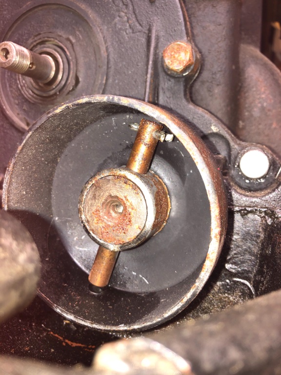

- Posts: 7413
Re: 23T crank pulley pin
Here's a picture of what Larry said. The parts are in poor condition, but they serve for illustration. The small hole in the pulley (left) is for punching out the pin when it needs to be removed. It is, or should be, too small for the pin to fit through it. The large hole (right) is for installing and removing the pin. A cotter pin in the end of the crank pulley pin keeps it from backing out of the large hole. You're right, the pin is not tapered.
So, with the pulley removed, I should have to tap the pin in, and it just goes up to the small hole, but not in it?Original Smith wrote: ↑Sun Feb 14, 2021 12:16 pmThe pin does fit tightly in the pulley. Many don't, and have to be knurled to fit properly. Don't mess with the small hole in the pulley. That is to keep the pin from coming out. The cotterpin in one end keeps the pin in place at the large hole end of the pulley.
tommyleea
Topic author - Posts: 151
- Joined: Thu Sep 24, 2020 3:11 pm
- First Name: Tommy
- Last Name: Russell
- Location: Missouri
Thanks..Thanks for the picture.Steve Jelf wrote: ↑Sun Feb 14, 2021 12:45 pmIMG_3836 copy.JPG
- Posts: 7413
Correct. The small hole is only for a punch to drive out the pin when you remove it.
