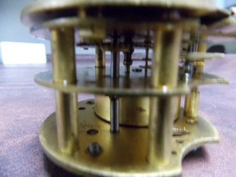

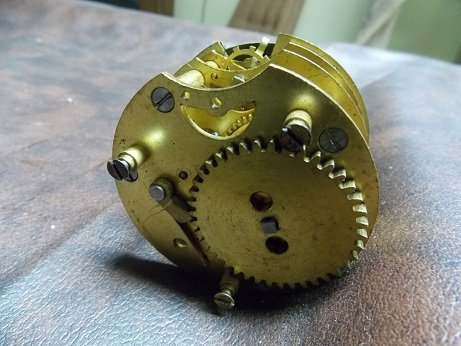

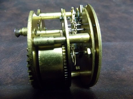

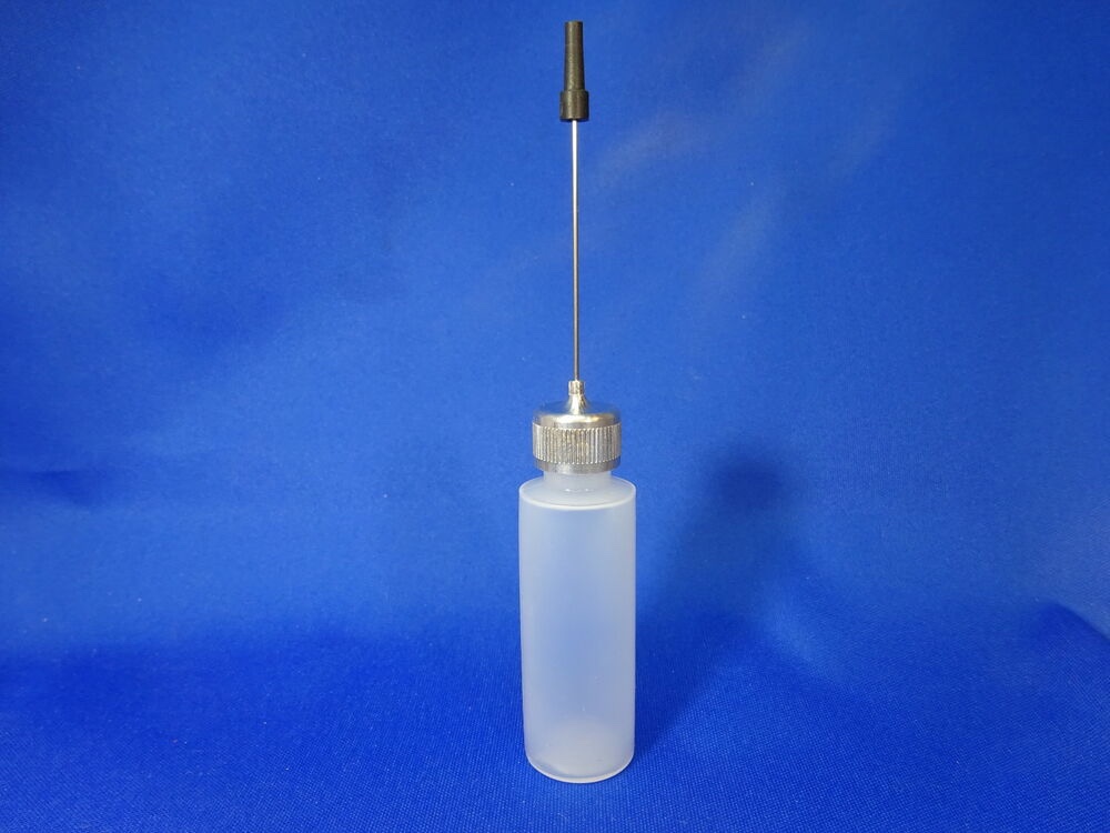

Thanks to Colin’s superb pictures of the open movement of his clock, I now see how open the movement is. With easy access to all the gear pinions, instead being closed and having inaccessible interior gears like a watch, it would be very easy to apply one drop of clock oil to each pinion with a needle applicator. You would need to buy an applicator and a small bottle of the oil and pour the oil into the applicator to apply. Jim Patrick

When you oil the clock pivots be careful to to put too much oil. A lot of oil will attract dirt. The best way is to get a piece of wire. Flatten the tip of the wire with a hammer. then put a drop of oil on a piece of cardboard, dip the flat end into the oil and just touch it to the pivot points. This will allow the capillary effect to draw in the oil around the the pivot without putting too much. Most applicators that come with the oil (even the ones that look like a needle) put out too much.
