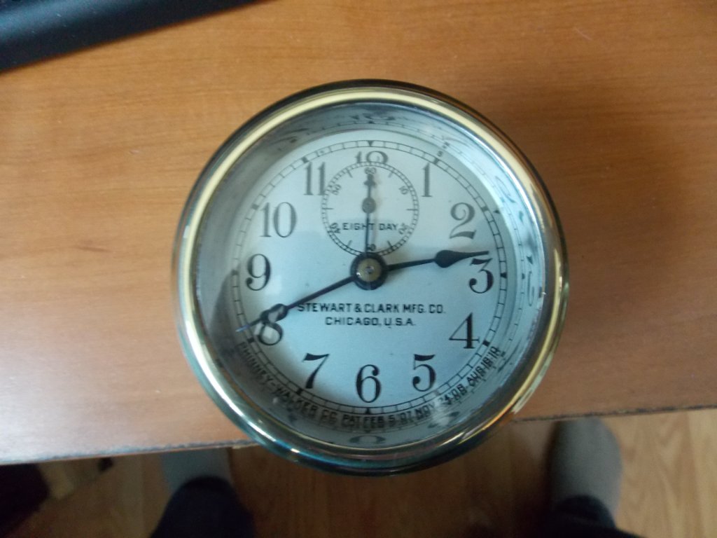

Specifically for rim wind, finger set dash clocks, are there any gotchas or best practices? For example, only set the time using finger against the minute hand with light pressure in a clockwise direction? Okay to turn counterclockwise? Okay to set the time while the clock is running, or should the escapement be stopped? How often does the movement need to be cleaned and/or lubricated (no jewels, only brass pivot holes)? Thanks!

As a rule I always turn my clock hands forward minute hand only, Mine is a 1910 brass rim wind I give it 4 turns of the rim which gives me 5 days. After 50 years in the car it started to slow down ,We would only get 2 days out of a wind, so I opened it up and it is a very simple clock . Oil with clock oil which I use on my Cuckoo clocks. It now runs a full eights days on a full wind and keeps perfect time.

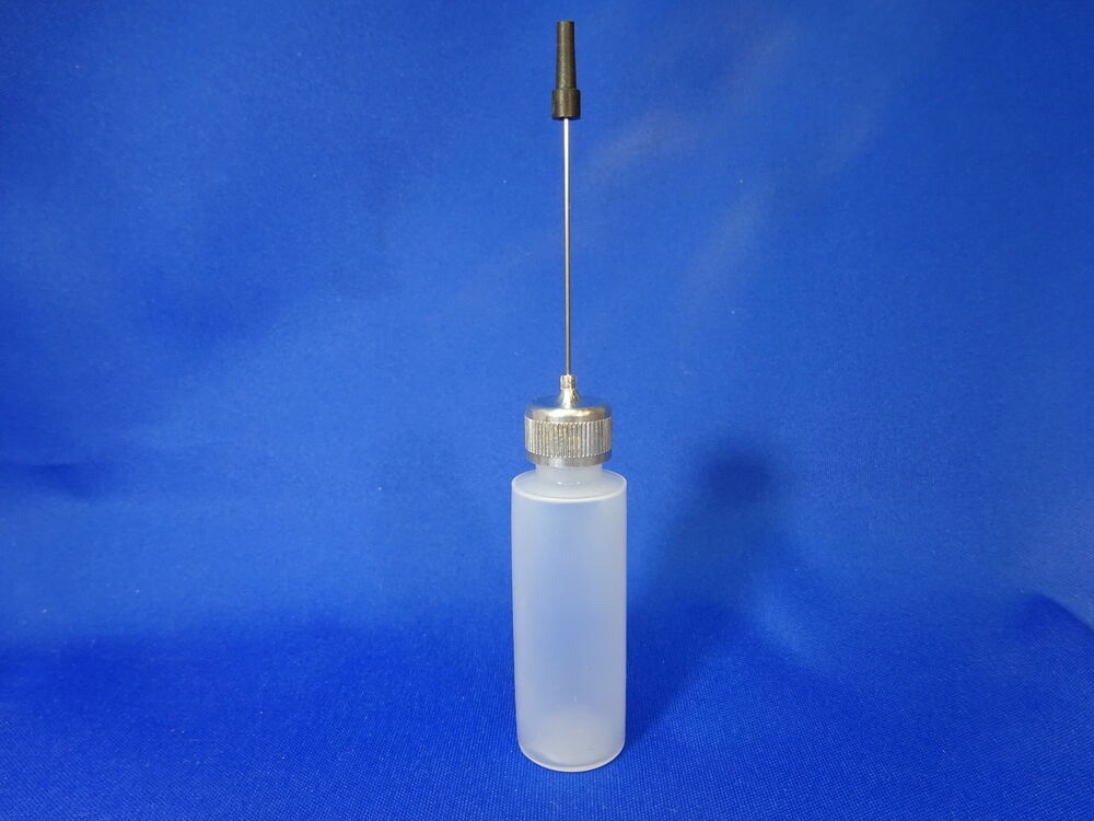

Thanks to Colin’s superb pictures of the open movement of his clock, I now see how open the movement is. With easy access to all the gear pinions, instead being closed and having inaccessible interior gears like a watch, it would be very easy to apply one drop of clock oil to each pinion with a needle applicator. You would need to buy an applicator and a small bottle of the oil and pour the oil into the applicator to apply. Jim Patrick

When you oil the clock pivots be careful to to put too much oil. A lot of oil will attract dirt. The best way is to get a piece of wire. Flatten the tip of the wire with a hammer. then put a drop of oil on a piece of cardboard, dip the flat end into the oil and just touch it to the pivot points. This will allow the capillary effect to draw in the oil around the the pivot without putting too much. Most applicators that come with the oil (even the ones that look like a needle) put out too much.
