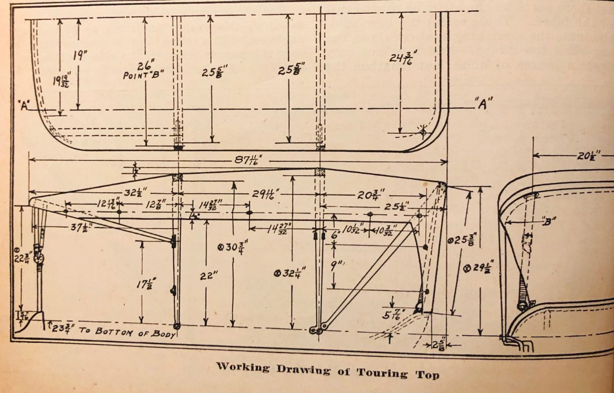

Re: 21 touring rear top strap question
There should be tow leather adjustable straps from the rear bow to the bracket which holds the saddle when the top is down. Be sure you have the correct top. The later one man tops are different. Your car should have the two man top with 4 bows. One in front, one in the rear, and the two in the middle should go straight up. See diagram attached.

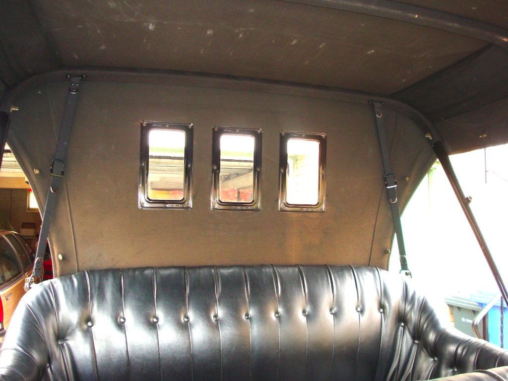

If you want to do it right:
If your car has the L shaped top saddle brackets, all that is needed for the curtain are the two, black cotton webbing straps with D-rings on one end and footman's loops on the other end.
The two "extra" straps are not factory correct and not needed.
Below is the top on my dad's 1917 touring. He installed it in 1951 using the original for a pattern. This winter, he is actually in the process of re-doing the top.
The D-rings, buckles and footman's loops are original to the car. He had made new cotton webbing straps in 1951 using the originals as patterns (he bought the webbing from a local saddle maker). About five years ago, he gave original hardware to to R.V. Anderson and he made up new straps (R.V. has the correct black webbing, rivets and the metal end-caps).
The one man top uses adjustable two piece straps made from black cotton webbing, just like Erik's photo shows. Cotton began to replace leather late in 1914 but leather was still used on some cars well into 1916. By the time of the "black era" rectangular top sockets in 1917 leather top straps were a thing of the past, except on the saddles.
