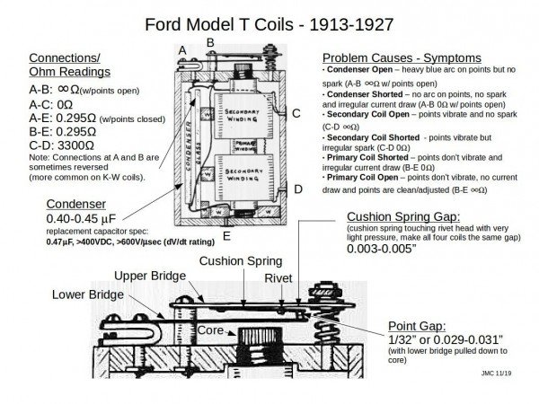

I prefer this chart that John Carter developed for simple multi-meter tests:
Also a couple years back I made the following. I need to update it, but you may find it helpful.

Matt, heaps of good info in your attachment.
