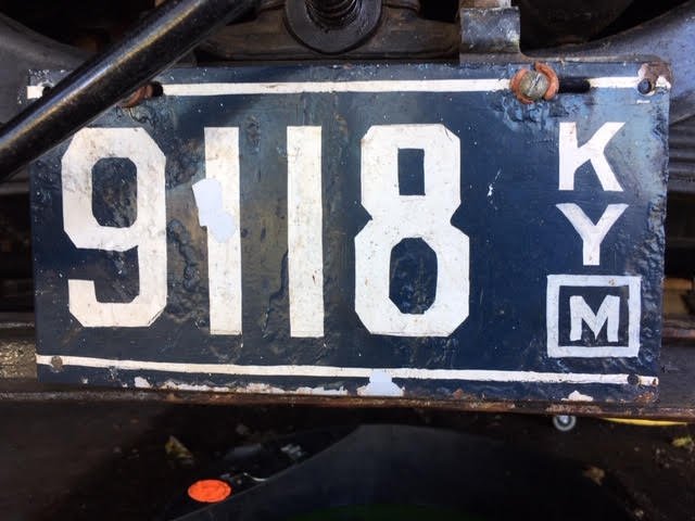

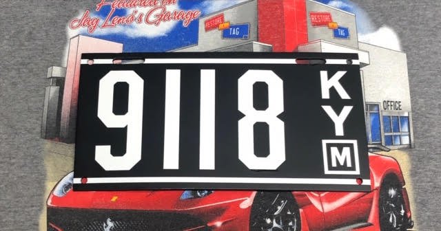

Shawn with Restroe-A-Tag (www.restoreatag.com) restored my '12 KY plate. He does prefer to leave the back to be untouched in case there was ever question of the plates authenticity. If he can do this, I'm sure he can get the patina you're looking for.

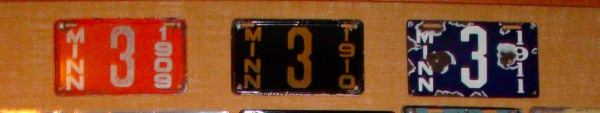

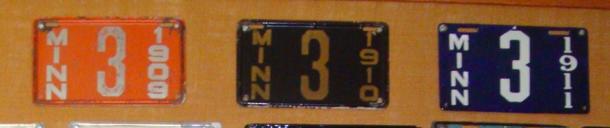

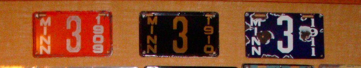

My father restored the Minnesota 1911 number three license plate below and is currently in the process of restoring a second one.
In 1911, the original owner drilled two holes, one to the right of the "3" and one to left, creating major chips, instead of utilizing the factory holes to mount the plate on the back of the car,
He filled in the chips with JB Weld as level as possible and then sanded the fill. He followed with body glazing/spot putty.
For the background paint, he got a digital color scan match packed in a rattle can at a local automotive paint supply.
The numbers and lettering he did by hand.
NOTE: He only painted the areas that are filled/repaired, not the entire plate.
First photo is before.
Second photo is after.
I apologize for not having better close-up photos. Both were cropped from larger photos that I happened to have in my computer.

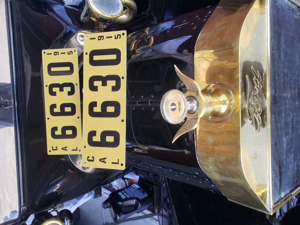

I had a sign maker exactly replicate my damaged 1915 CA plates. I carry the originals under my back seat in the event some authority needs to see them.
