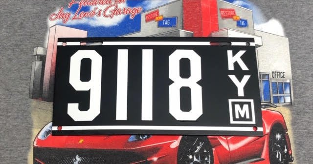

Shawn with Restroe-A-Tag (www.restoreatag.com) restored my '12 KY plate. He does prefer to leave the back to be untouched in case there was ever question of the plates authenticity. If he can do this, I'm sure he can get the patina you're looking for.
