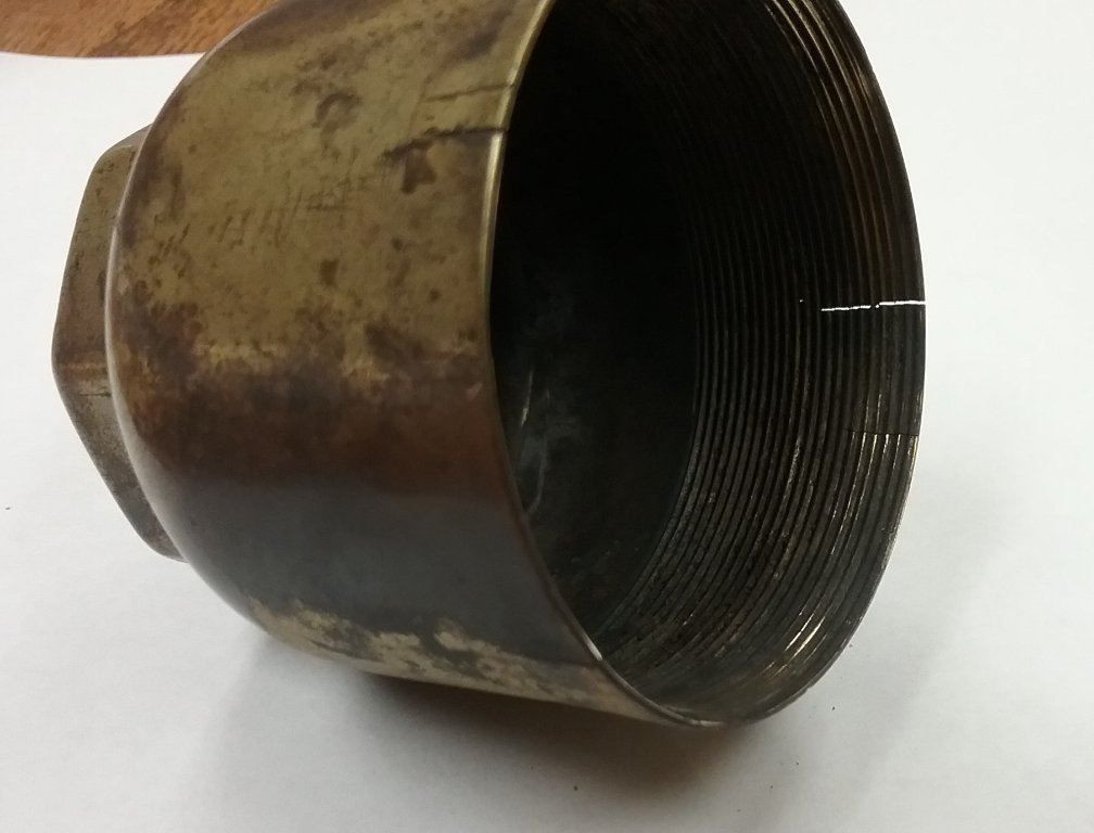

Re: Repair small cracks in hubcaps headlight rims
Nick, the brass cracks because it has not been fully annealed to relieve stresses from the pressing. Each side of the crack will sit a little proud of the finished surface. On the headlamp rims this should be gently beaten down against a buck, so the solder can be applied on the inside. It will fill the crack and be almost invisible after finishing/polishing. This can't be done on the inside of the hubcaps because of those fine threads. You have nothing to loose by trying, but a set of new reproductions may be a better answer.

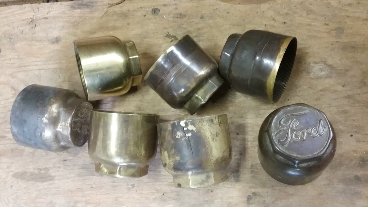

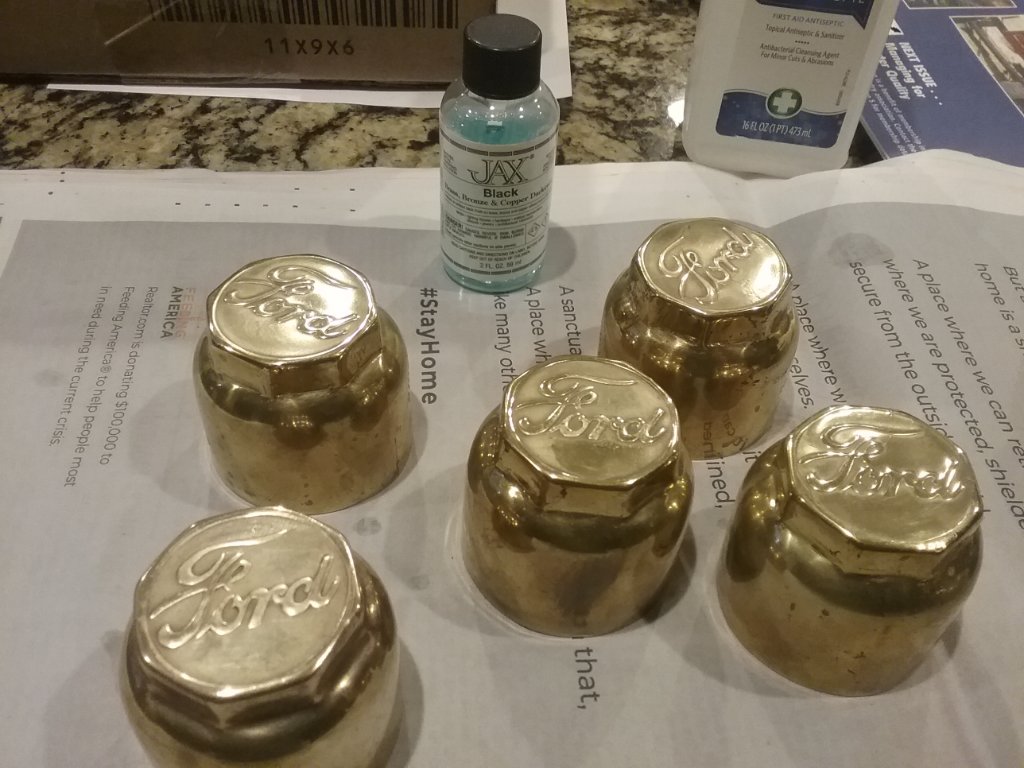

Allan-
Here is view of my ugly hubcaps:
I sent them all to Bill and asked him to restore the best 5, and send back the rest.
Here is a close up of one:
I was interested in the various silver solder repair, but since these original hubcaps are scarce as hen's teeth, I wanted to send them to someone who actually knew what he was doing!
