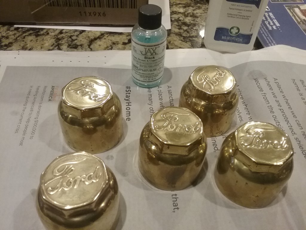

Allan-
Here is view of my ugly hubcaps:
I sent them all to Bill and asked him to restore the best 5, and send back the rest.
Here is a close up of one:
I was interested in the various silver solder repair, but since these original hubcaps are scarce as hen's teeth, I wanted to send them to someone who actually knew what he was doing!

Post by Craig Leach » Mon Mar 15, 2021 10:30 am
