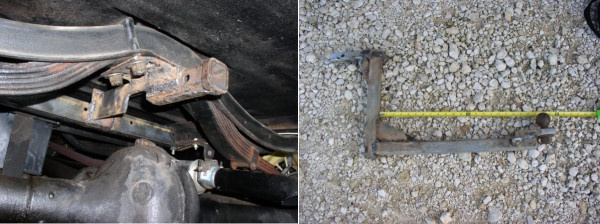

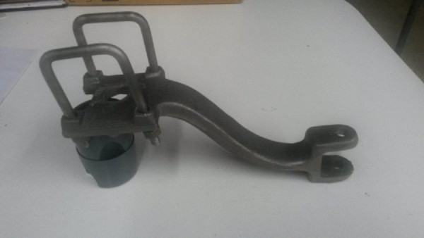

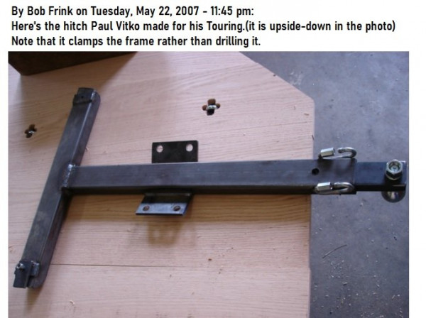

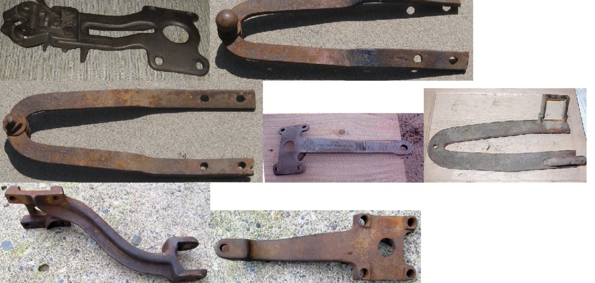

- Posts: 6587
Re: Model T hitch question

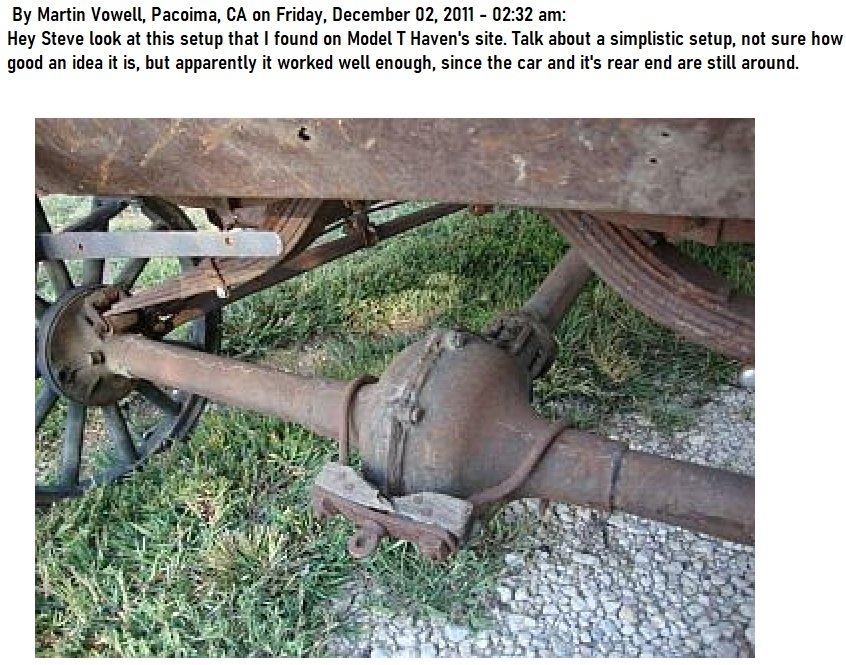

Here is one that reflects part of your thought I thinkSusanne wrote: ↑Sat Mar 20, 2021 12:40 pmMy thoughts on this is fab up a multi-point hitch, 2 coming from bolted collars around each axke hald at the pumpkin, 2 bolted to the frame, almost like a 3 point (or in this case, 4 point) hitch geometry... I would NOT trust either the spare tire carrier (as it wasn't designed for those kinds of dynamic loads) or the rim lugs... you'd bend stuff up and break parts - even with a light trailer, that's a few hundred pounds of push/pull jerkiness in directions none of it was made to do.
Actually, you look at most of the hitches in the above example that go from the upper spring perch etc., most have a second point of attachment to the body / frame / etc... That poor spare carrier will become a pretzel.
http://www.mtfca.com/discus/messages/17 ... 1322924618 photo below More links to pictures and ideas. Some show the same hitches hitches from different angles
http://www.mtfca.com/discus/messages/50 ... 1226098461
This may be the ticket click here to see the install http://www.mtfca.com/discus/messages/29 ... 1182381023

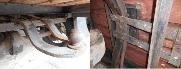

- Posts: 7292
I have seen one which was made from 3" wide flat steel, Blacksmithed into an oval shape and attached to the rear axle housing. At the front, a U bolt clamped it to the drive shaft housing just forward of the rear driveshaft bearing spool. Two other U bolts clamped it to either side of the pumpkin. The rest of the oval was carried rearward to be the hitch point.Unless there is quite a deal of weight involved in the tow, It seemed to be a neat way to do the job. I wish it was something I saw after phones became cameras!

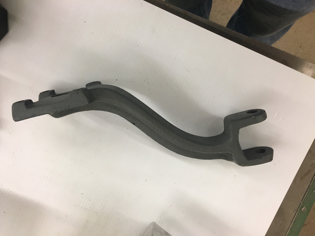

- Posts: 6587
Looks like several were available an all sold sold
https://mtfca.com/phpBB3/viewtopic.php? ... ch#p110835

Yes, that's what I was kinda sorta exactly talking about. It's like a tractor wher the pull draw is tied to the axle housing...TRDxB2 wrote: ↑Sun Mar 21, 2021 1:23 am
The upper part of my new-fangled patent medicine show spitzermatic hitch™ would attach to the corners of the frame, also terminating in a similar wishbone apparatii. The third member would incorporate ball joints on which the 4 arms would attach on a sliding plate as to not lock the upper and lower arms into an immovable object... like a tractor hitch it would have to be entirely flexible, to where the "wishbone arms" remain the same length but move independent of one another... on the back part of the plate would hence culminate in a flexible pintle-hook style hitch...
