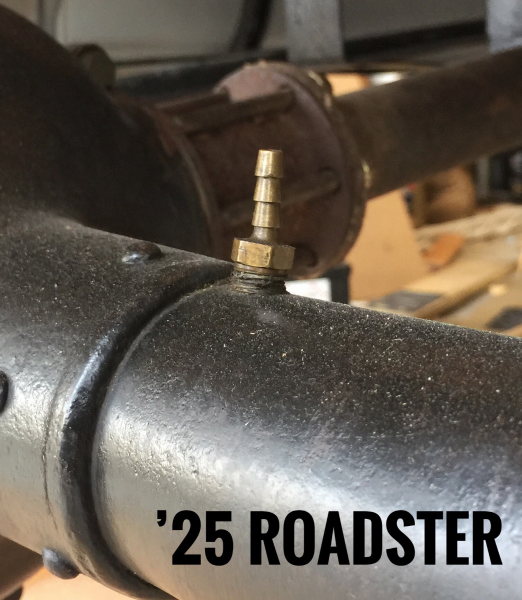

Rear Axle Mystery Part
Post by Redleg » Sun Mar 10, 2019 6:04 pm
T Teammates,
Can someone reveal the function of this modification on the rear axle?

.....an air vent to hopefully aid in the prevention of gear lube gradually leaking out thru' axle bearings due to rear end temperature change expansion.

Looks like a homemade breather for an axle that has had modern seals installed.
With that hose barb, you could run some rubber hose to a location of your choice.

Yes, home made breather. I'd attach a long hose with a loop in it and attach the upper end up high to prevent water entering the rear end.
