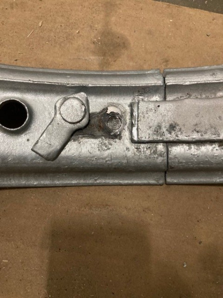

Problem 1 is my 21 inch rim lock is now broken off see picture. What should I do to fix this? Problem 2 is that all my 21 inch rims are galvanized and the rim locks are frozen in place and no longer turn. I might be able to file down the soft zinc and get them to turn again but suggestions are welcome.

Re-rivet it back together & they're split to accommodate tire installation & removal.

For the broken one it has been suggested to just weld the broken piece back on and not use the split rim feature. I've never had rims like this will that work when putting the tire on? Just use regular tire irons and horse it on like a 30 x 3.5 non-split?

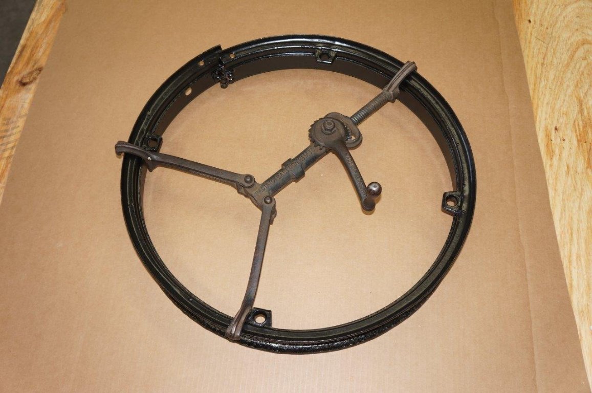

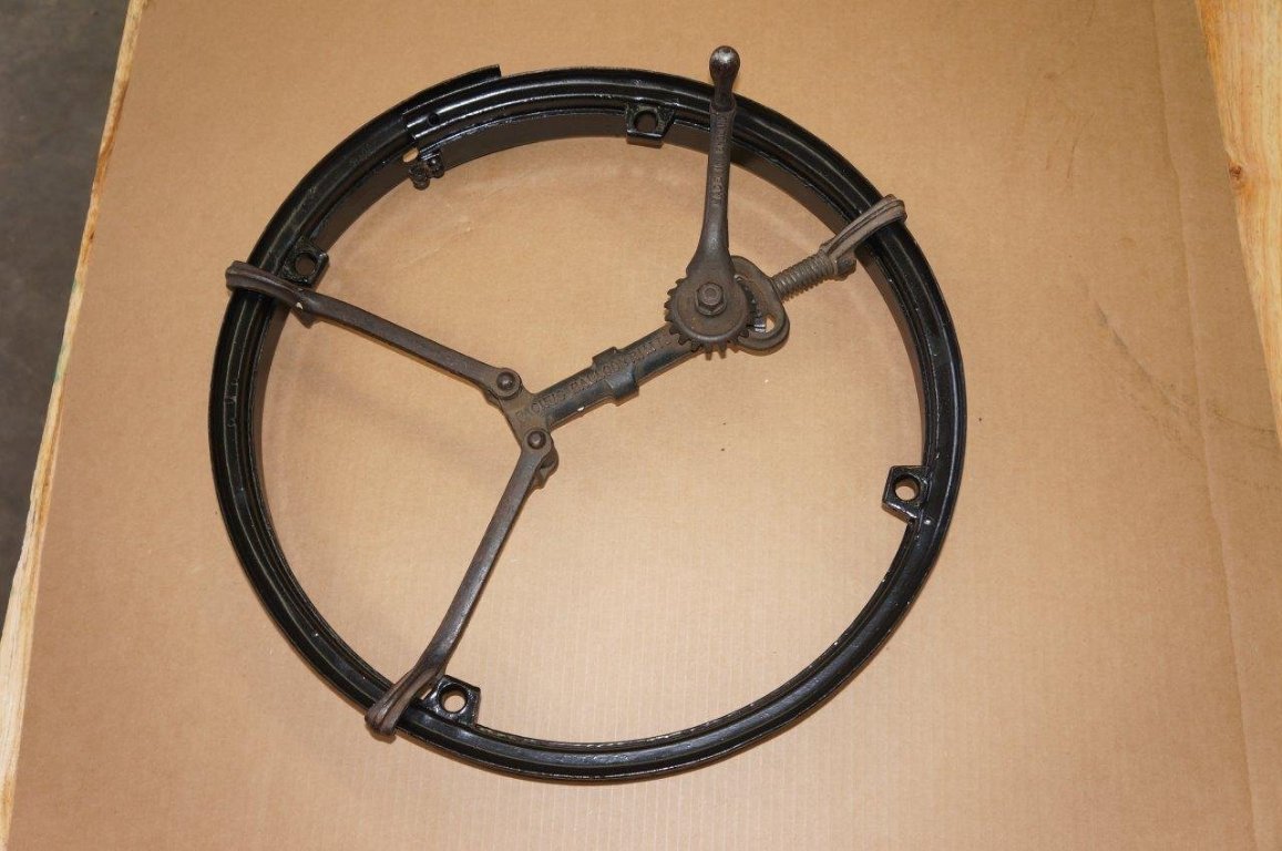

Here are a few photos of the split rims on my Canadian Tudor. These have the hinge-style lock that Allan mentions.
Once the tired is inflated and the rim is fitted to the wheel I don't think the pin is that important.

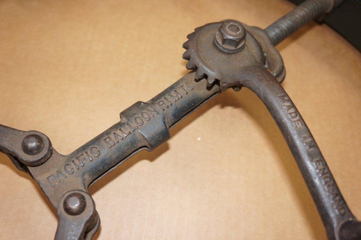

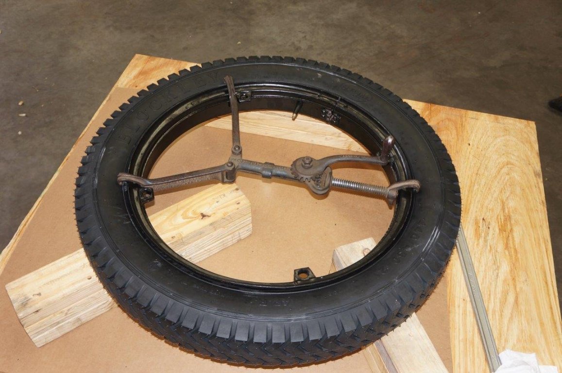

The spreader tool is not essential but it makes it a lot easier. It's designed to pull the rim in to fit the tyre & tube and also to push the rim back out. I think I used a bottle jack and a piece of timber cut to the curve of the rim before I acquired the rim tool.
It might be worth putting an ad in the classifieds to see if someone would sell you one. I'm sure there are a few guys with more than one of these.

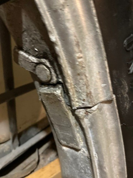

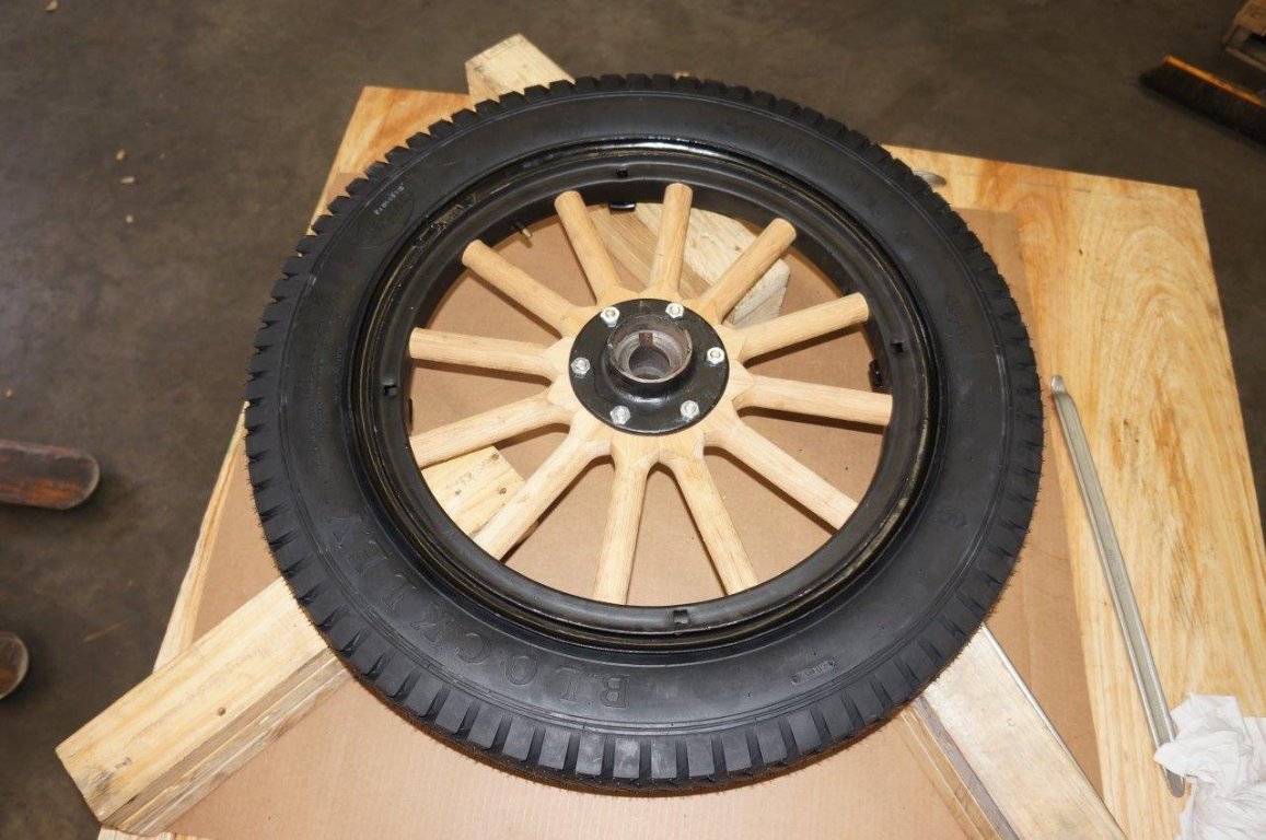

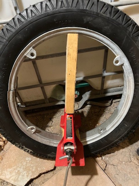

I just finished 2 hours of misery with a scissor jack and blocks of wood trying to get the lock and the ends to align. I had it ok with a slight mis-alignment but it was out of round enough so the wheel would not go in. Back to the drawing board which made it worse. Multiple broken screw driver tips and utter frustration. A spreader has to be a better than this.

pressure at just two points opposite one another will surely result in an egg shaped rim. The two half circles of timber mentioned in Johnny's post would help stop this. Note that the rim spreader pulls at 3 points, not just two.
From the looks of the rim joint the rim could have had some attention prior to the galvanising. The ends need a good 'tidy up' so that each side is at least the same shape. Just as all panels should be fitted before painting, so should the rims be worked on before plating. Too late for that now, but any replacements could be done this way.
Hope this helps. Allan from down under.

As a safety precaution - I would NOT completely air up the tire on any split rim without it being secured to the wheel or cage - I've witnessed a rim lock failure during inflation !

Ignacio, So you are down to having to fix one more rim in order to have a rolling chassis with tires. The last rim has the broken rivit at latch in frist picture? Before you replace the rivit make sure the latch is flat. The picture shows that the edge of the latch has been bent down at the rim up turn, most likely from a prior owner's errant hammer blow. This is probably why you have had such a hard time with that latch. Make sure that the latch can turn on the new rivit and you should be ok. You have come a long way with your project and it is looking good, more T parts saved from scrap.

If you are running 21” split rims you should look into one of these.
viewtopic.php?t=521
Works with out bending the rim. Dan

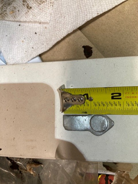

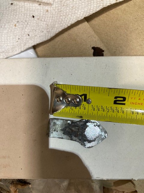

So the top of the lock pivot looks like it is 1/2 inch and where it goes through the rim it is 3/8 inch. It might be possible to drill something in the center of the stump in the rim and thread it in to act like a new pivot?

The part in the rim won't be thick enough to take many threads. You could weld a piece of round stock to broken part in rim and drill a hole in the latch for round stock to pass through. Keep as short as possable and drill a hole in round stock for a split pin to retain latch.

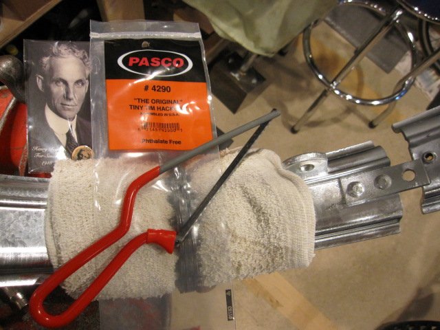

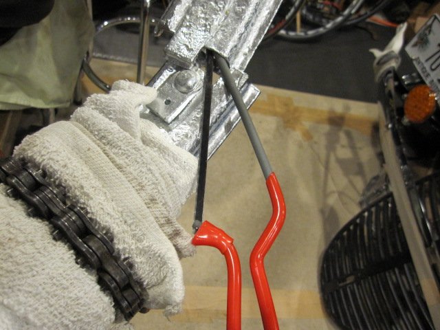

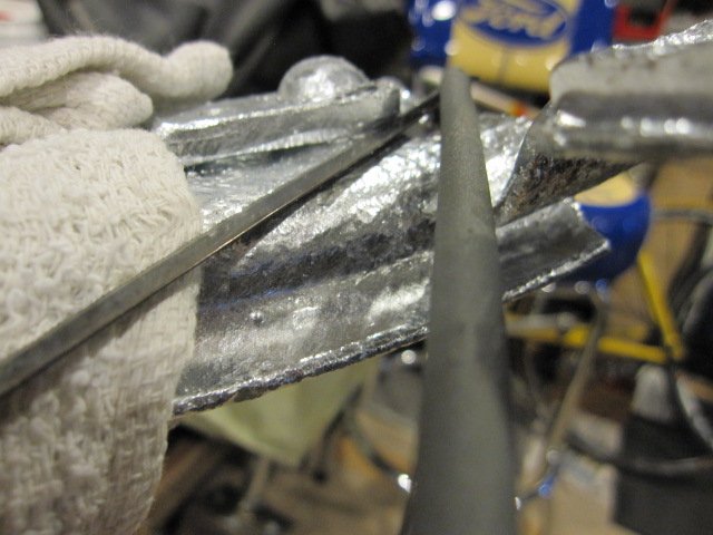

Ignacio, Got this little hack saw that worked great removing any galvanizing build up on my rim locks. Able to cut between the lock and rim area to get all mine moving. A single larger hack saw blade gets into some of the area's as well and a small little chisel to knock out the build up. Hope this helps.
I got this @ one of our plumbing supply stores, its a PASCO tiny tim hacksaw #4290, hey I didn't come up with the name :lol:
