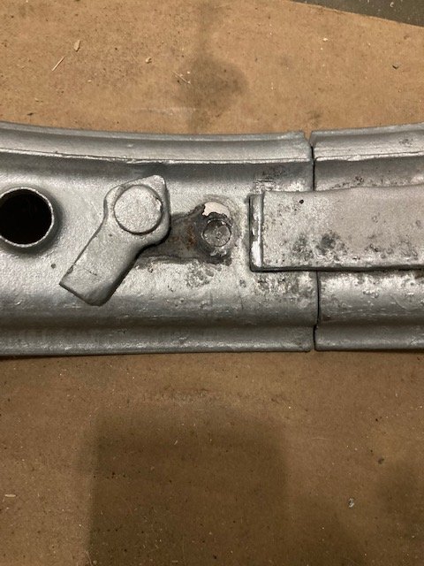

Problem 1 is my 21 inch rim lock is now broken off see picture. What should I do to fix this? Problem 2 is that all my 21 inch rims are galvanized and the rim locks are frozen in place and no longer turn. I might be able to file down the soft zinc and get them to turn again but suggestions are welcome.

Re-rivet it back together & they're split to accommodate tire installation & removal.

For the broken one it has been suggested to just weld the broken piece back on and not use the split rim feature. I've never had rims like this will that work when putting the tire on? Just use regular tire irons and horse it on like a 30 x 3.5 non-split?

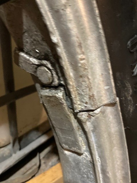

I just finished 2 hours of misery with a scissor jack and blocks of wood trying to get the lock and the ends to align. I had it ok with a slight mis-alignment but it was out of round enough so the wheel would not go in. Back to the drawing board which made it worse. Multiple broken screw driver tips and utter frustration. A spreader has to be a better than this.

pressure at just two points opposite one another will surely result in an egg shaped rim. The two half circles of timber mentioned in Johnny's post would help stop this. Note that the rim spreader pulls at 3 points, not just two.
From the looks of the rim joint the rim could have had some attention prior to the galvanising. The ends need a good 'tidy up' so that each side is at least the same shape. Just as all panels should be fitted before painting, so should the rims be worked on before plating. Too late for that now, but any replacements could be done this way.

As a safety precaution - I would NOT completely air up the tire on any split rim without it being secured to the wheel or cage - I've witnessed a rim lock failure during inflation !

So I have some good wheels now but I still have one rim with the broken rim lock. Is there a way to fix the broken lock?

Allen--You may be correct about a better idea except for on reason. The rim you are talking about is a Kelsey. Very popular in Canada. However you cannot use a Kelsey rim on a Ford/Hayes. The latch on the Kelsey will not go over and inside the Ford/Hayes wheel. Dick C.

Ignacio, So you are down to having to fix one more rim in order to have a rolling chassis with tires. The last rim has the broken rivit at latch in frist picture? Before you replace the rivit make sure the latch is flat. The picture shows that the edge of the latch has been bent down at the rim up turn, most likely from a prior owner's errant hammer blow. This is probably why you have had such a hard time with that latch. Make sure that the latch can turn on the new rivit and you should be ok. You have come a long way with your project and it is looking good, more T parts saved from scrap.

So the top of the lock pivot looks like it is 1/2 inch and where it goes through the rim it is 3/8 inch. It might be possible to drill something in the center of the stump in the rim and thread it in to act like a new pivot?

The part in the rim won't be thick enough to take many threads. You could weld a piece of round stock to broken part in rim and drill a hole in the latch for round stock to pass through. Keep as short as possable and drill a hole in round stock for a split pin to retain latch.
