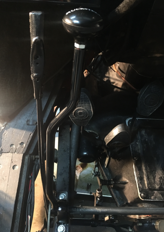

When I installed the Ruckstell in our '22 I did not want the shift lever in the center of the car. I made my own shift lever, out of steel round stock, and mounted it on the extreme left of the provided shaft, to the outside of the pillow block bearing. I bent the dog legs into the shaft, using an acetylene torch. I did this so the shifter lever would not interfere with my left leg when using the clutch pedal.
When installed in the car, it looks like this:

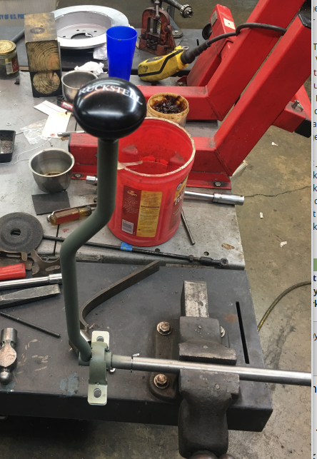

Hi, Harry -- I have used the one from Snyder's in 2 or 3 cars and like it a lot. (I don't know whether Lang's is the same or not.) Yes, it does replace the entire center mechanism. I made the rod to the rear end from electrical conduit in one piece, rather than using a 2-piece one. Once you get things situated, you'll need to weld the arm to the shaft so it can't move. It doesn't take much.
