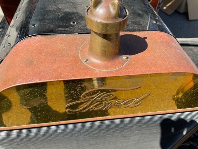

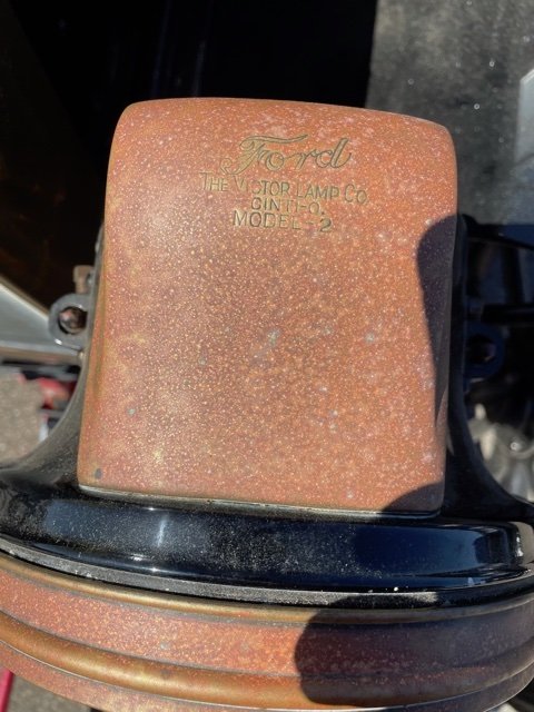

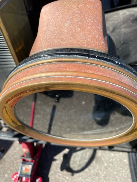

Hello,
I don't know much about brass parts on a Model T. I was wondering if these parts could be cleaned up and how to go about it.

Any idea what it's been exposed to ? Looks nasty as if some chemical fallout gas eroded the zinc from the brass alloy leaving copper. Antifreeze will do that. Usually the brass items will respond to a good brass polish. You could start there and see how it goes.

Bryan,
To easily get the hard crusty brown layer off, use a homemade paste of real lemon juice and baking soda. Mix it fairly thin more soupy than toothpaste. Be sure to remove this paste when you're done with clean water. Then brass polish and elbow grease.

Your radiator shell is solid brass. That brown layer might be an old damaged coating of lacquer that was applied to protect an old polish job. The fact that only the horizontal surface of the brass appears to be affected may be a indication that it was caused by the sun and the elements. If it is old lacquer it can be removed with lacquer thinner and polished with “Meguiar’s Ultimate rubbing compound”. If it is not deteriorated lacquer, the brown is most likely tarnish that can be still compounded off with “Meguiar’s Ultimate Compound”, which is what I prefer over metal polishes. Apply a dab to a folded cotton cloth like an old tee shirt and with two fingers, rub in a circular motion until the brown starts to disappear, revealing the brass underneath, then continue rubbing until you can clearly see yourself and the landscape behind you. The mirror shine you get from the rubbing Compound can be enhanced and refined with “Meguiar’s Ultimate Polish”, applied in the same way. “Meguiar’s Ultimate Paste Wax” will offer some degree of protection to the shine, without obscuring the shine like lacquer sometimes does. Jim Patrick

Oh....this is good information. I was concerned that the brass was permanently damaged or those parts just had a thin brass plating over steel and that was rust bubbling up from underneath. It sounds like the right chemicals and some elbow grease will make these look like new.

I am certain that you parts are solid brass, but it wouldn’t hurt to check them with a magnet. Jim Patrick

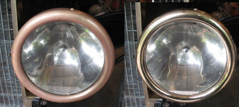

Bryon, I would be very careful about using all sorts of different chemicals maybe recommended by well wishers with good intent!
You have the perfect tarnish that can be very easily and quickly removed with a product I found after years of trying every store bought product possible. It's called Bright Boy metal polish.. I found it first at Smart and Final and then at the local janitorial supply place. You could also search it online. I like it best on exactly on the brass that you have now that has sit for a long time and developed a lot of tarnish. Although it will clean off the tarnish pretty easy it will not give that perfect deep gloss that we like to see. With clean shiney brass it's very easy to give it a second polish with a premium polish like Mothers Billet, Blue Magic or Prisim. These seem to be my favorites and they all leave a sort of film to help protect and prolong the deep gloss.
I advise you to make or purchase a some covers that will really extend the time between polishing. Don't let the brass get that bad before you touch it up again. I live on the coast so the damp salt air likes to see me polish more than desert areas!

I have to agree with the Bright Boy suggestion. I have even soaked brass that was black in it with great results. It removes the tarnish but is not a polish so you will have to polish everything once the Bright Boy has done the initial removal. I live on the East Coast of Florida and the brass really takes a beating here. It works!

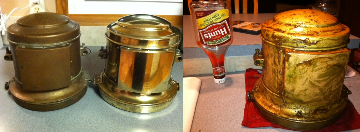

Get a bottle of Hines Ketchup....works great won't scratch....don't laugh until you try it....

Don't waste a penny on todays Brasso. When I was in the Navy many years ago it was Great not now.. You'll not find anything better than Brite Boy which is very much like the old Brasso,

Its important to distinguish products for cleaning badly tarnished brass (copper bleeding) from products that excel at polishing lightly tarnished brass. Having said that, efforts may also be hindered by some surface coating like lacquer, spray paint or wax. Also if the item is solid brass or plated.

I posted these two short videos. Catsup, a treatment I'd heard about, wasn't very useful. The poultice I tested, however, did a nice job of removing heavy oxidation. Followed up with buffing, the part polished up nicely.
