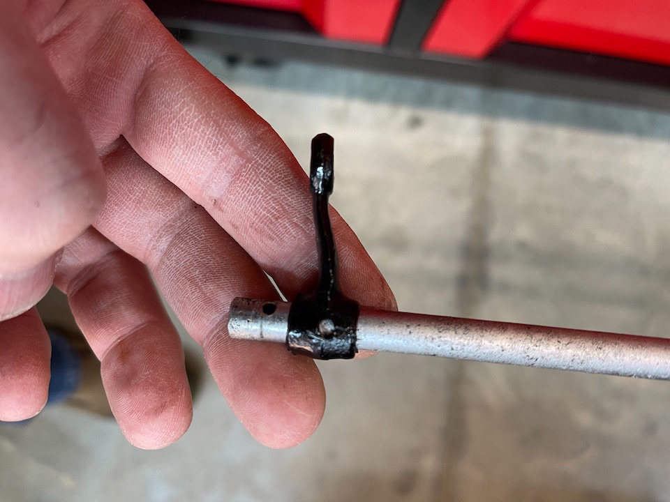

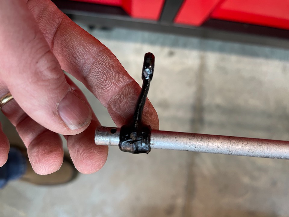

So I'm not sure if the person who put this together before had it on correct. Does the bend go up or down?
Like A
Or B
Like A
Or B
- Posts: 5594
Re: Does this spark rod lever go up or down?
First off - that appears to be the throttle lead - the spark lead is much shorter & it goes UP.

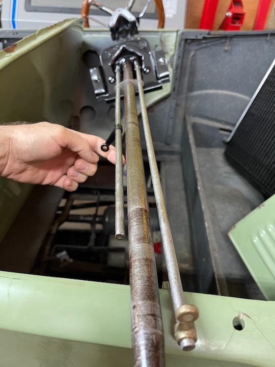

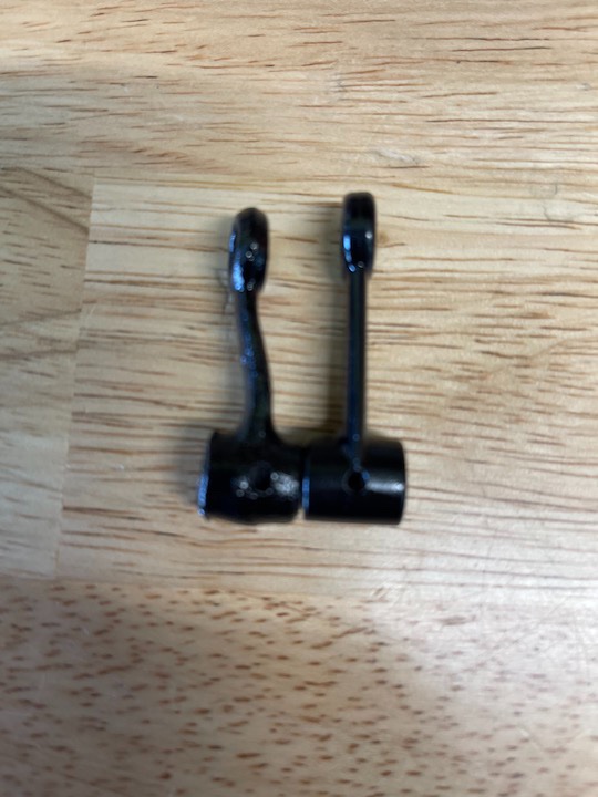

So I looked at the two levers. The one with the bend is shorter.
Now the next question. Should I have both spark and timer rods in the up position when I put the levers on and the rivets in?
- Posts: 7281
Robert, the throttle arm is twice as long as the spark arm. it is likely the ones you show are both variants of the throttle arm.

Thanks that's good to know. I'll order another one. Should I have both the spark and gas rods in the up position before I put them on?
- Posts: 5594
Yes, the correct spark lead is short ! With both the spark & throttle in the closed/up position, the spark lead will be pointed up & towards the commutator - the throttle lead will be pointing down & towards the carburetor.
