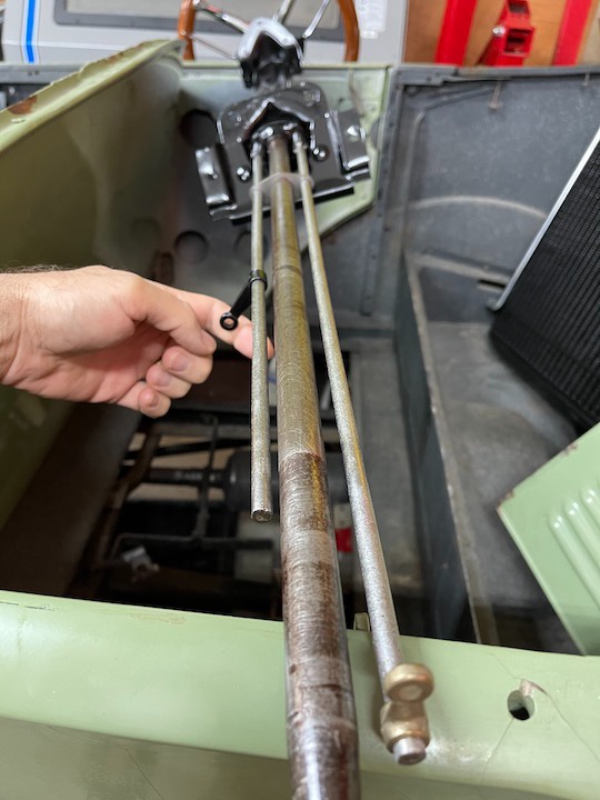

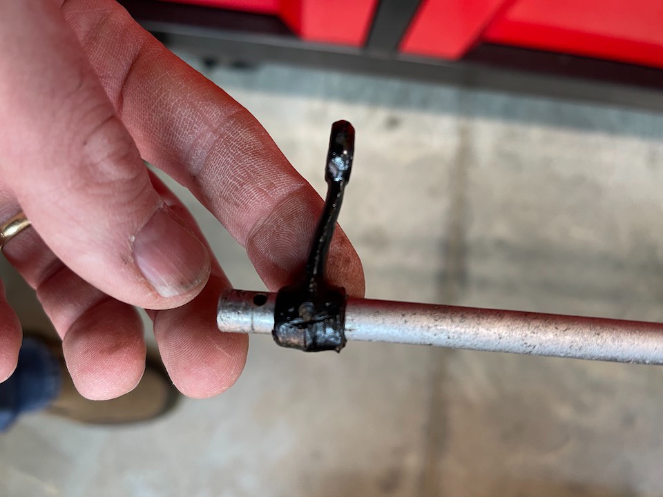

So I'm not sure if the person who put this together before had it on correct. Does the bend go up or down?
Like A
Or B
Posts: 5355
Re: Does this spark rod lever go up or down?
Post by RajoRacer » Sun Apr 04, 2021 11:26 am
First off - that appears to be the throttle lead - the spark lead is much shorter & it goes UP.
Post by Mopar_man » Sun Apr 04, 2021 12:17 pm
Thanks Steve. I'll go look at the throttle one that came ion the car. It is a reproduction one I think. I'll compare them.

So I looked at the two levers. The one with the bend is shorter.
Now the next question. Should I have both spark and timer rods in the up position when I put the levers on and the rivets in?

Robert, the throttle arm is twice as long as the spark arm. it is likely the ones you show are both variants of the throttle arm.

Thanks that's good to know. I'll order another one. Should I have both the spark and gas rods in the up position before I put them on?

Is this the one I should get. It looks small.
https://www.modeltford.com/item/3530.aspx
Posts: 5355
Post by RajoRacer » Sun Apr 04, 2021 9:34 pm
Yes, the correct spark lead is short ! With both the spark & throttle in the closed/up position, the spark lead will be pointed up & towards the commutator - the throttle lead will be pointing down & towards the carburetor.

OK so I think I got the position of the two arms. I just got the correct timer arm from Lang's.
In the photo both Rods are in the up position.

Post by RajoRacer » Mon Apr 12, 2021 3:58 pm
Looks good Robert ! For the other issue - throw that tapered key away - not a good band-aid ! Use the 1/4" x 1/4" new key - it SHOULD be tight in the pinion & the wheel center !
