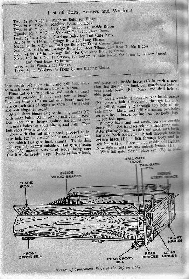

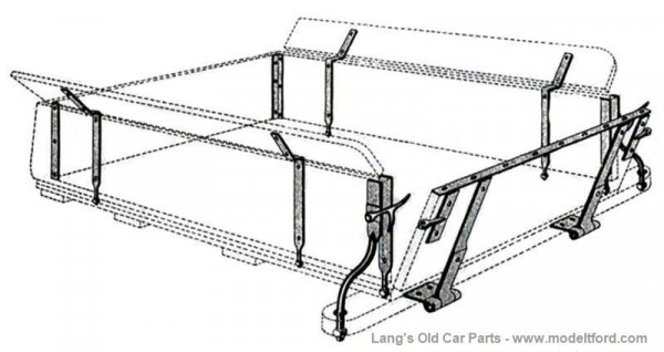

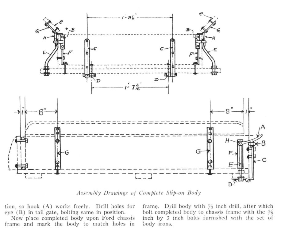

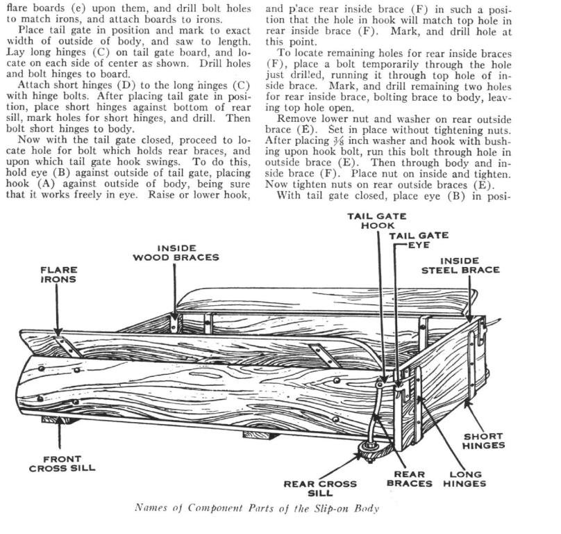

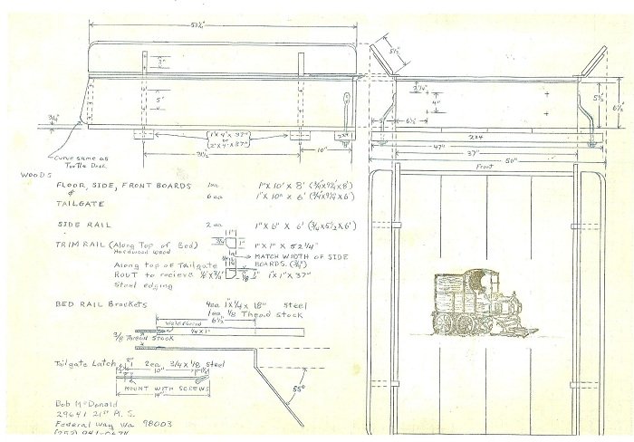

- Posts: 6609
Re: 1925 roadster pickup box mounting
This is all I have saved from previous discussionsThat Dumb Schmuck wrote: ↑Sun Apr 18, 2021 11:49 amI'm taking off the trunk and mounting the pickup box on my 1925 roadster. Does anyone have instructions, sketches, or images so I do it right?
