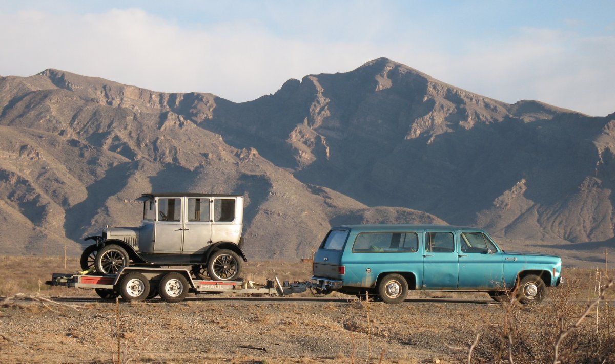

I hauled this Fordor facing back, as far forward as it would go. Had no trouble with tracking or control. Whether it faces forward or back, my 55 mph towing speed limit doesn't allow any wind damage. No law says I have to go fast.
Yup. It really just depends on your trailer. It wouldn't work on my small, single axle, trailer.

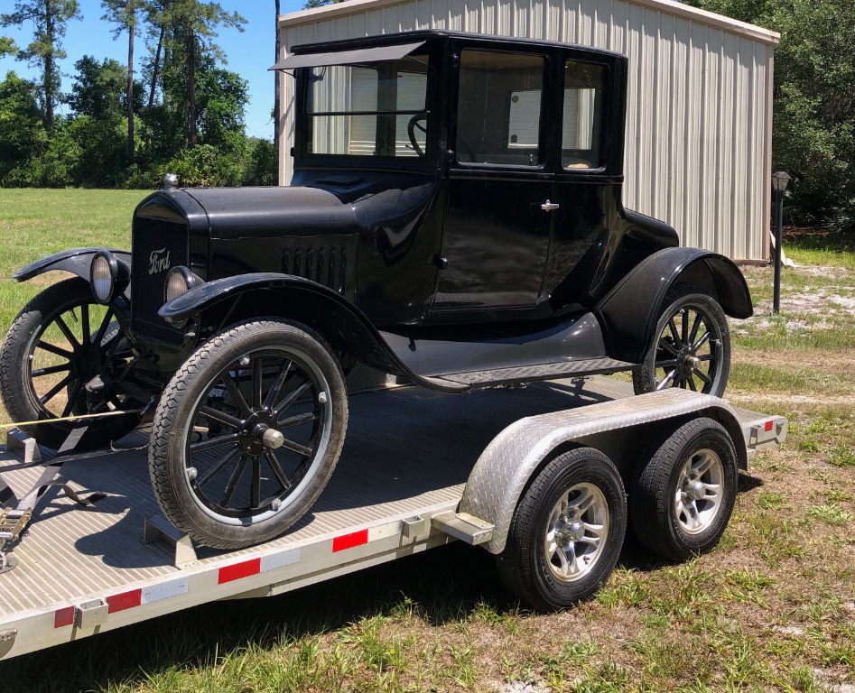

Tow the T's on the trailers face forward. Pulled this coupe that way, 65mph, no issues with the visor.
Perhaps if you pulled faster? But why. Don't want to overrun your lower speed-rated trailer tires :o

DanTreace wrote:
Tue Apr 20, 2021 1:00 pm
It's not about how fast you drive. It's about the headwind you're driving into. Especially gusts. Fifty MPH, into a 50 MPH headwind = 100 MPH.
The 26/27 visors are closed at the ends and can build up more air pressure underneath. Couple that with the fact that original visor frames most likely have some rust damage...
Don't get me wrong, I tow facing forward too. Just saying, it can happen.
