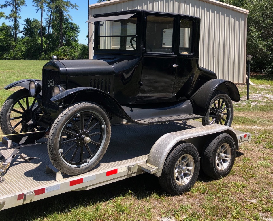

Tow the T's on the trailers face forward. Pulled this coupe that way, 65mph, no issues with the visor.
Perhaps if you pulled faster? But why. Don't want to overrun your lower speed-rated trailer tires
