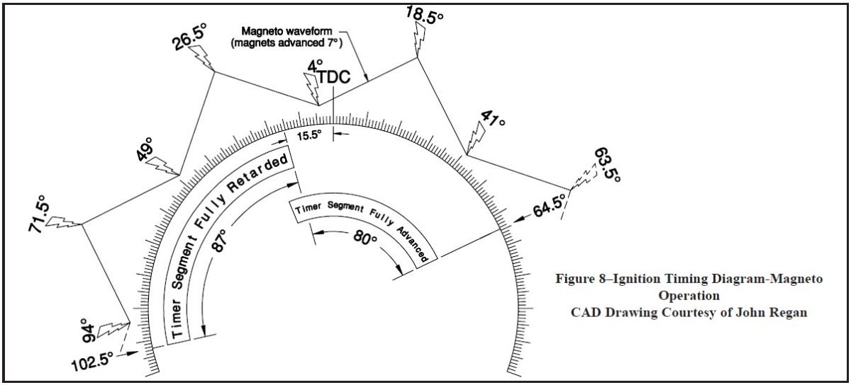

0.47mikroF = 0,000 000 47F so now the resonance frequency is 4000 Hz or 4kHz. Hm. And now that we are at it - after having slept on it, the 16 coils produce 8 cycles per revolution and not 16 (see below drawing), so the frequency of the output AC from the magneto is just 16kHz at 2000 rpms. The resonance frequency are reached at 500 rpms.
Ford Model T ignition - drawing curtesy John Regan.
So what can we use this information to? I have no idea, but I have wondered for long what the resonance frequency would be.

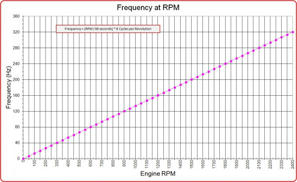

I believe you forgot to divide the frequency by 60 in order to convert from cpm to cps. At about 450 rpm the model t mag output is at 60 hz.
Art Mirtes

Post by BE_ZERO_BE » Sun May 16, 2021 6:22 pm
